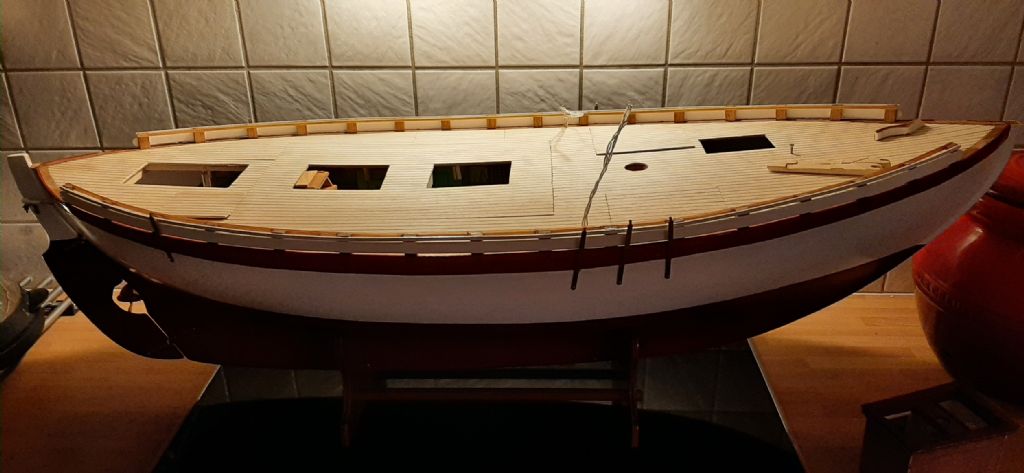

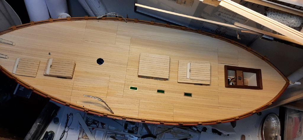

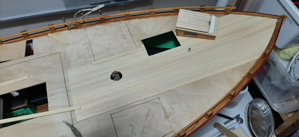

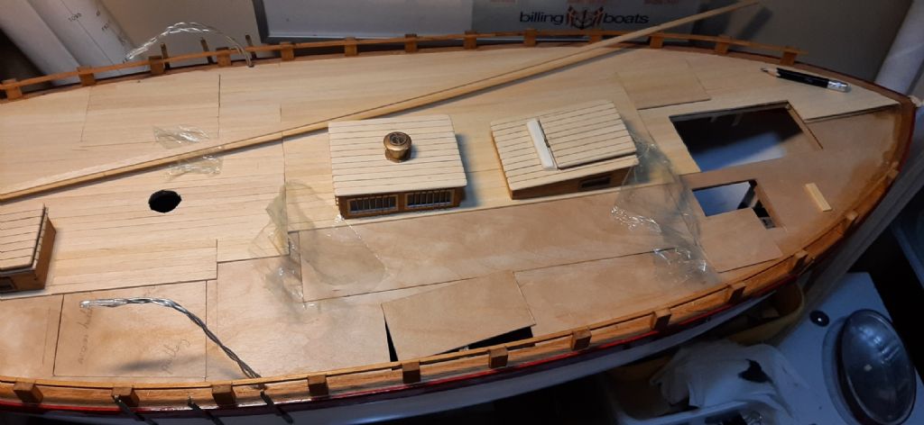

            20220319_071301.jpg20220319_071311.jpgStarted 'walking the plank' 3 days ago. Rather a lot of interuptions by more important family 'thingys'. The requirement for extra hatches requires planking around the hatches, then over them…preferably without glueing them to the surrounding deck!
            At this rate it'll be 2-3 weeks before it's all done.

              At least yours are straight George!
              It will be worth the effort.

                Yes, and in fact pure luck that the plank parallels the inboard hatch lines! Hope the others are also OK, did not think about that when marking and cutting out the hatches.
                I notice though that I have duplicated one of the photos instead of posting all 3 of the latest album photos. Can't win them all.

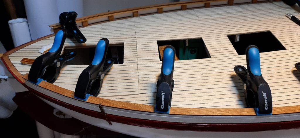

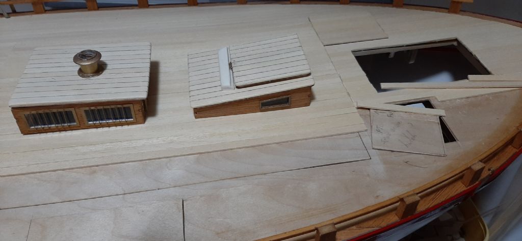

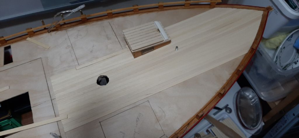

                    20220325_154445.jpgNow planking the port side! Had been going suspiciously well until I noticed I had started planking over the aft port servo hatch. Luckily only two planks glued, so I managed to prise them off before it was too late.
                    The shut lines where the deck planks touch the hatch planks leave a little to be desired, but I'll work on tidying them up when all the planks are done.

                      See that I didn't phrase the above info' particularily well… Of course, the servo access hatches are to be planked…the problem was that I had glued the plank to the deck fore and aft of the opening -as well as to the hatch! This made the hatch rather well battened down.sad

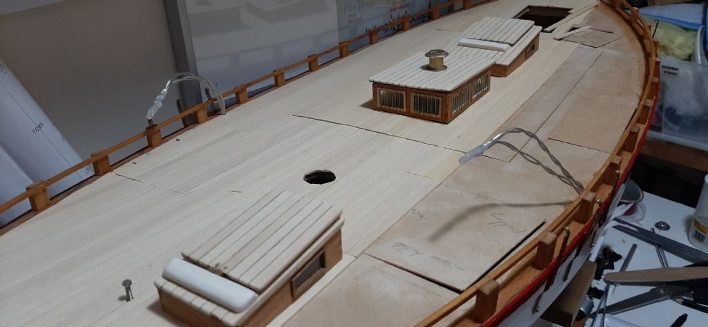

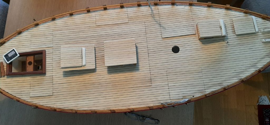

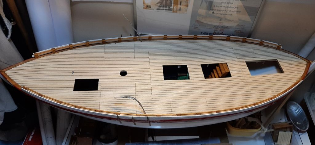

                            Well, the deck planking is finally in place. A few of fiddly thin wedges at the outboard extremes required some patience and more than one attempt to get them right.
                            The deck structures and steering well are just placed there for show. I'll have to get out the pencil sharpener and prepare for the 'caulking' proceedure. Grey cell is tired, so the rest of the afternoon will be with the Admiralty who has started talking about renewing the parquet flooring againsad. Had the same trouble last year when she saw rhe Fisher planking. Luckily prices have gone up considerably recently, so may be able to 'fend her off' with that arguement.

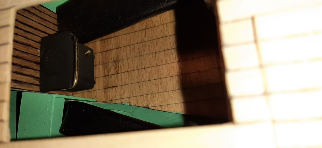

                                20220331_110454.jpgIncreased parquet prices and reduced availability has postponed the threat. wink 2 For the time being…
                                Meanwhile been 'caulking' between the deck planks. Not the best result but I could not face the thought of squeezing stained rigging thread between each plank from now until Xmas.

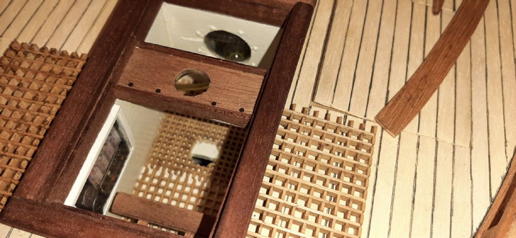

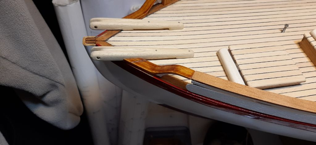

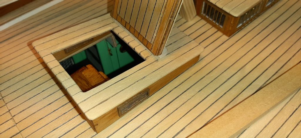

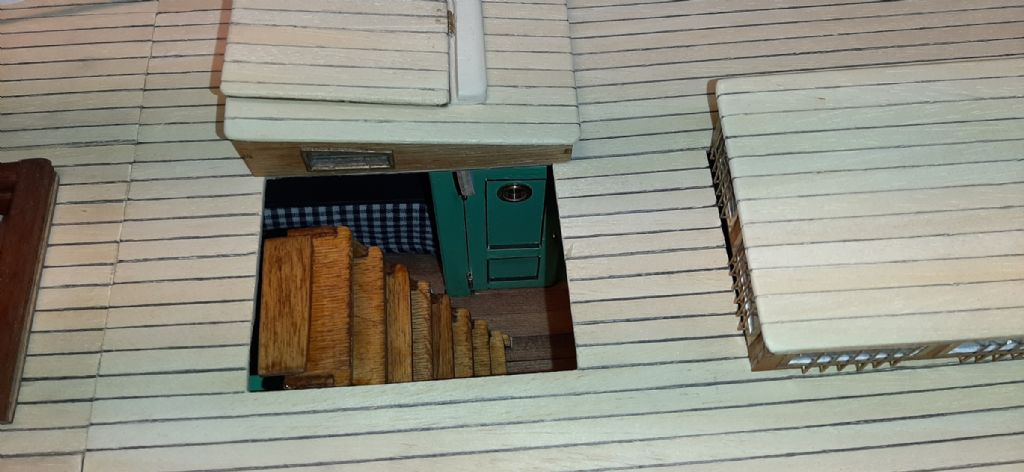

                                  20220403_152207.jpg20220403_152107.jpgFeeling a bit lazy this weekend. Installed the main companionway steps. They have to be removeable in order to access the motor cover so they are secured by two short brass pins into the cabin sole.
                                  The hatch hinges open to give a rather restricted view 'down the hatch'.
                                  Catheads have been shaped and faired ready to go on the foredeck later.

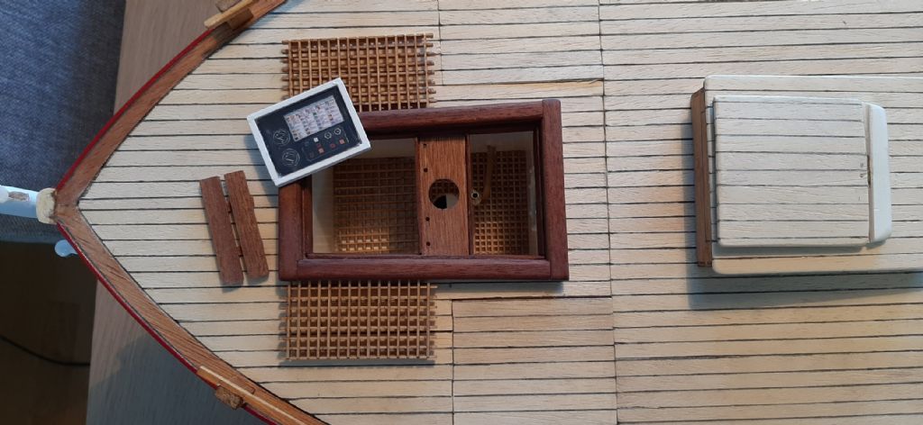

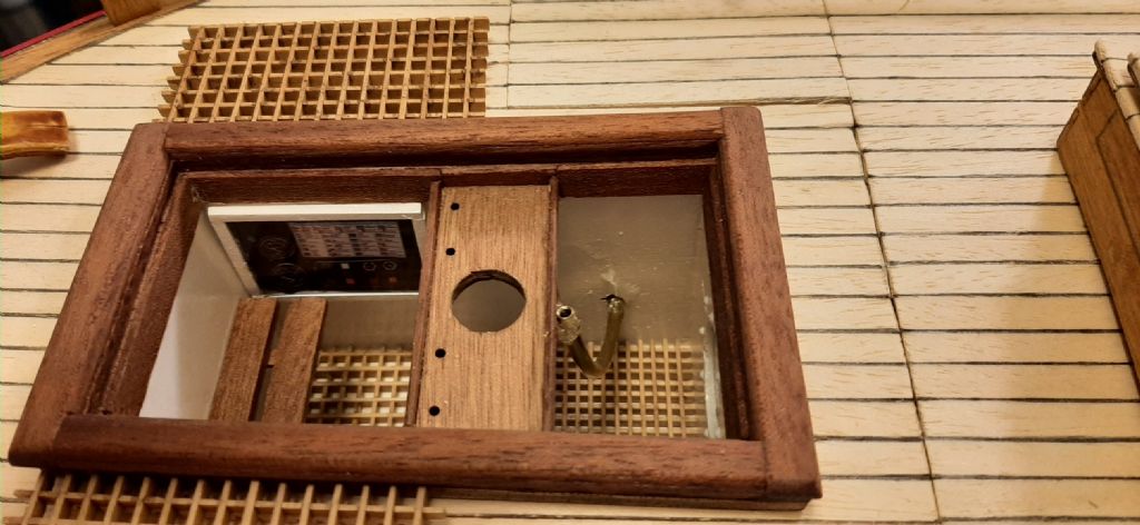

                                                Engine control panel and helmsmans seat installed in the steering well. 20220408_072034.jpg
                                                The steering compass is yet another almost-invisible photo-feature. Can see it a bit better by naked eye though.

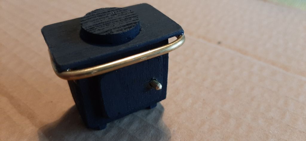

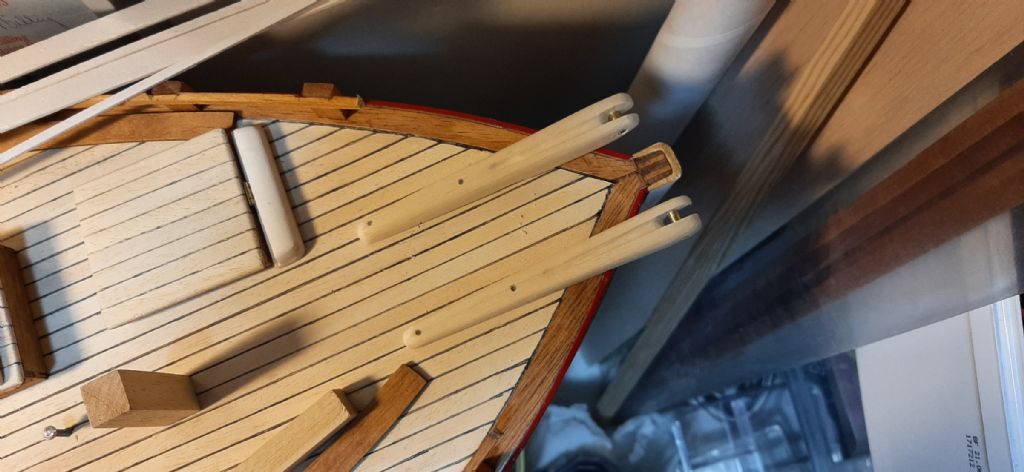

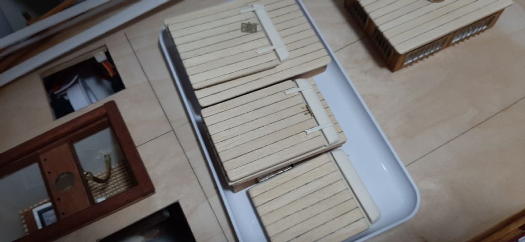

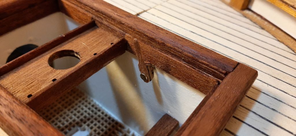

                                                    20220411_114704.jpg20220413_151451.jpg20220414_094801.jpgPausing between Easter eggs to publish a build update.
                                                    Capping rails are in place, catheads shaped, wood-burning stove produced and lowered into the fwd cabin. A throttle lever has been fitted to the cockpit coaming.
                                                    Atmosheric pressure (and temp) is rising slowly so hope to oil some deck structures and planks soon. Hope the biro deck 'caulking' survives the oil treatment better than the HB pencil lines!
