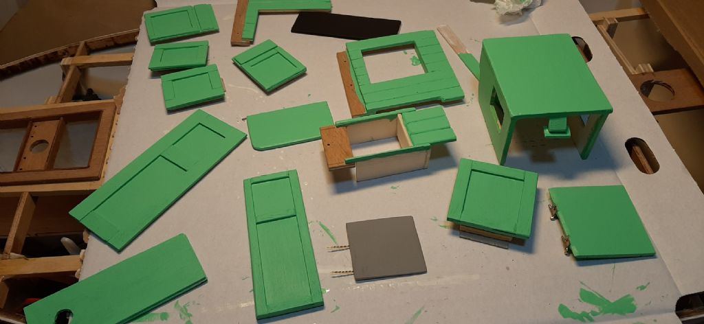

      20210730_153406.jpgSome interior parts have received a coat of green. Very, very Green, but it's the correct colour according to the Colin Archer museum. George20210730_153455.jpg

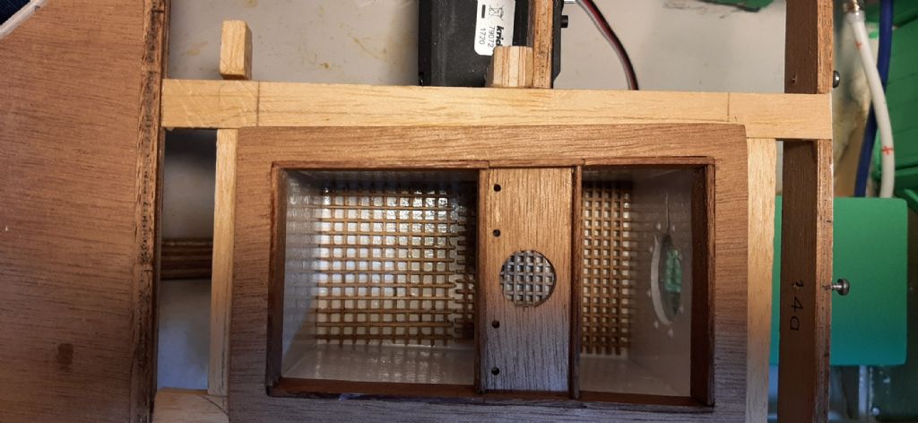

                The cockpit well is also in production and -in addition to the grating- has received a glazed porthole and raised top edges to help keep the waves out. The kit/plans only show a 4mm top edge/rim. Now it's about 10mm.

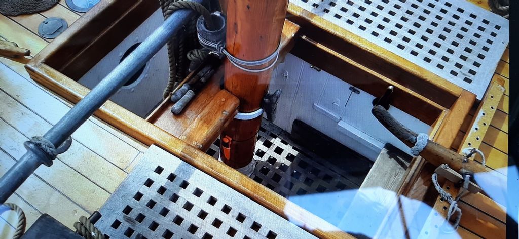

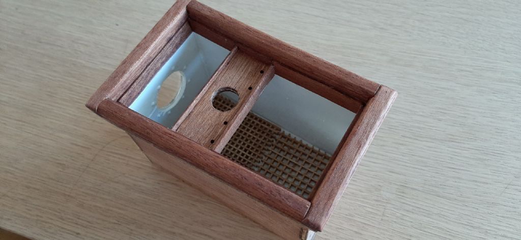

                  The wood for the cockpit well included in my particular (old) kit is mahogany coloured. I therefore used some mahogany stripwood left over from the Fisher build to build up the edges to look more like the original, AND give better protection against filling the cockpit with water!
                  The edges are increased from 4mm high to nearer 10mm. This might interfere with the tiller where it passes over the aft edge of the cockpit well, but that will be easy to remedy.
                  I have a photo of the original, but this was found on the web and is not in JPG format, so I can't 'beam it up'.
                  George
                  PS. Just remembered….took a photo of the PC screen to get a JPG format photo. So here is the original cockpit too.20210804_100445.jpg

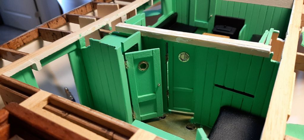

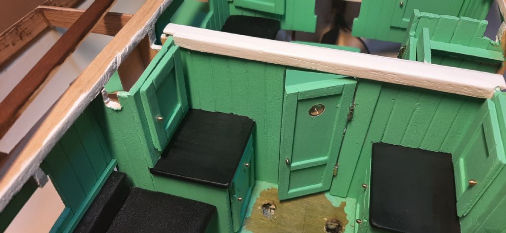

                    Did some test fitting of interior components today. Nav station installed, simulating the unit in the present museum CA. The original photo comes up sideways no matter how much I rotate it on th PC. Had to take a photo of the PC screen instead.20210805_222934.jpg
                    The heads door is a bit kinky with the porthole feature. It is however glazed in frosted green. Door frame still to be edged to make it less draughty! Some paint damage occured while re-positioning (hacking with a knife and saw) the heads unit.

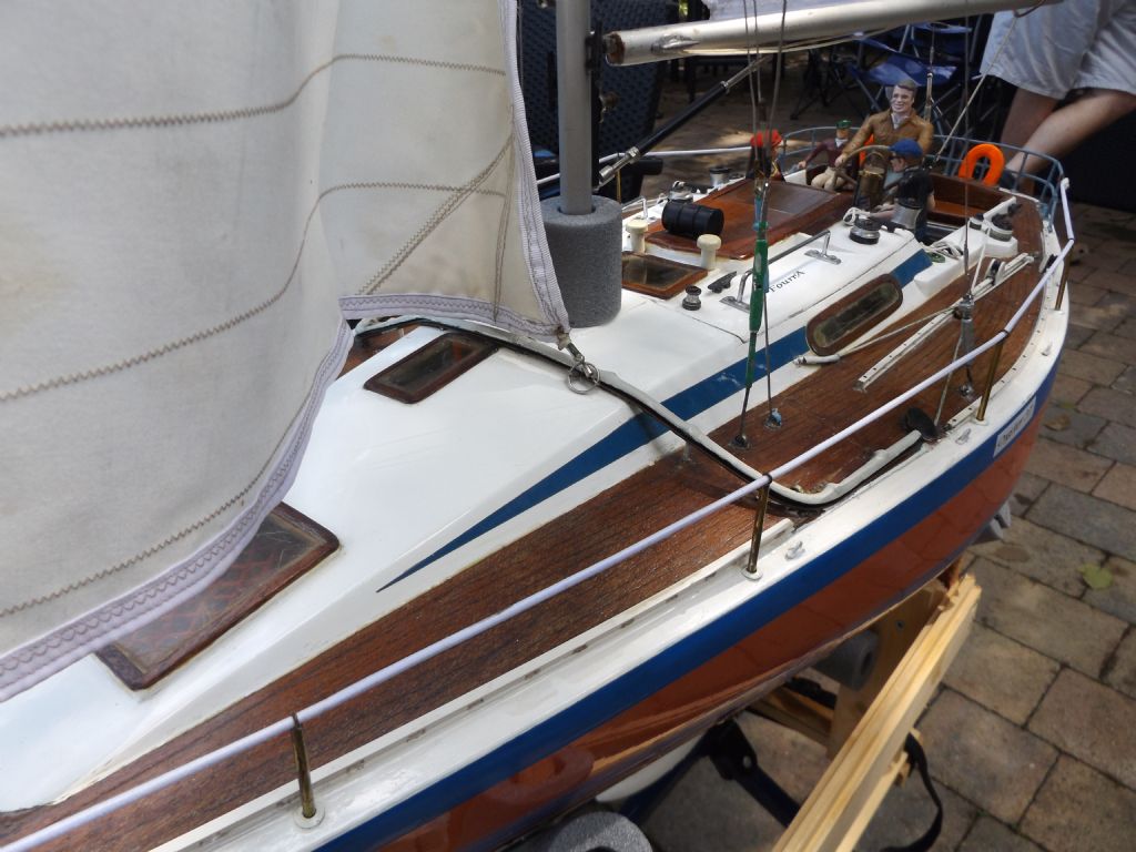

                                Not a Colin Archer issue, but many moons ago we were discussing the control of the Genoa sheeting on the Fisher, well I have seen a track system used on a yacht at a meeting I went too on Wednesday in Surreysilver 3.jpg, using a split tube and winch controlled line and traveller seemed brilliant idea to me
                                Sorry I forgot to ask the gentleman's name !!

                                  Hi Ray, looks like a smart way to do it! I have in fact seen a large flush-deck yacht on Youtube with a similar system. This seemed very smooth in operation. I think I googled "model yacht genoa operation" or something of that nature.
                                  Main advantage is, you only need ONE servo to to do it! Disadvantage is, that you cannot let out the sail clew to fly loose for sailing downwind. The clew follows, and is allways the same distance from the track. With two separately controlled servos, you can let them both out for downwing sailing.
                                  However, to use the track system on the Fisher, would not look very 'scale' as it would entail routing the track quite far forward to get around the mast, then across the top of coachroof (which needs to be removeable to get at the swithches/fuses).
                                  The track would also have to be routed outboard and well aft of the mainmast shrouds too….ugly.
                                  My system looks reasonably scale I think -and it even snags slighlty (as in real life!). Although the tracks and sheet blocks are rather larger-than-life in size.
                                  You will remember in our discussions on this -ages ago- I mentioned that my grey cell was under considerable duresscrying 2 trying to work out a suitable system laugh.
                                  Thanks though, for the info. The photo shows that for the right type of model, it's not that difficult to achieve some sort of positive genoa control.

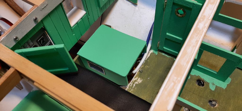

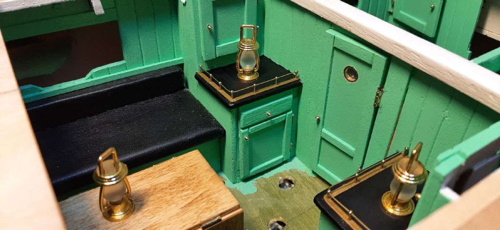

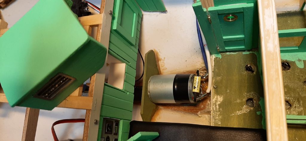

                                        20210811_172853.jpgBrass knobs appearing here and there. Paintwork looks a bit tatty-weathered in the close-ups I'm afraid. However the boat was built in 1893! Had to make a hole in a bulkhead to get at the screws for the hinge on the heads door! I'll hang a photo over the plug.
                                        It'll all look good enough when I'm finished.

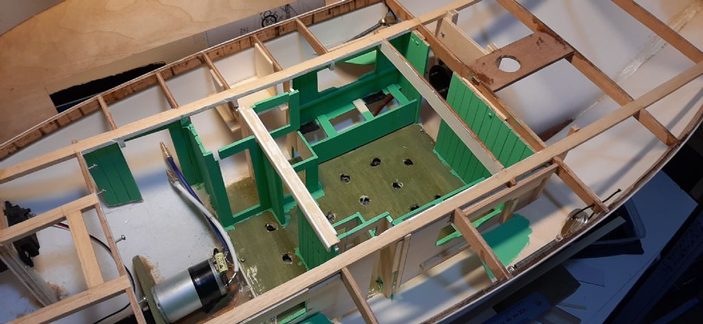

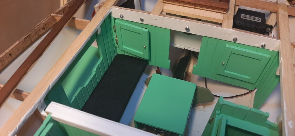

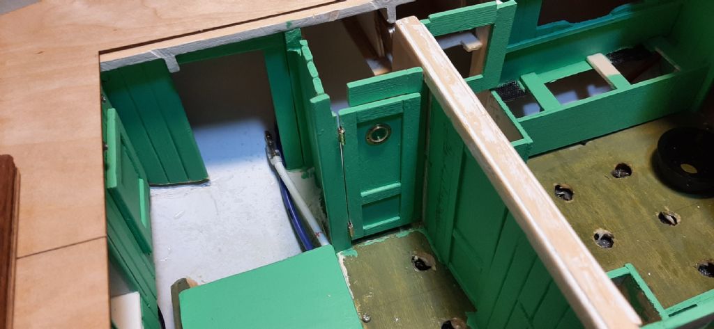

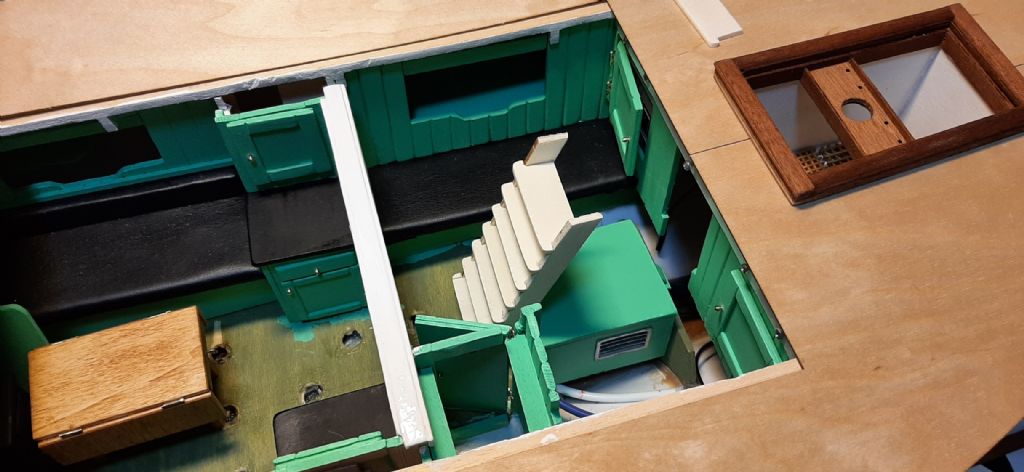

                                          20210812_202035.jpg20210816_122424.jpgMore interior details added. Some (non-working) hinges applied to lockers and doors. Brass rails on locker tops. Richard's tip about Doll's house furniture produced not just hinges…I could not resist the brass parafin storm lamps. Bought 3! One of them will probably be modified a bit and suspended from a cross beam.
                                          Made an attempt at the companionway steps. It looks like it's dangerously placed in mid air, but that's where the companionway opening will be when the deck is in place…I hope.
                                          Still waitng for compass and some other bits from CMB. Hope they don't get lost in the post again.20210816_122412.jpg

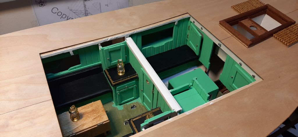

                                            Hi George,
                                            Had you thought of a perspex deck to show off your detailed interior ?? Seems a shame to have it all shut off from view ?
                                            #97510
                                            gecon
                                              @gecon
                                              I don't think the 'rivet counters' would accept that Ray. I'd be getting hate-mail for sure.angry The plastic hull is bad enough. A see-through deck would get me excluded, BUT I plan to open the deck below the skylight and I'll hinge the companionway hatch. Though there still won't be much view of the interior.
                                              I do have another Colin archer kit in the cellar store. If I ever start building it, I definately will not try another interior. It's driving me nuts.face 14

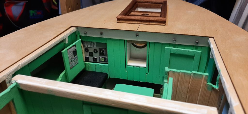

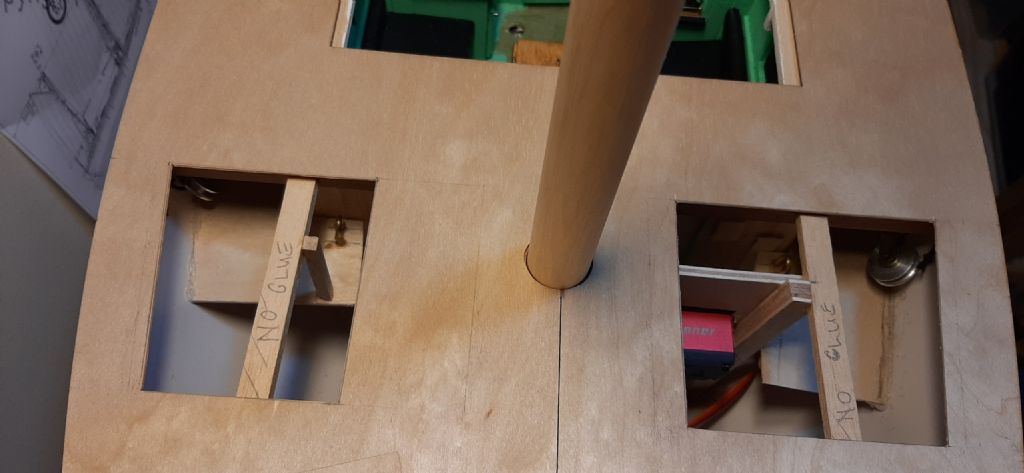

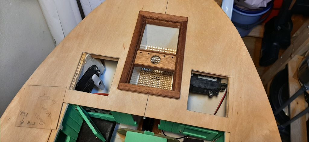

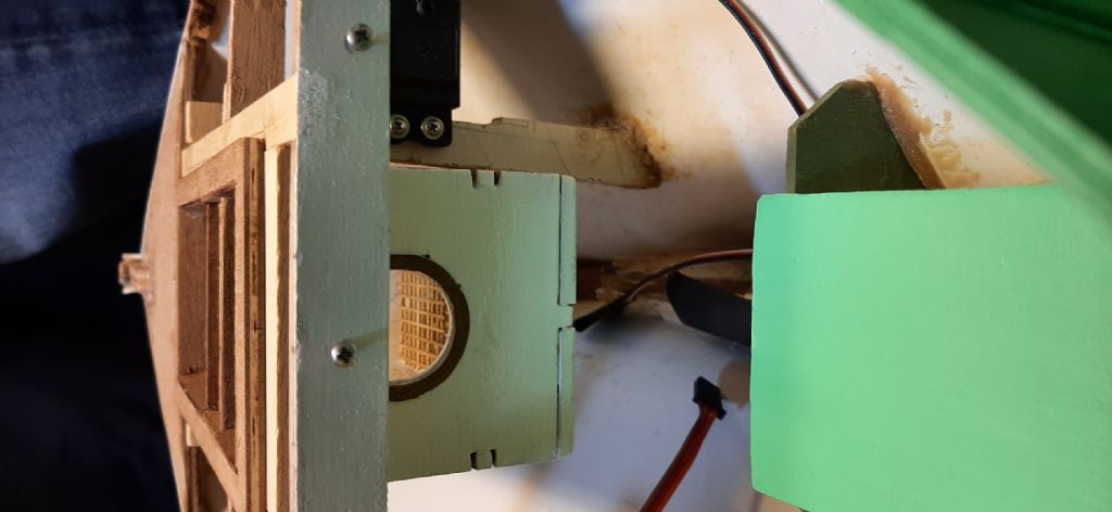

                                                20210817_152846.jpgHatching-out (sorry) more ideas. Through-deck access to R/C gear. 20210817_152910.jpg

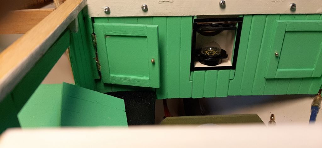

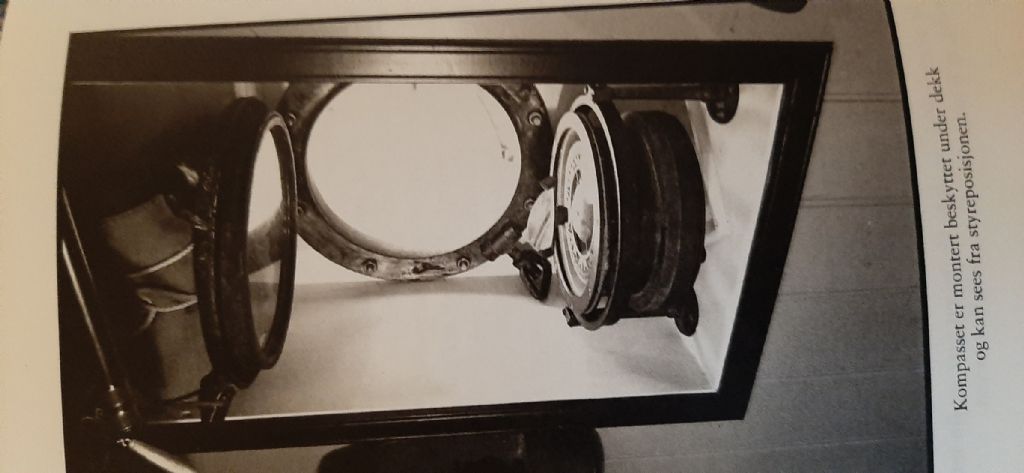

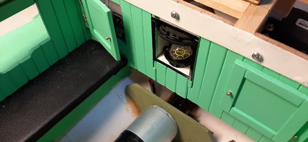

                                                  20210819_152527.jpgWell, the second attempt to send me a compass was successful. Took only 8 days in the post, which is the shortest UK-Norway time since I started ordering from CMB in 2019.
                                                  Fitted the compass in it's 'pigeonhole'. The porthole surround which I made two weeks ago is a bit on the large side I think, so something might well 'happen' to that before launch. The whole compass thing was just an afterthought which ended up being a main event 20210819_152504.jpgwhich -as Ray gently hints- will hardly ever be seen!
                                                  Post a photo of the original too. oh, oh, I have to take a photo of the PC screen first. Can't turn it the right way here, sorry.
