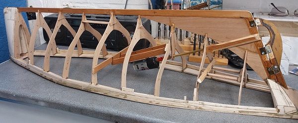

          Just started to plank some of the stern section. The rudder servo bearers are in and I've fitted a temporary rudder to work out the control runs etc.
          I'll post some pic's when things are a little more advanced….

                          Rudder now drilled to take a 'see-through' extension if needed.
                          A quick planking query : – some planks are not 100% abutted to the one below /above. The gaps are just a few thou' but probably enough to let water in…..
                          Gap filling ideas I have are :- P38 (or, similar), balsa sawdust and glue perhaps ? Other ? I'm currently working on the inner skin in balsa strip as it nicely follows the curve of the frames without steaming.
                          Probably not going to glass, but most likely an outer skin of obechi, lime or similar (I'll try a few test pieces first). The idea being for a 'natural' wood finish to show through. I'm open to all ideas though at this stage.
                          Cheers,

                            The important thing is to fill the gaps with something which is not harder than the adjoining planks otherwise you can get high spots when sanding.
                            P38 is OK but I prefer Ronseal High Performance Wood Filler as it is a bit softer and specifically designed for wood. It also comes in white or light wood colour.

                                As my winter oil painting sessions now draw to a close, I have managed to sneak out into the workshop for a bit more planking at the stern.
                                The motor (DC brushed) is trial mounted and the rudder is jury-rigged to check clearances etc. around the prop'.
                                Planking is quite satisfying, but, time consuming as each 'plank' has to be cut from balsa stock…..noggins often have to be inserted here and there as the 3mm frames need extra support. Scarf joints are also needed due to hull length v. standard stock sizes……nobody ever said it would be easy ! Lots of learning on the job taking place as I go along – all part of the fun.
                                Photos soon,

                                    Planking proceeds at a snail's pace now that the workshop has warmed up a bit. I'll have to think about the mounting for the sail winch soon. Also thinking about taller plank sections to ease my burden a bit ! (Currently 6mm pitch).

                                      I have now switched to 10mm tall planks (from the original 6mm) – hence planking has now doubled in progress ! These look fine where the radii of the frames are largest. However, for the tighter curves I think I may well revert to the 6mm planks…also, at bow and particularly stern sections, the 6's will be better suited to tapering and blending to form.
                                      Before planking gets too advanced, I have to have in mind a couple of design items – ie the hull lower mast step plus the sail servo mount and sheet runs. The thinking at present is to have the two jibs and the two mains controlled by the same servo – I think this was Ray's suggestion and is sound thinking. I can't really see any need to go 'goose-winged' so probably best to keep things simple. I can always introduce a second sail servo at a later stage if necessary.
                                      Photos to follow when things are a little more advanced,
