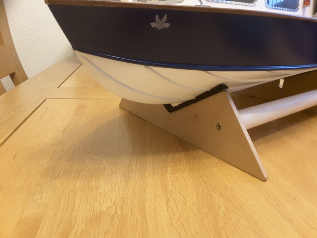

      When I made stands for 5 of my boats I bought some self-adhesive black foam which was just the job as it was pliant enough to accommodate the strakes. Whilst I was at it I decided to replace the felt on the Huntress stand as it was a bit thin and green!

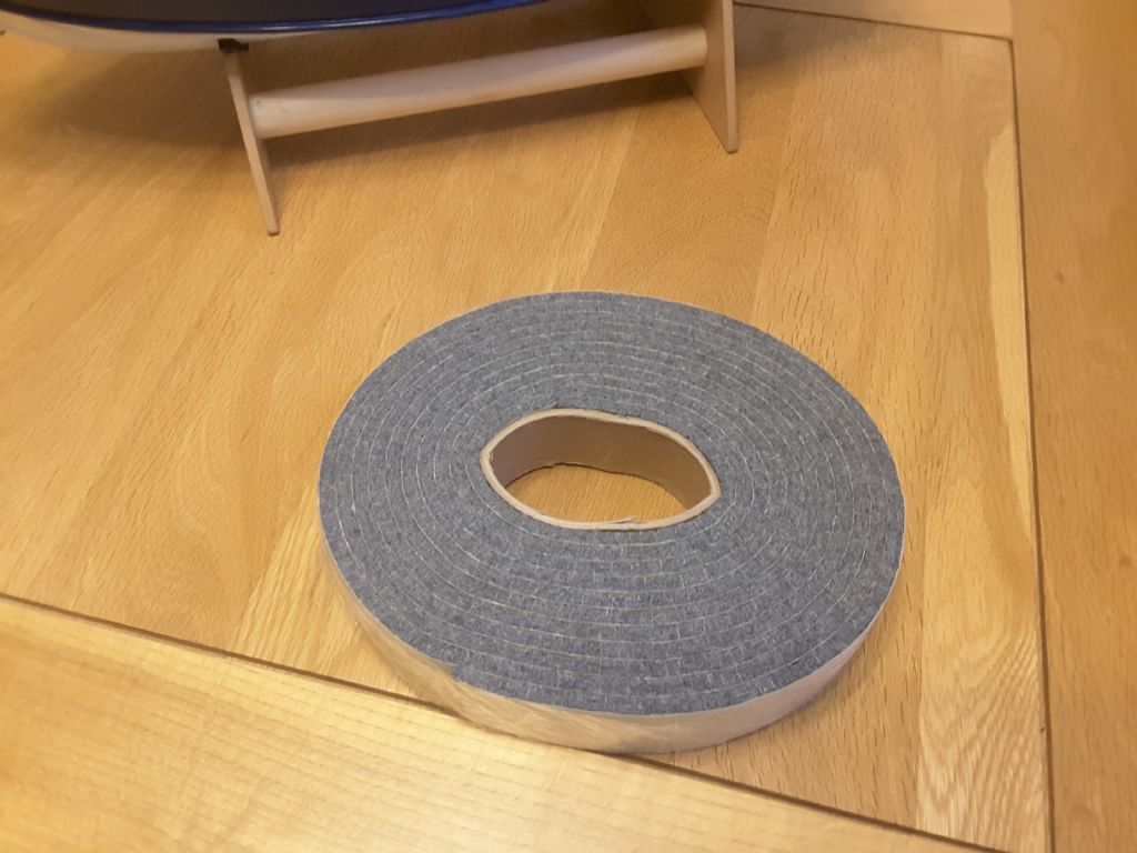

      I've bought a 5m roll of self-adhesive grey felt, 40mm wide which I shall cut down to the width required.

              These days I use film covered draught proofing tape.It is a self adhesive foam but taced with a thin transparent covering which looks like cellophane so the hull is not in direct contact with the tape.

                I have used Wilkos draught excluder tape on the last few stands I have made. No problem so far. Before that I have used felt glued to the stand

                  I shall use the felt but check it on a regular basis. I'm assuming it should be Ok as felt was the go to material for objects standing on varnished and painted surfaces and is still often used?
