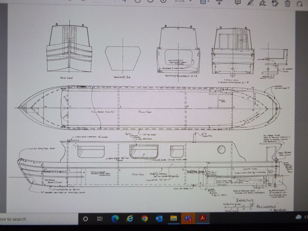

                      invictus of allington sept 15 001.jpginvictus of allington sept 15 002.jpgHello George,
                      This is Invictus of Allington one of my designs for a 30ft narrow boat measured from the real thing, published in Model Boats back in August 2016, it's 3/4" to the foot and comes out at 24" long. It needed 1.5lbs of steel plate as ballast with 7.2 volt nmh buggy battery and 400 size motor with 25mm 3 blade prop went fine, they are easily driven and blow all over the place in any sort of breeze on the lake
                      Can be made any length you like just add a longer centre section for a 60 footer bow & stern the same.
