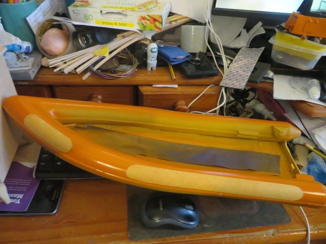

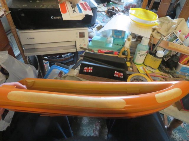

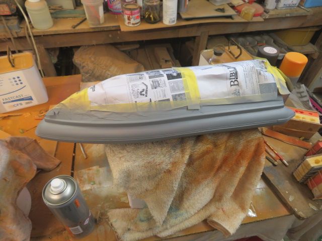

        Unfortunately I cannot find my Frog maskng tape and so, am forced to wait untl tomorrow to mask off the orange before I paint the grey of the sponsons.
        I use frog tape becaise it has perfect edges which dont allow any "bleeding" underneath the tape as it gives a perfect edge…….and is much cheaper per length in roll to Tamya tape.
        i shall be out early tomorrow to buy some.
        #99792

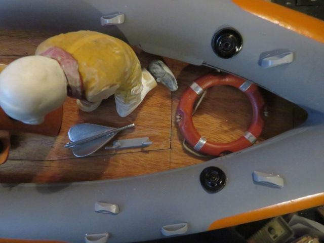

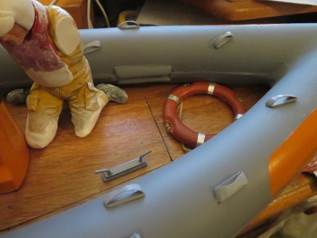

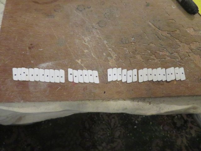

          Have had to send off through Amazon for some masking tape that I like to use, as no one in the Fylde area had any Frog tape…….it will be with me tomorrow.

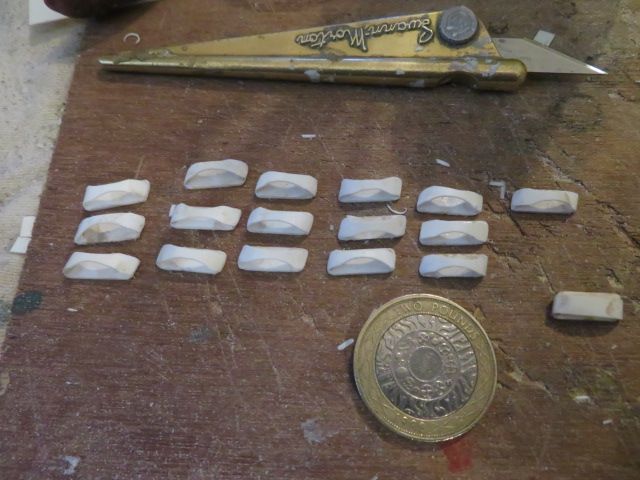

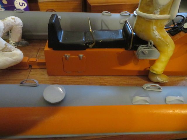

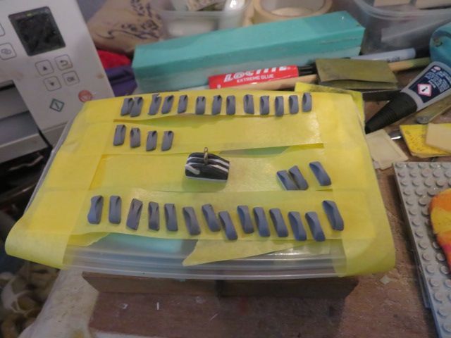

          So in the mean time I made the grab handles for the sponsons, using 0.50mm plastic card.
          Made a few extra just in case of breakages, lol

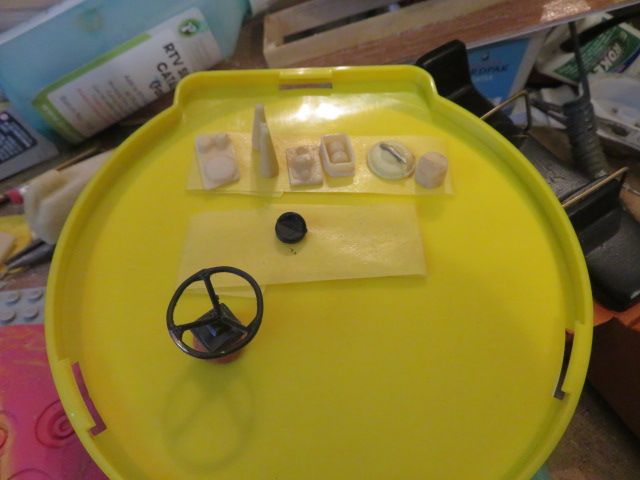

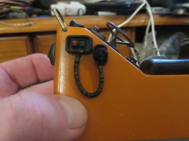

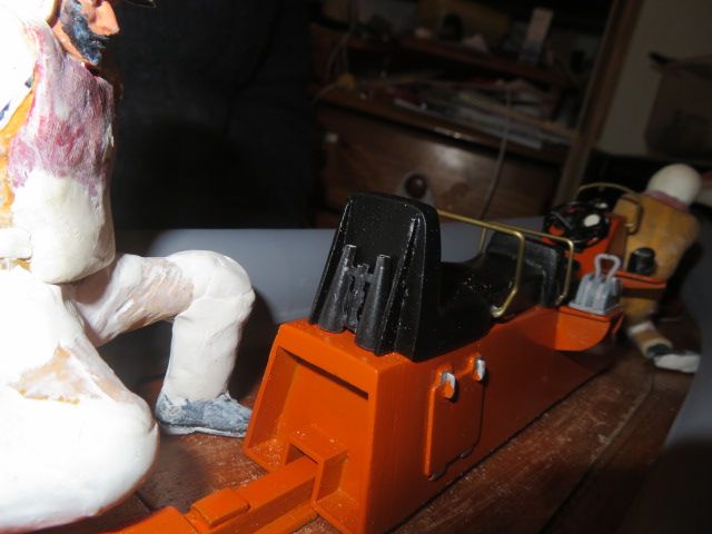

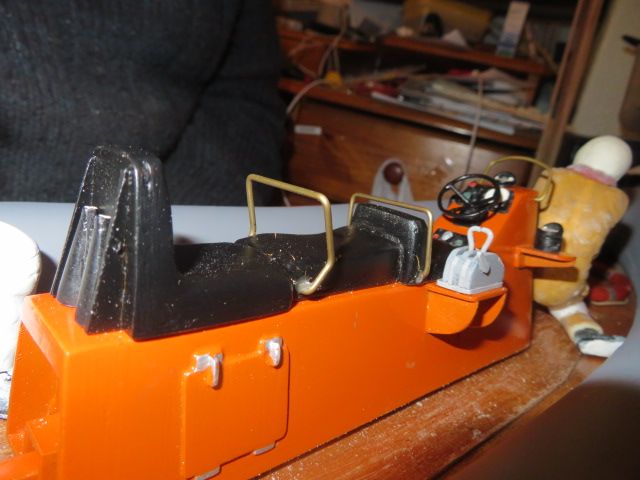

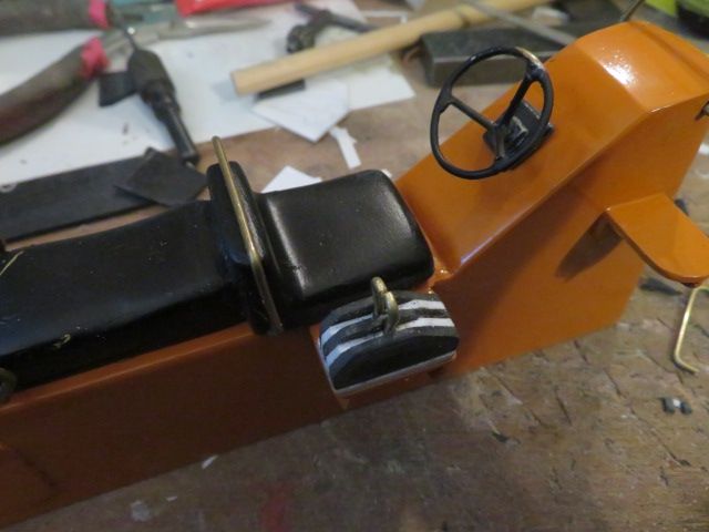

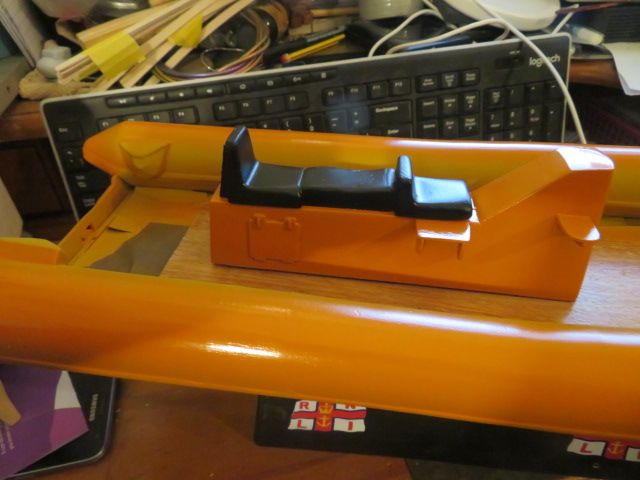

                and a little more of the small detailng parts added to the seating pod……..those little bits will be brush painted with Humbrol enamel.

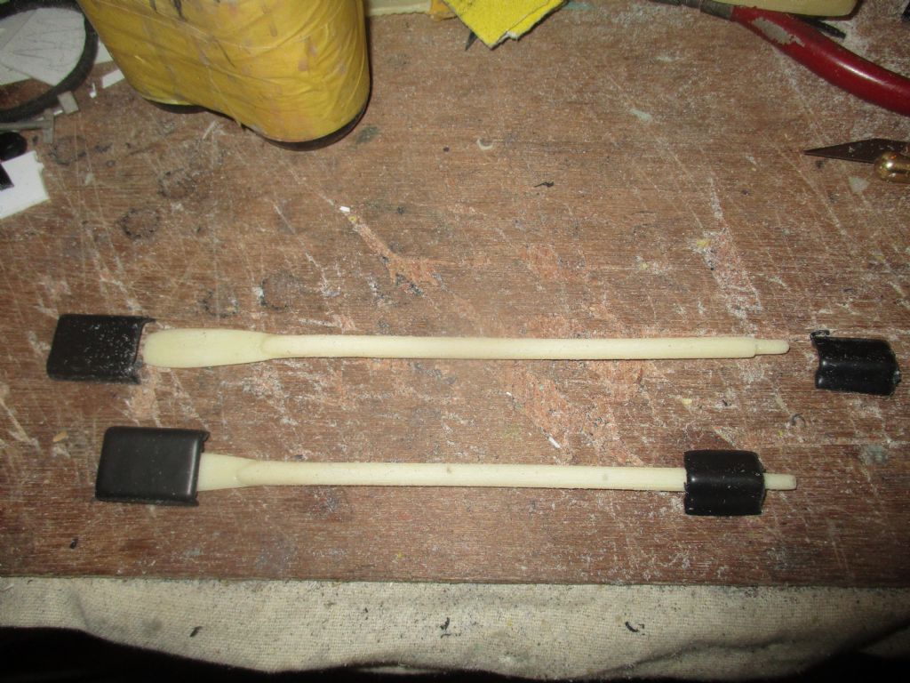

                they are the crew safety grab bars, the boats wheel and the motor morse repeating throttles……..remember one of those from my days as a narrow boat owner…….used to sail a Caldercraft Clyde puffer from my narrow noat on a nice hot evening………..those were the days lol.

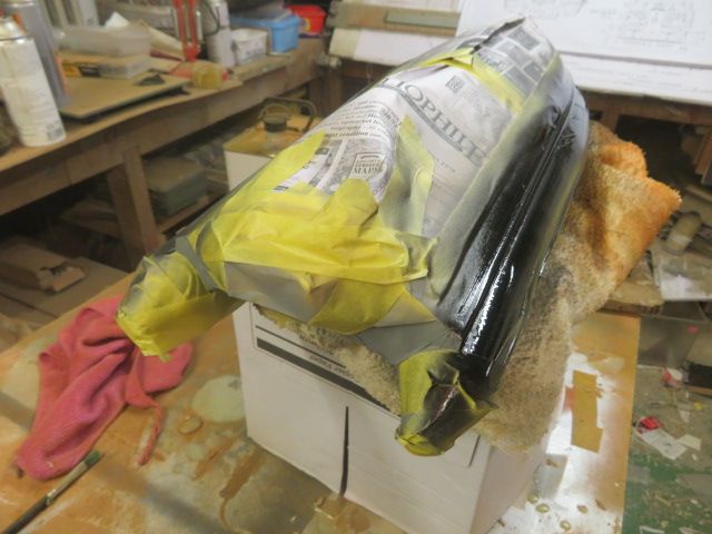

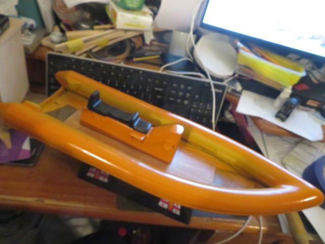

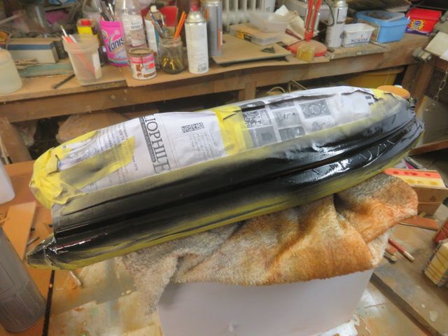

                  my frog tape aived this lunch time so!!!

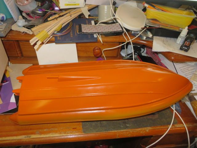

                  Underneath all paper masking tape and black spray, there is , hopefully an Atlantic 21 rib that has been sprayed with Halfords rattle cans in orange, grey and black.
                  i said hopefully and will know in an hour .

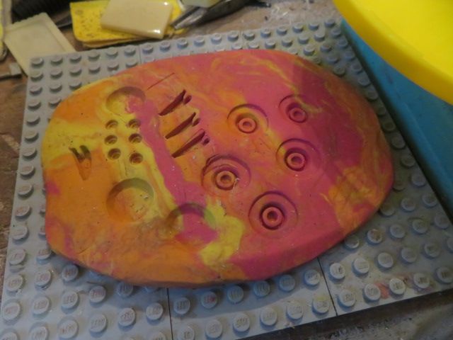

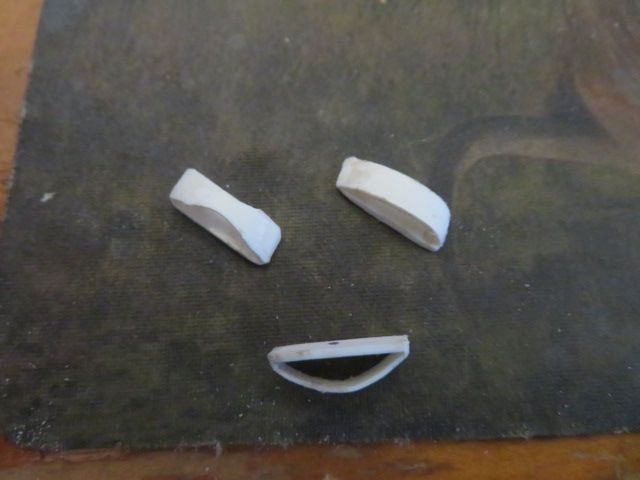

                  the rest of the parts that i have made so far are waiting to be sprayed, and the wodge of plasticine sat on top of some Lego plating is a one off use mould for other parts that fit to the boat, that i shall cast in resin tomorrow, cant be bothered doing it tonight……a better start fresh in the morrow.

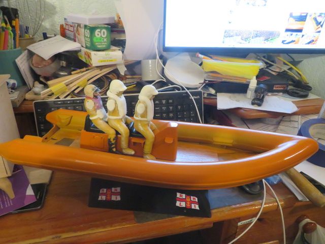

                  #99812

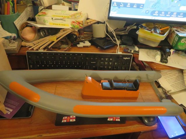

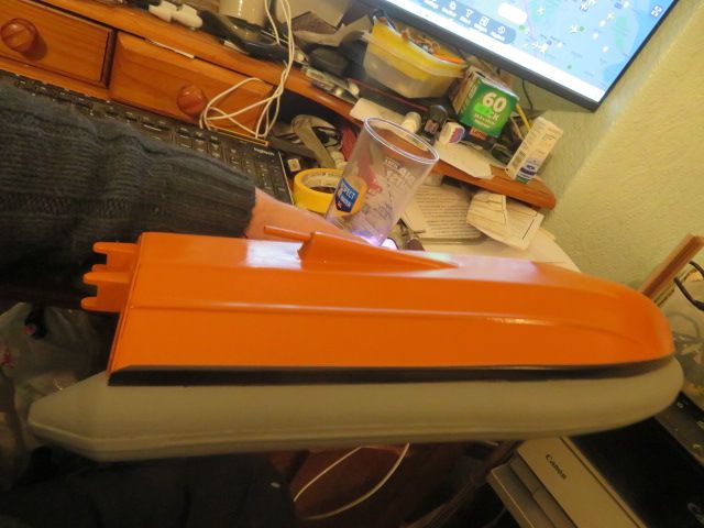

                    well!!
                    Mr Dave Stavros Jones, as my mentor?
                    not bad for a novice aprentice……what do you think

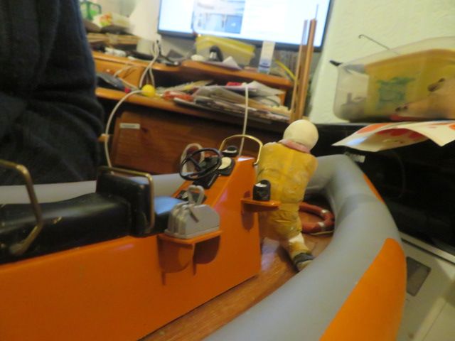

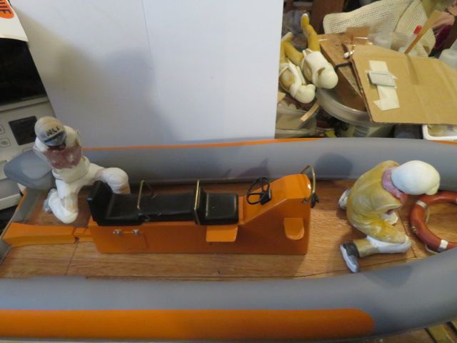

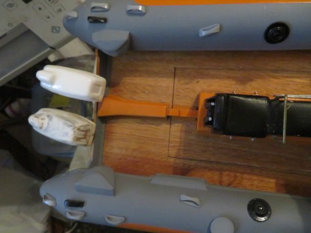

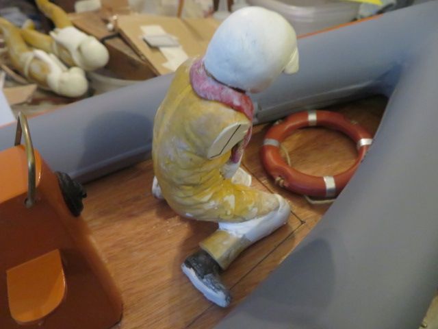

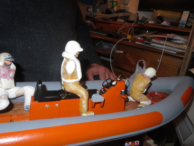

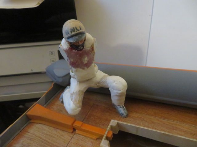

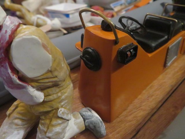

                      did a bit of reworking of two old figures that i had in stock and made 20 odd years ago!
                      the one sitting aft wouldnt sit on the rear seat with the other two that were supplied with the original kit and the one at the bow in the pictures wouldn't fit anywhere!
                      And so i decided to give them the chop……i cut both legs off each and repositioned them so that one is kneeling and the other "genuflecting" at the stern.
                      i will mould them and probably eventually put them on sale with my other figures and also modify them to sit on the more modern ribs in more modern attire, but for now, just for the early prototype Atlantic 21 B-1.
                      I really do enjoy fiddling with such little details. hopefully they will be in silicon rubber split moulds next week.

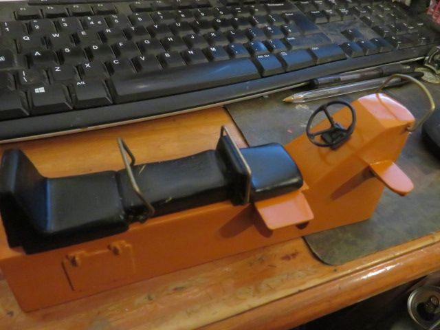

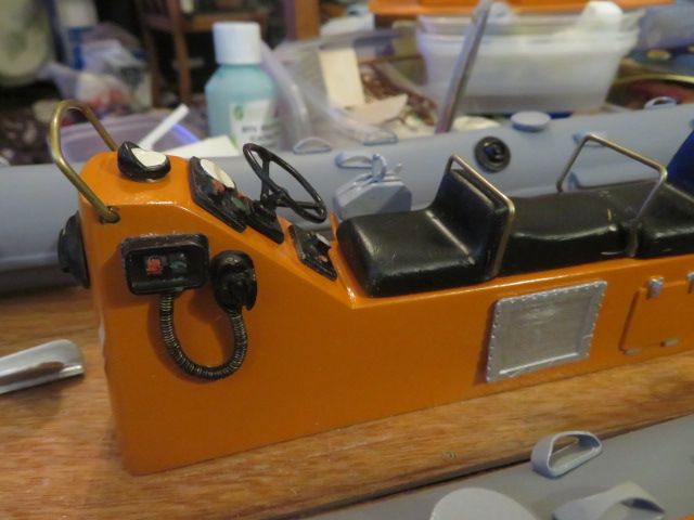

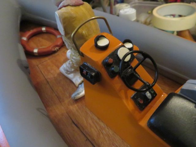

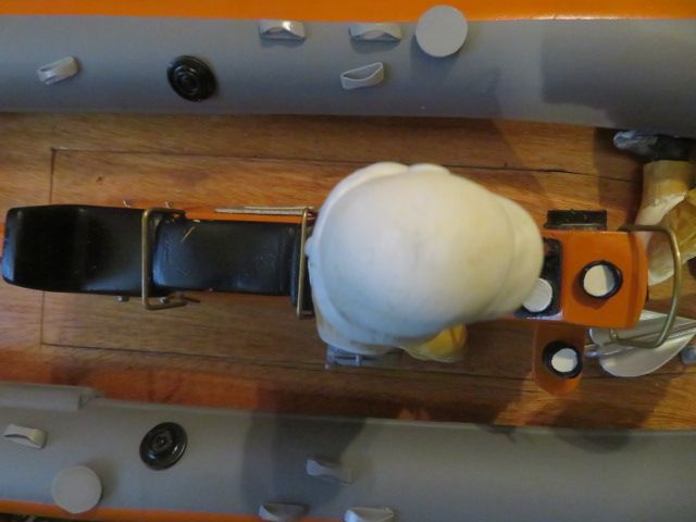

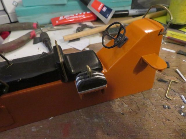

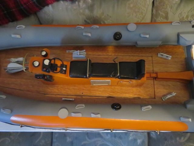

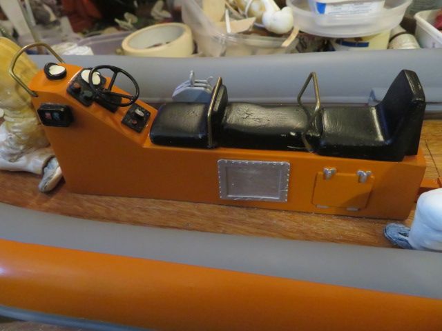

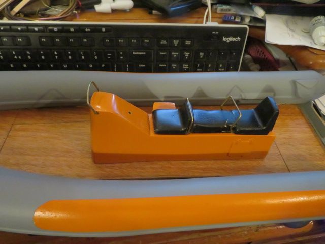

                        A little detailing of the seating pod has been done this evening……
                        just a few little bits to do once the white paint has dried, plus the channeling cover for the outboard motor controls has been glued to the deck[sp;it of course to allow removal of the pod].
                        i need to find a radio areal and a micraphone and base in my bits and pieces tomorrow, paint the grab rails black, fit the fire extinguisher at the rear, and that is that part done.

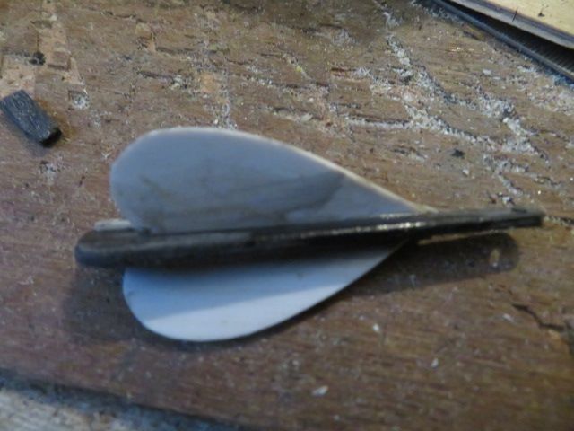

                          i ended up with the small plough anchor fo the Atlantic 21

                            Well, my new addition to the Atlantic 21 fleet is almost finished.
                            I have the chain and rope to add to the plough anchor.

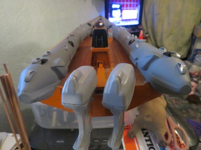

                            The outboards have to be fitted together painted and added to the transom and the lettering adding to the orance flashes, and that is it…….
                            Yippeee, another one restored!
                            And thanks Andrew Cowling for giving me the chance to build another one into a special boat…..the first one from the Atlantic College, in Wales.

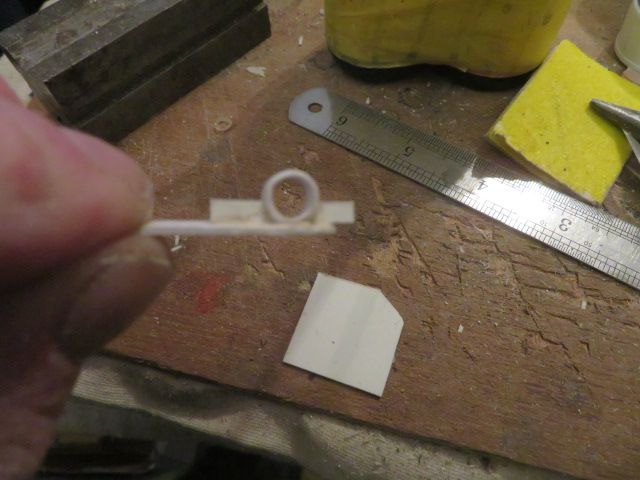

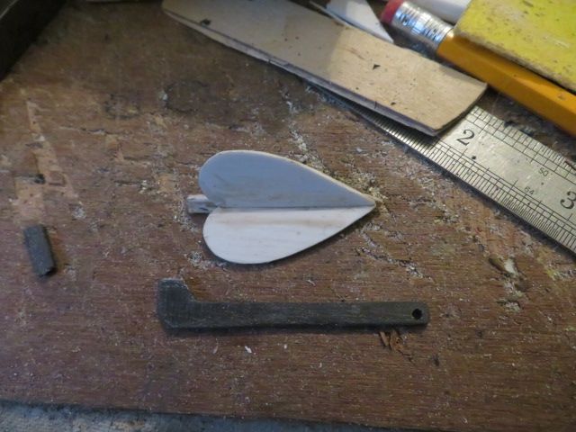

                            thats the bow hawes ring that was another little scratch built last minute fitting……….made two………as i lost the first one in a 5th dimention.

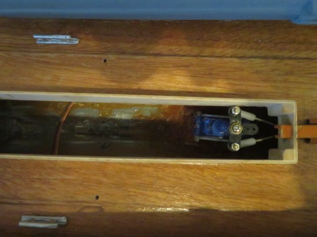

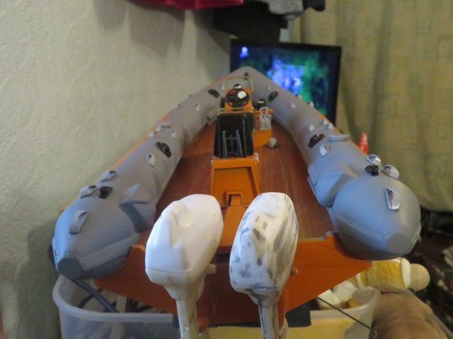

                              Get on with the 21…..so the latter won, and all I have to do now to finish the boat is to link up the outboards to a servo inside the boat, put on the Evinrude stickers on to the engine covers, find some chain and "rope" for the anchor, and then find the cord i have for the sponson grab lines and rings, name the boat…….and that is it………..oh and yes, paint the 3 grab hancles that are attached to the seating pod….
                              AND THEN it will be finished.

                                  I have never had much success in using plasticine as a temporary mould. The stuff seems to move and grab the bits. Is there a special technique?.

                                      i use "art" plastercine Ashley, not the model casters plasticine which is a lot harder, but otherwise, get just as good a mould when i want just a few.

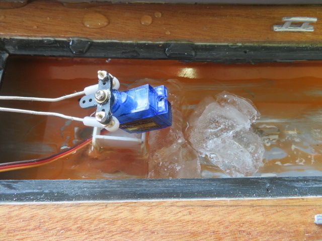

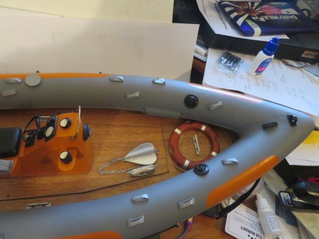

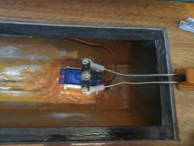

                                        i wont go into the frustrations of 3 days on here, but to say that the links were finally made from the outboards to the servo and fitting the last of the bits to the hull.
                                        sadly i did order the wrong size BECC Vynil lettering for the sides of the sponsons, and so will have to wait to apply them before the boat is finally finished, within the next couple of days, but i'm happy with the results.
                                        now just waiting for the return of the Liverpool hull from Dave in Wales, and i can crack on with that one too!

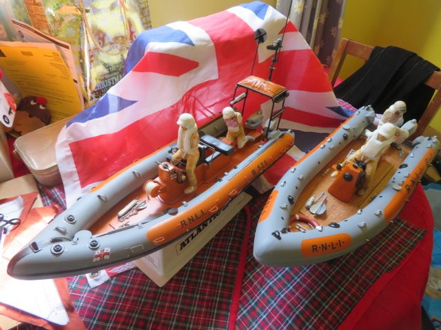

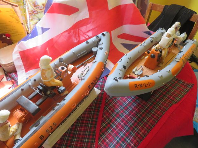

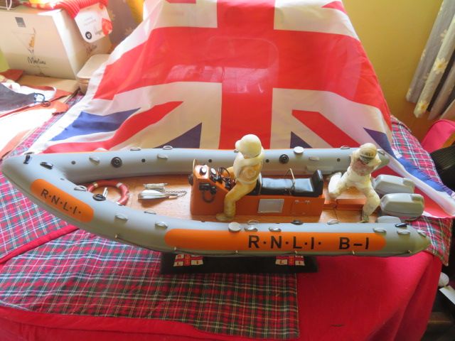

                                          The first Atlantic 21 has been "named" and just awaiting the "EVINRUDE" transfers to be printed and applied to the outboard motor covers on B – 1 and then i can get on with my Liverpool class lifeboat once Dave Stavros Jones gets his finger out and finishes painting my hull…………only joking mate.
                                          Now I have two built……….the first from Atlantic College R.N.L.I. B-1 AND the first Atlantic 21 to go to Blackpool for trials, B- 525 which was un named but later took the name of SPIX's MACAW when she eventually went to Ireland on service.
                                          I am quite pleased with the rejuvination of both boats, and will look forward next winter to making the 3rd and final 21 for my collection as B-594 Herbert and Edith, the last but one 21 to be built.
