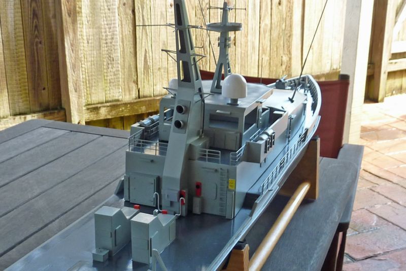

          #27582

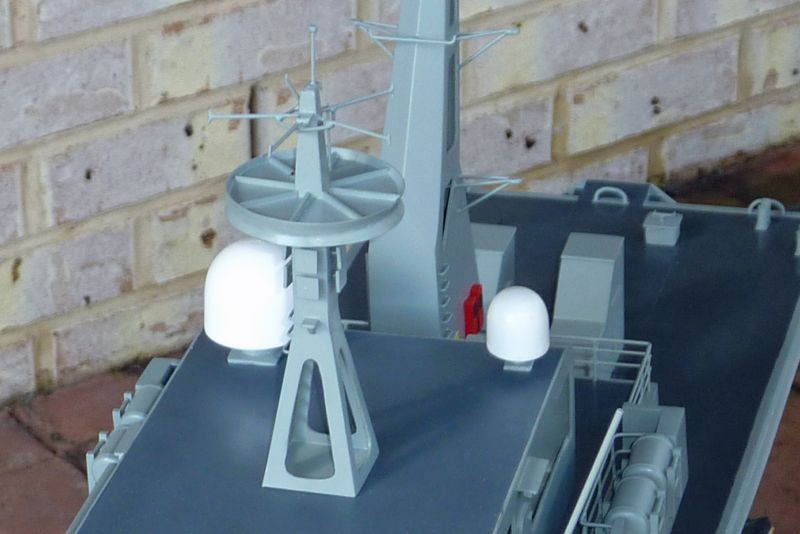

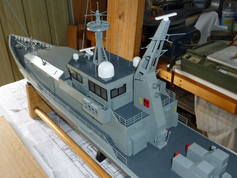

          Peter Fitness
            @peterfitness34857

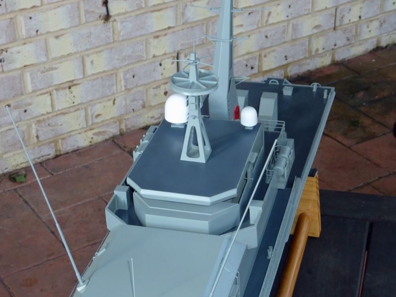

            Some more progress has been made, with more detail added including the circular antenna and its mast, 2 of the radomes are on and some of the hand railings have been fitted. I’m waiting for some brass rod to arrive from the USA before I can complete the railings. The 2 RIBs and their davits are next on the list. I’ve also fitted the 2 big whip style aerials on the forward superstructure.
            Peter.

                          #27788

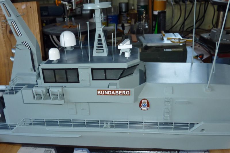

                          Peter Fitness
                            @peterfitness34857

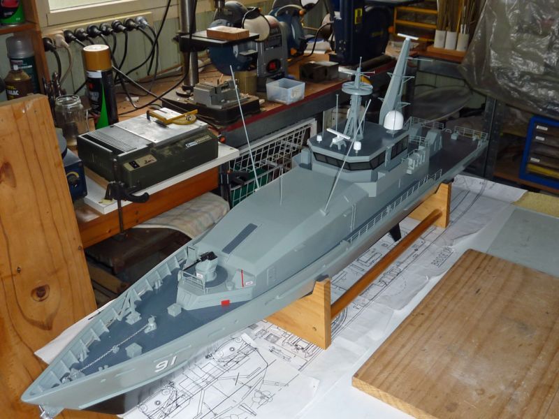

                            The windows are now glazed and more aerials added to the bridge roof. I’ve also attached the name boards and crests. The name boards are BECC lettering on a New Guinea rosewood board, and the crests were downloaded from the RAN web site, then printed on to water slide decal paper on my printer.
                            Work on the 2 RIBs is in progress, and other small details will be added soon.
                            Peter
                            #27790
                            David Meier
                              @davidmeier28154
                              It is looking fantastic Peter. You must be very pleased with the way it has come out.

                              #27791
                              Peter Fitness
                                @peterfitness34857
                                Thanks, David. Yes, I am pleased as it’s been my most ambitious project yet. It certainly looks like an Armidale, so that’s a big plus

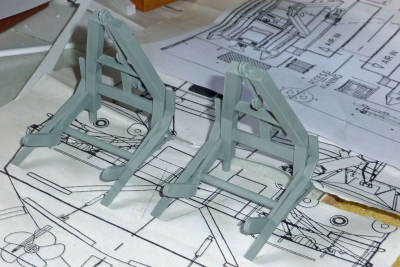

                                        #27867
                                        Peter Fitness
                                          @peterfitness34857

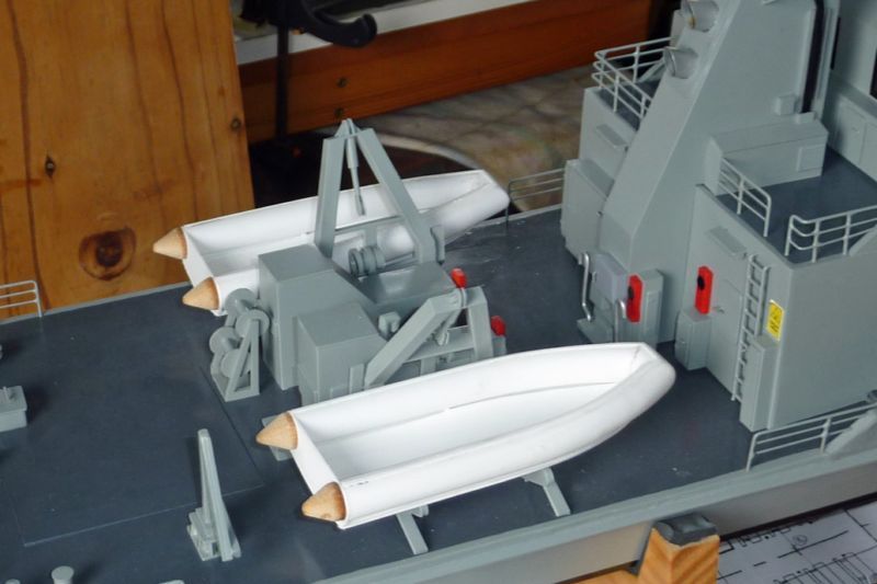

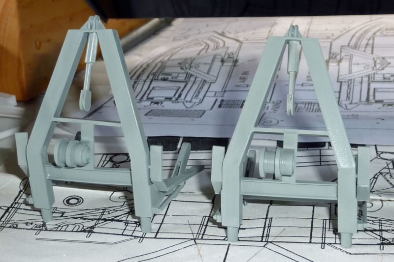

                                          I’ve managed to build reasonable (I think) representations of the RIB davits, and am working on the RIBs themselves. Once these are finished, the end is nigh (as they say), with just a few details, such as navigation lights and life rings to be added.
                                          Unfortunately, the last episode in the current series of “Sea Patrol” went to air here in Australia last night, but it will return in 2011, according to producers, Hal and Di McElroy.
                                          Peter.
                                          #27874
                                          David Wooley
                                            @davidwooley82563
                                            Hi Peter nice job on  the davits. What material are you using   to make the RIB?
                                            Dave Wooley
                                            #27875

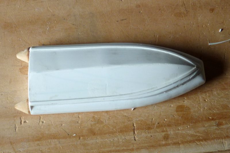

                                            Peter Fitness
                                              @peterfitness34857
                                              Hi Dave,
                                              I used Evergreen styrene tube, bent using boiling water, for the hull sides, and styrene sheet for the rest, except for the tapered ends, which are from pine dowel turned down on my lathe.
                                              Peter.
                                              #27887
                                              David Wooley
                                                @davidwooley82563
                                                Hi Peter  I   very much like the results on  the RIBs  and the methods used  to build them . Good lateral thinking
                                                Dave Wooley
                                                #27902
                                                Peter Fitness
                                                  @peterfitness34857

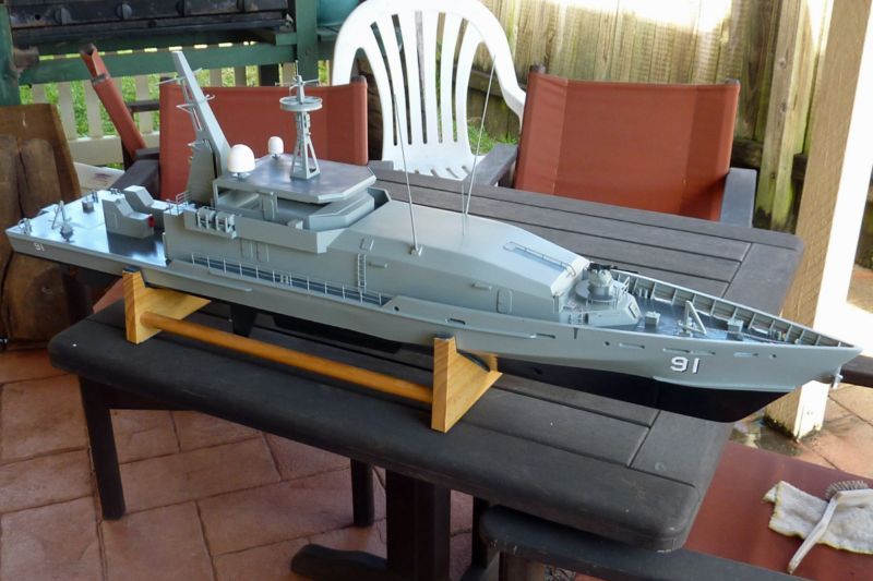

                                                  Thanks, Dave. As I said earlier, the davits are representations only, as are the RIBs, and not exact scale replicas. I am not building the boat with a view to entering it in scale competitions, so I am attempting to capture the character of the vessel, with as much detail as practical, given my aging eyes and hands
                                                  She has had her first flotation test, in the bath, and she sat beautifully on the waterline with two 6v 4.2 Ah SLA batteries on board. I will give her a test run later this week, and her club debut will be next Sunday.
                                                  Peter.
