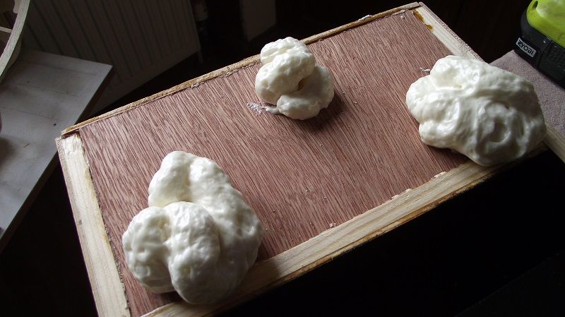

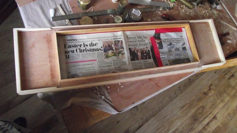

                        Back to the current job in hand,
                        The deck of the first dumb barge ready for primer coat, the inside is already painted matt black hence the masking.
                        I also had problems with the foam, it kept on expanding for nearly an hour, a bit like a magic porridge potfrown.
                        Regards.
                        Eddie
                        #82786
                        Roger Clark
                          @rogerclark
                          That's looking good Eddie, you've overtaken mesad, it's difficult to judge the foam right so it fills the space but not overflow too much. Can't make out whch bit that is though?

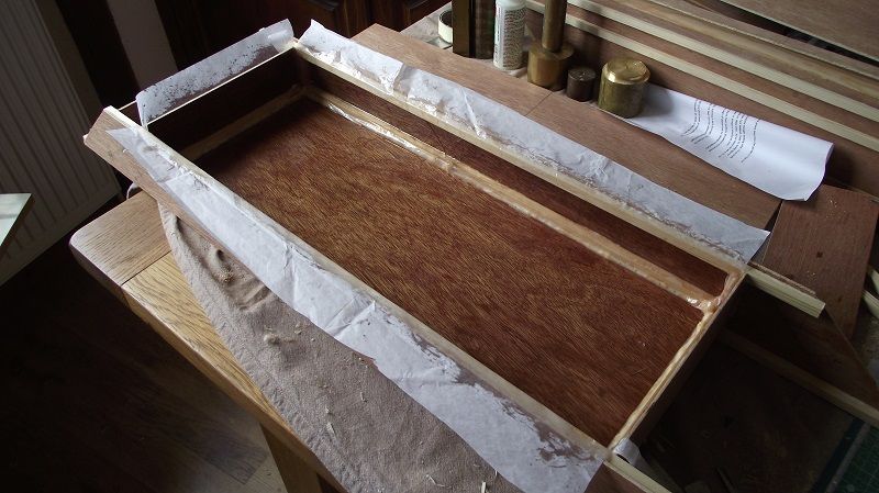

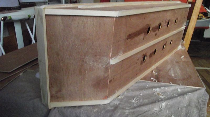

                            No.2 barge is now well under way.
                            I have deviated from the build sequence in the article, I fitted the ballast tank top first so that the inside could have a good coat of epoxy resin with tissue reinforcement, although the structure is strong enough on its own I thought the resin and tissue will give a good waterproof skin
                            The excess tissue will be cut off while the resin is still 'green'. The bottom will then be fitted and all the rubbing strips.
                            I have arranged for the 'raw' edges of plywood to be covered on the outside of the hull, this will protect them from the water and not show through the paint.

                              That's a good way of doing it, I did mine the other way but used some roof sealing compound that remains flexible to seal it all, Coated the bottom and sides then dropped the lid on with a thick coat on and that's never going to leak. I plan to glass the hull and deck then red oxide all of it and the matt black for the hull, not sure for the deck though.

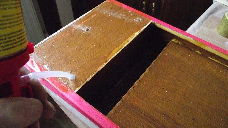

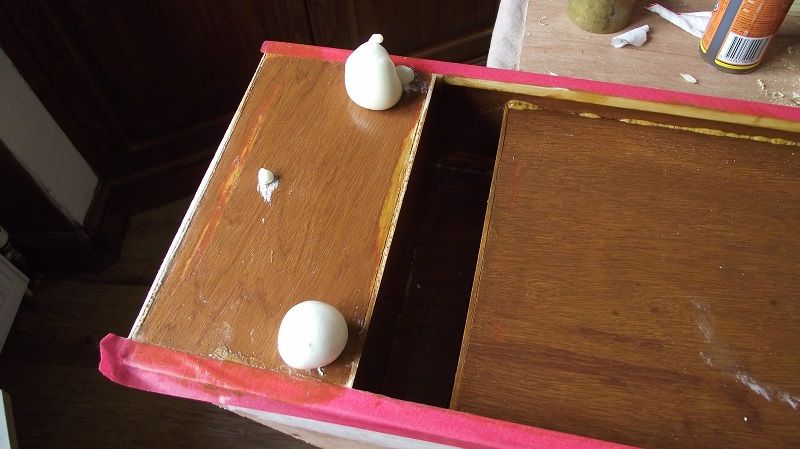

                                                  Eddie Lancaster
                                                    @eddielancaster
                                                    Here we go again, adding the foam to the stem and stern on No. 2 barge.
                                                    Just the right amount this timesmiley.
                                                    Eddie.

                                                      Hi Eddie, Aah practise makes perfect, so where have I gone so wrong in my life laugh. Should have been at the HSME invitation weekend to help out but feel so out of sorts it's a struggle to do anything at the moment sad, hey ho never mind tomorrows another day and I'll be fine, smiley
