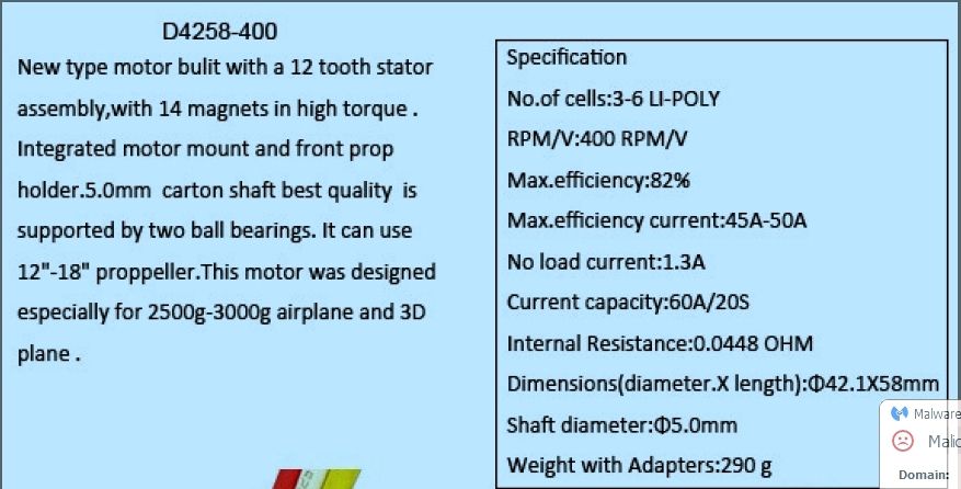

              So if you require brute power, what about this motor(specs.added).turnigy 4258-400kv specs.jpg

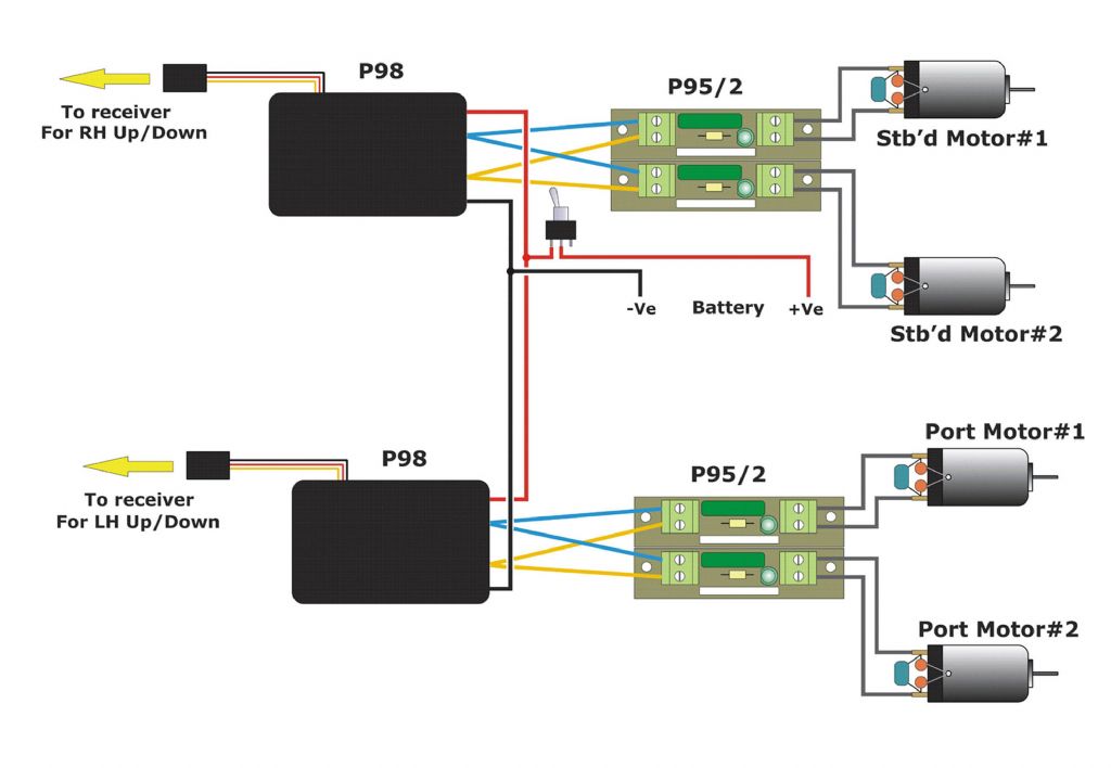

                              I like this idea. What is the best way to wire two motors into one ESC, while making sure each motor gets 12 Volts?
                              #77972
                                Q. Consider that an ESC has a red and a black wire out, to go to one motor (or whatever colours it might use)
                                Simply double up the red and black wires so that each motor receives one red and one black. The voltage will be the same for both motors.
                                PS if using screw connector strips please hide these from DM as he disapproves of them.

                                  Parallel. With a fuse supplying each motor. Each motor gets whatever the ESC offers, the individual fuses help ensure that if something happens to one motor, its mate will carry on, or at least have the chance to carry on.
                                  #77974
                                    Like this. I've included a couple of twin indicator fuseboards P95/2 for safety in case any of the motors become stalled.
