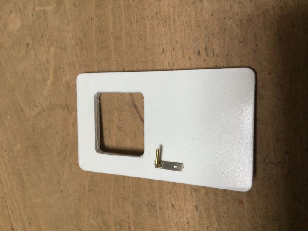

                                                      Mattias, it's not just for door handles, it's for all the hand rails (see pic) as well. I see that the Aeronaut model rails have been painted white, so I can't understand why they didn't use copper! I agree about the orange handles and will paint mine.
                                                      I was intending to leave the nickel silver as it comes, no painting.
