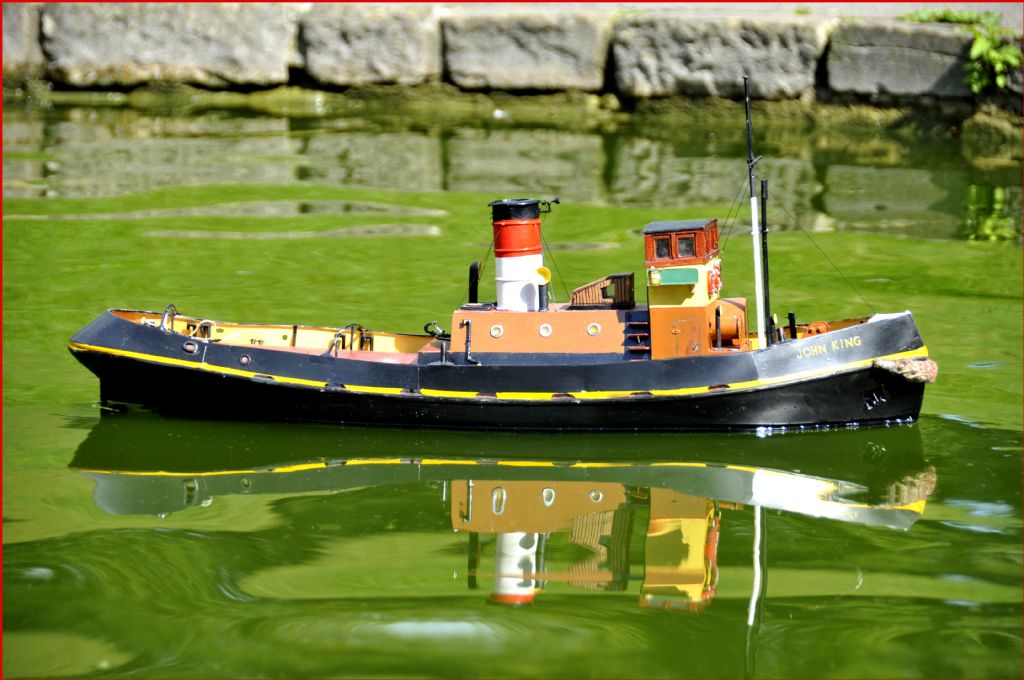

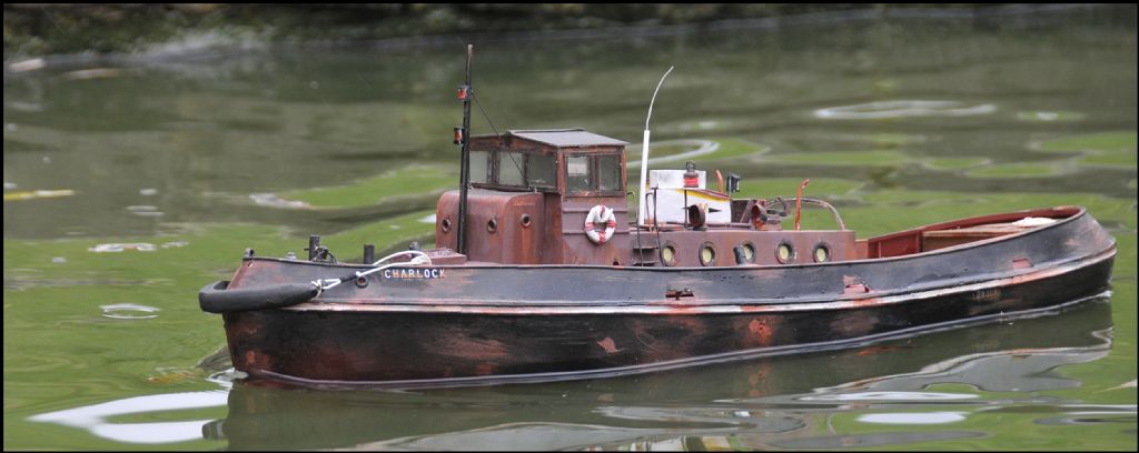

            LARRY WHETTON
              @larrywhetton68737
              CHARLOCK TUG Hi Anttony,
              I have used double sided carpett tape on my John King,
              or i also used silocone clear mastic , on charloc…….
              hope this helps cheers Larry..john king launch
