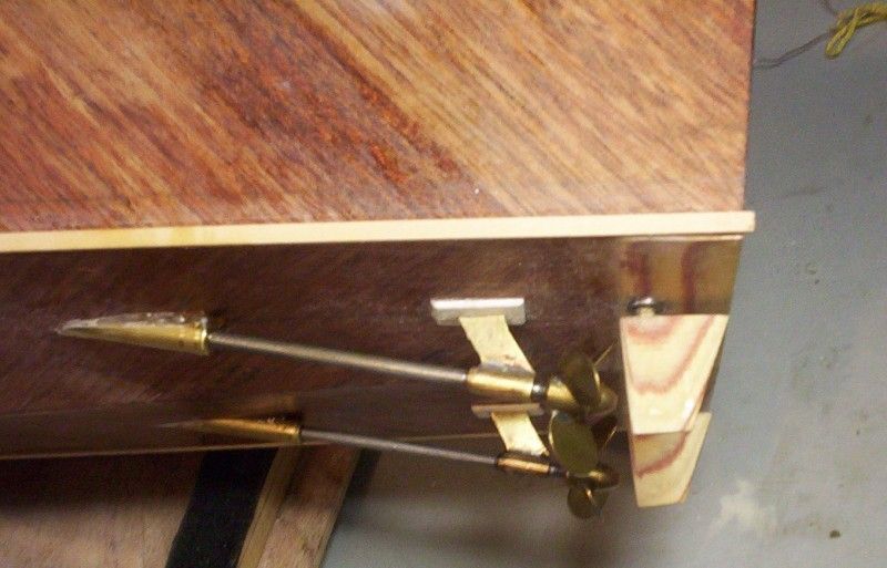

      hi there, Michael, your message has just been pointed out to me – as far as the prop shafts are concerned, I would go with what Ray on his plan has shown you. As far as prop shaft lengths are concerned. When I built my model of the RTTL I made up the prop shafts from cut down 12 inch prop tubes which the outer section had been cut down to approximately 6 inches long and the shaft was left at 12 inches long. There was then a support made which fits next to the propellers. Bit of a tedious job to set two of them up – because in the long run its just for cosmetic looks really.

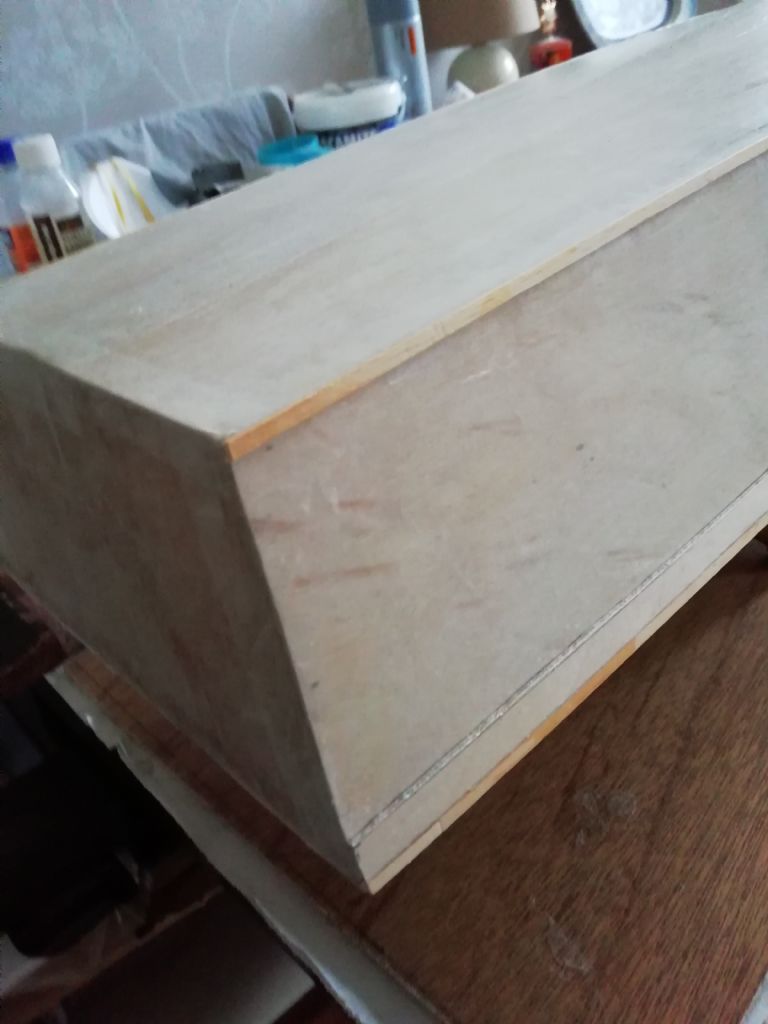

          Hi,
          I should have said I applied the super glue to the batten but you may have gathered that already, but I did apply the glue around the batten to ensure the seal was made.

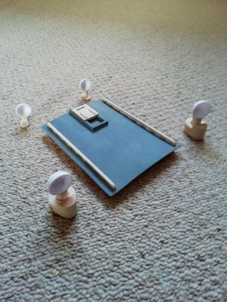

            Hi,
            Here is a photo of a few parts I have been making.

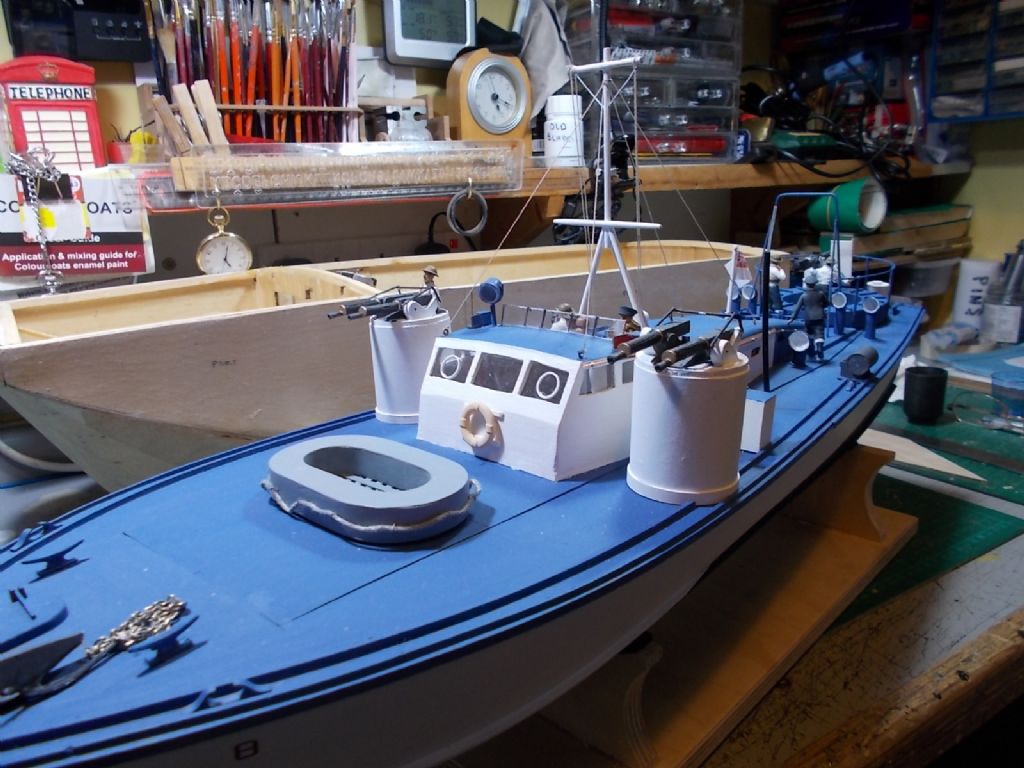

                                have you thought about using a CD case – the clear plastic ones. Just tried this idea myself on the windows of an MGB and what I was able to do was to glue rings cut from plastic tubing onto them. I used Tamiya extra thin cement to stick the rings onto the windows. I also used canopy glue to stick the actual windows to the inside of the superstructure. Up until now, they haven't fallen out and I haven't poked them out with my fingers. They seem to withstanding a bit of rough and tumble.
                                #85856
                                  Hi John,
                                  That's a very good looking gun boat 😀 yes the CD cases are great for glazing & flat windscreens that need some strength.Regards
                                  What is the new hull in the background??

                                    0024279_buoy-cat-mm728_300.jpgRay, the motor gun boat was a free plan in Model Boats mag way back – its been on the back burner to build for a long long time – and the model in the backgound is another old one – called the Buoy Cat designed by F.Body. At the moment I am setting up an Enya 19 inside – cos there are one or 2 lakes around here that allow us to run IC engines and we can get away with running IC engines if the model is a bit vintage.
                                    john

                                        Hi John,
                                        Buoy Cat's a classic alright, I remember the dreams inspired by the MAP plans handbook designs during the 60's 😀
                                        Maybe we should start a Vintage classics thread? Is your gun boat the Grey Goose ?
