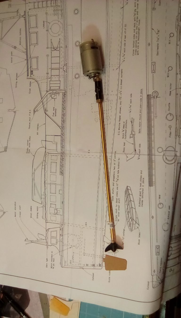

      Here is a mock up of your rttl over the drawing with a 4mm shaft 6mm OD 10" stern tube with an X35 prop, Huco coupling and 600 brushed motor. The rudder is the traced shape of the Perkins medium size. The bracket shown on the drawing is of the full-size boats shaft support, which you don't need but a little fillet between the keel and the tube will give it support.
      Sorry the photo's vertical my tablet had a funny turn 😀img_20200116_195141.jpg

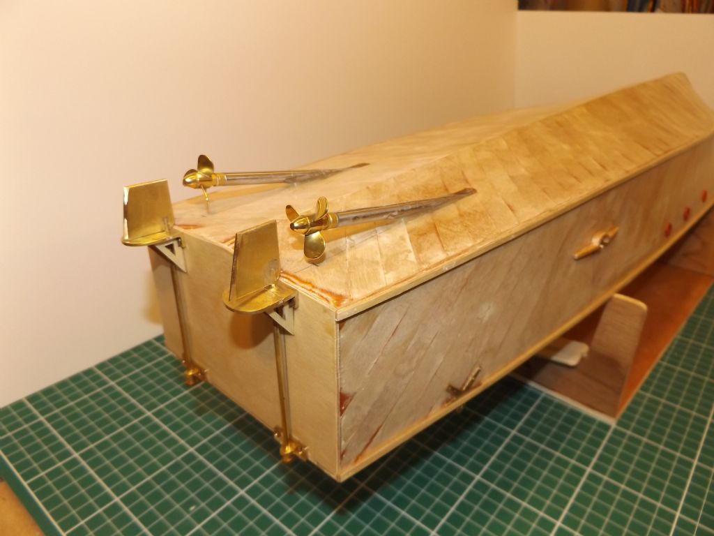

          That option will be twice as good you may want to double the ply skin with a patch where the tubes go through the bottom of the hull, here's the same set-up on my Huntsman 31, which is 34" long. you could go brushless but I think it would make Mach 2 easily

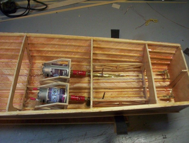

            it is good practice to reinforce where the prop tubes go through the skin of the hull. I have put a photograph on of how I did this on the RTTL which I myself built.
            just out of curiosity, is it not worth sticking to one prop shaft through the keel – this would make life a lot easier for you as you will only have one motor and coupling to line up – whereas if you have 2 prop shafts and motors – you then have to ensure that both prop shafts line up on the outside of the hull of equal distance from the hull skin – and – also that the 2 prop shafts are parallel to the keel. Just food for thought before diving in
            Also, if you require the correct shaped rudder as is on the plan – one of the ways I have done it in the past is purchase a rudder from 'off the shelf model shop' and cut it and file it to the shape required.
