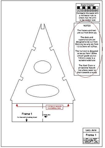

        Are the keel and formers 6 mm ply?
        #50339
          Hi Bob
          Yes they are 6mm but you don't have to search over hill and dale for the information as you have already printed it off in the notes section of drawing 01

              So that's where it is?……Would not have found it in a month of Sunday's!
              Why not have a page of notes on page one for anything relevant?
              I'm going to use quality birch ply this time as opposed to the cheap stuff, as a bit of weight won't be much of a problem?

                Notes are put there to be read for your benefit, Bob. Writing them in a box on the same page as, and directly alongside, the relevant parts with the heading "Notes" is pretty much the most which ought to be necessary. It would be irksome to have to place little 'sub-notes' all over the drawings saying "please read the main notes".
                In any case, a separate page of notes is just as likely to be ignored by those who are of that inclination – if not even more likely. I still believe there are folk out there who regard the instructions for anything as just an expensive part of the packaging.

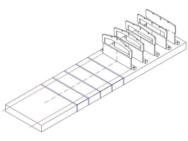

                      Getting back to the build
                      The installation of the frames continues.

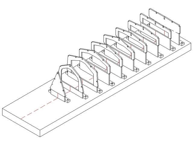

                        And is now complete

                          That`s really nice, Paul
                          My only critique…..Centre lines are a long dash followed by a dot

                            I thought a long dash followed by a dot was morse code
                            and its criticism not critique
                            #50422
                              A long dash followed by a dot is what I tend to do six or seven times a night, and it's "it's" not "its" in this context.
                              I've always used long dash followed by short dash for centre lines, but what the heck do I know? As long as it's not a solid line then only a pedant would give a damn…………………. and there are none of those on this forum, surely?

                                BS308, which was the defining standard in my drawing days, and probably Bob's, says a centreline must be illustrated by a chain thin line, i.e. alternate long dashes and short dashes.
                                BS308 has now been superceded by BS8888 but the recommended symbology for centrelines is the same.
