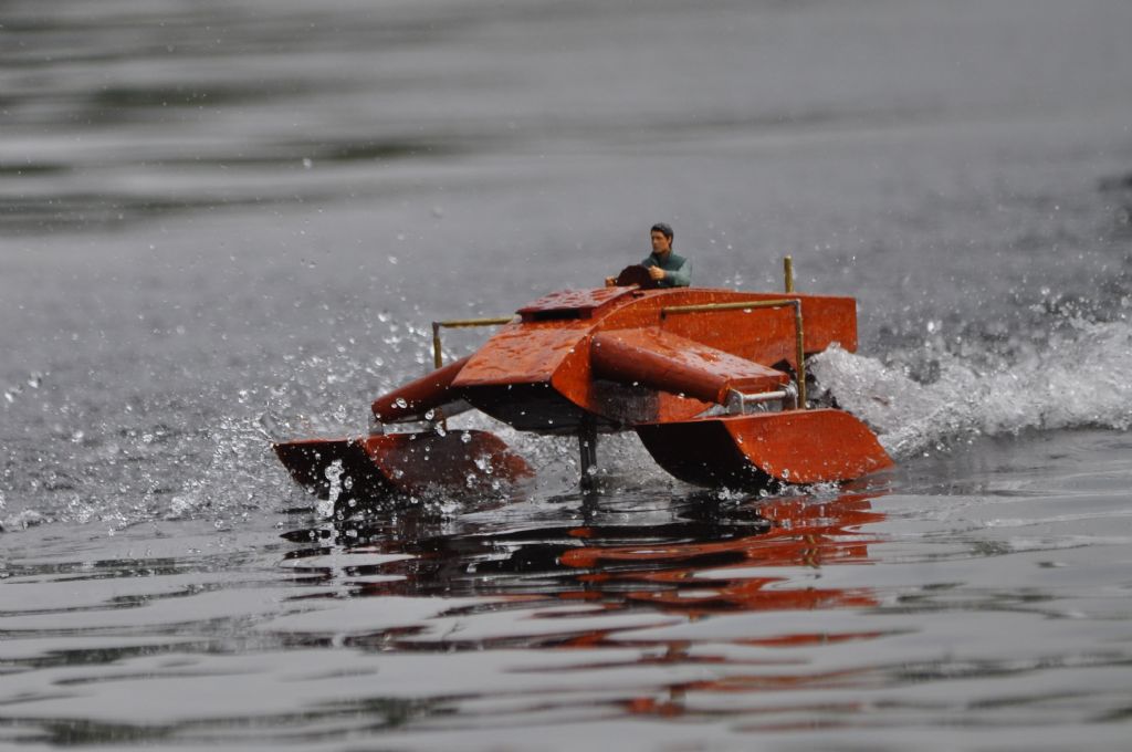

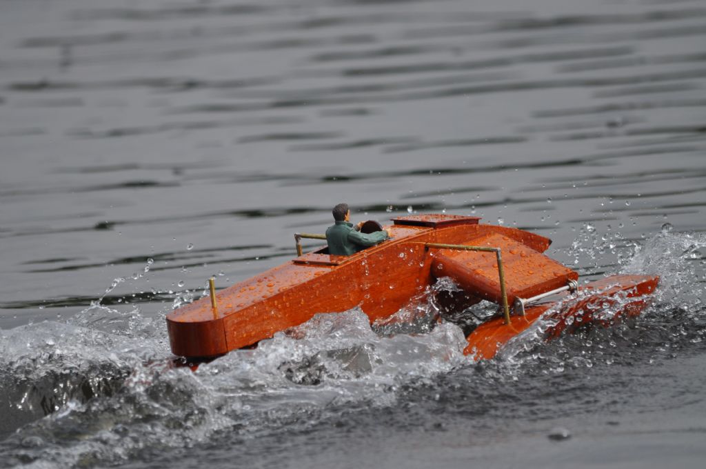

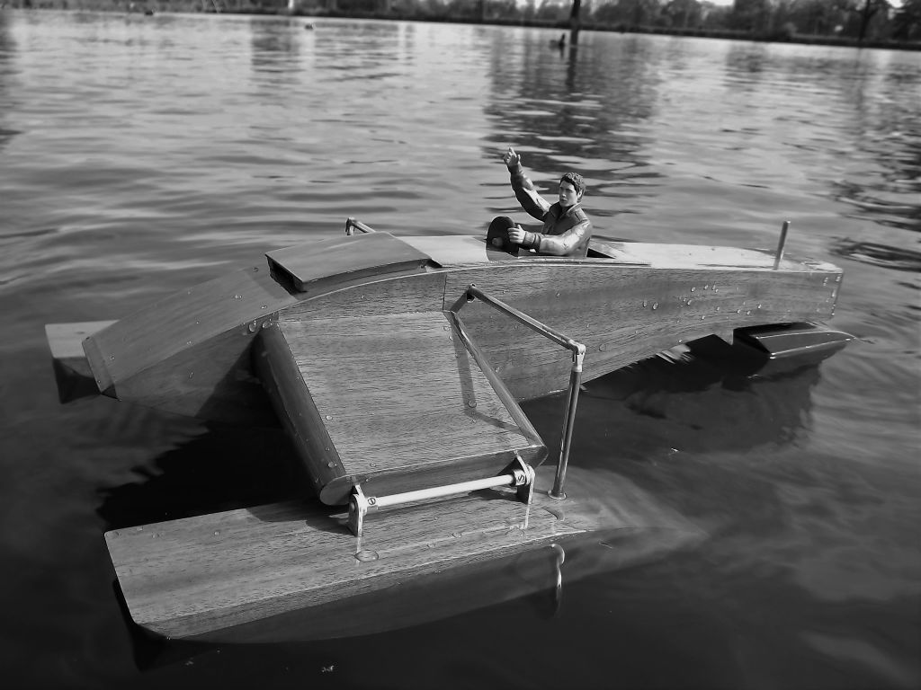

            Er, to a point……

              Sorry, I know its not what you were asking, but nothings impossible.

                Yes, I don't think that is what Jerry is looking for!
