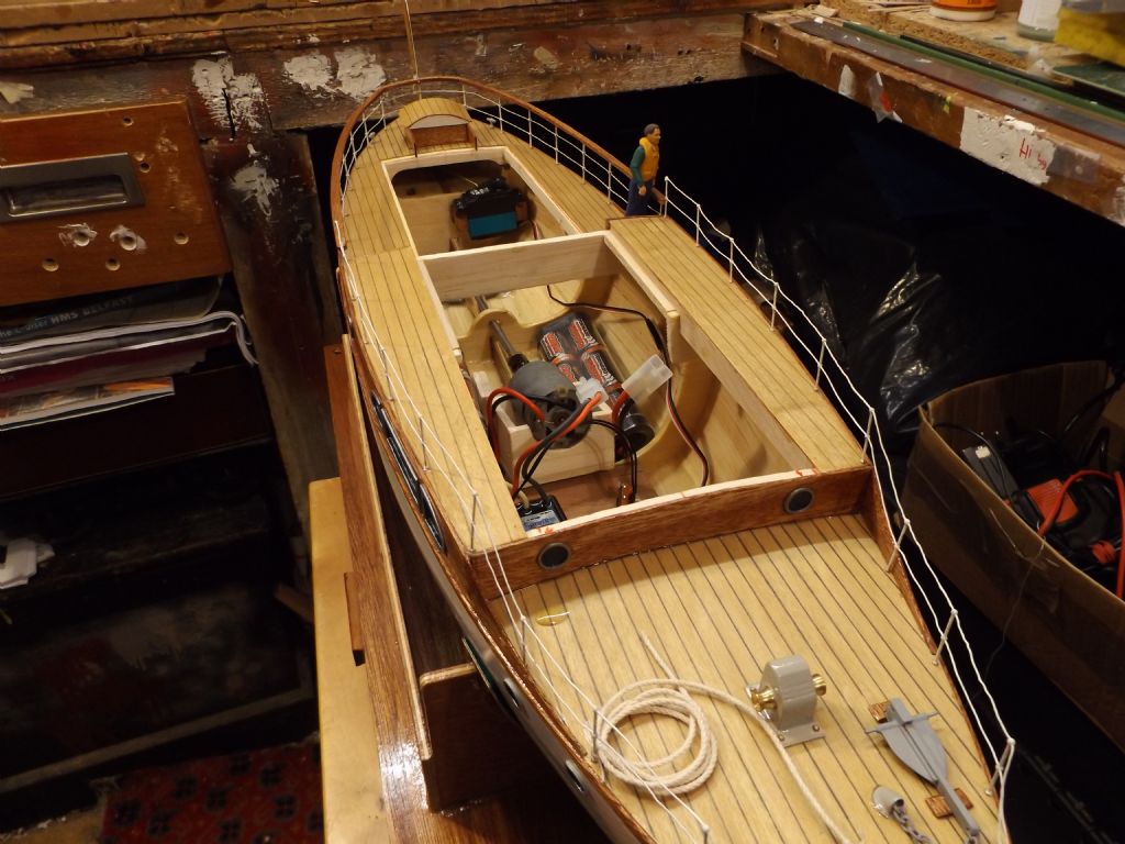

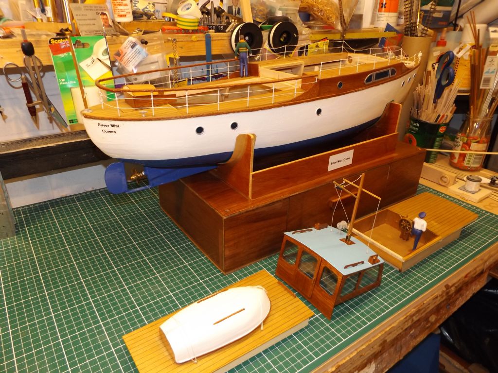

      rw 60 003.jpgHi Bob
      I think Vic may have designed SM as a relatively light displacement hull, I will weight her on the scales and let you know the all up weight. The wheelhouse is removable as a unit and the deck & cockpit well lifts out, the rear deck with the dinghy is also removable, with a small hatch/companionway over the tiller/steering for adjustment. With a 600 size motor + 2 battery packs in the bilges either side in the centre of the hull only weight needed at the bow. the construction of balsa planking,frames and 1/4 ply keel she is very light.

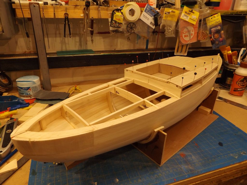

                    Hi Bob
                    I have weighed SM @ 30" ready for the water 5lbs 12oz
                    As Vic says in the original article she was drawn from a couple of photos so I doubt if the hull lines are correct, but he designed for the weight of Mabuchi or Kako motors and torch batteries in those days, I built the 21" version when I was 12 at school. I doubt these days If they would be let kids near a Stanley knife !
                    The blocks for the bows are not required, planking will be fine but the cruiser stern vertical sheeting and blocks under are a good solution, I'd double the number of frames to support your planks, I'm tempted to have a go a 1/12th version of Silver Vanity at 54" long
                    #64328
                      Many thanks Ray
                      Your model appears to be extremely light?………Have you used Balsa Wood?
                      I do like your colour scheme…….She looks very smart
                      Can you show us your motor installation, please?
                      A 54" Silver Mist would look very nice and would look grand on the water

                          Hi Bob
                          Yes I've followed your gentleman's cruiser progress. I was impressed with all those motors & belts.
                          The bulkheads and planking and blocks used are all balsa, 1/4" ply keel & doublers, 50 years of Aeromodelling I still use balsa cement for planking and it sands well.
                          Currently building 30" MTB 71 from the Vosper drawings for my grandson because he wanted something fast but my next big project is HMS Belfast @ 1/96 scale which come out at 6' 4" could be a 5 year job as I still have to earn a living inbetween model making.

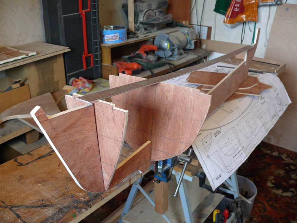

                                  Some forum readers are asking about work in progress already!
                                  There`s not much to see at the moment, chaps
                                  I`ve scaled up the Keel and Hull formers by 1 : 2.25 to achieve a 48" hull and cut a few out
                                  The formers are not down to the finished size yet, as there may be some adjustment necessary, due to my sloppy marking out!
                                  Just wondering……How do I make intermediary bulkheads that are right first time?

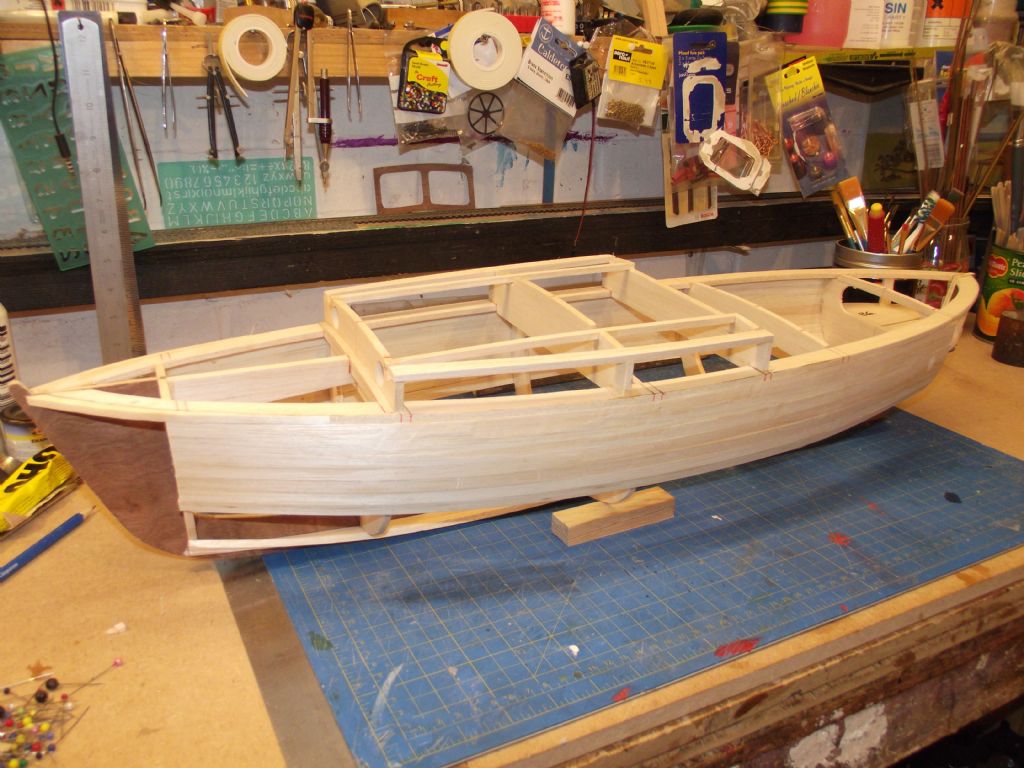

                                          #64358
                                            You might get away with that Bob although it may then be prudent to reinforce the inside of the hull with GRP or internal ribs to keep it nice and rigid as you would be constructing a partial shell. You don't want to risk springing the planking in the event of a collision.
                                            #64362
                                              Planks of 10mm x 4mm section seem to have bridged the gap satisfactorily and further bulkheads may not be required now
                                              At the moment, I`m trying to decide on the various heights of the bulkhead tops and the actual construction of the keel top edge. Since there is no cross section available, I`m having to crib off Ray and Ian`s examples

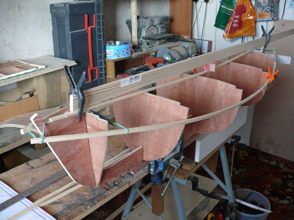

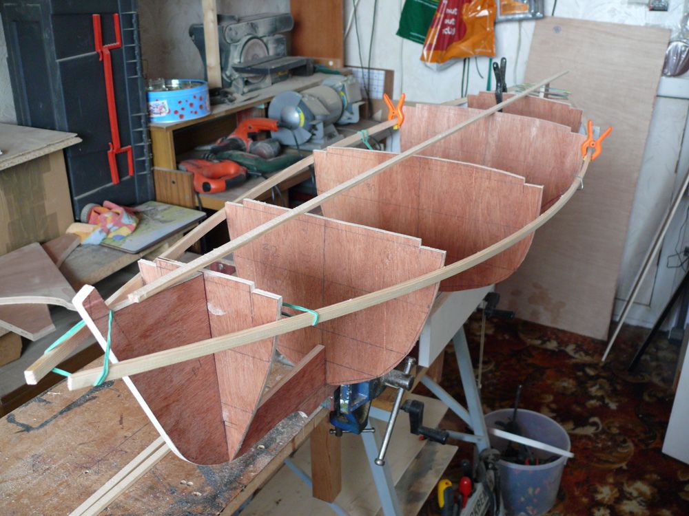

                                              #64374
                                                For the benefit of future builders……
                                                As drawn, the bulkheads rest on the top edge of the keel
                                                I have since, notched out the keel where the the bulkheads are positioned…….For a positive repeatable position, so we can't use this for setting the bulkheads to the correct vertical height
                                                Taking a flexible strip, the strip rests on each end of the keel……As shown and the the bulkhead notches can be cut out to produce the precise and correct fore and aft shear, using the top edge of each bulkhead
                                                The maximum hollow dimension is 18mm
                                                To the casual bystander, this may seem complex and irrelevant, but to an actual builder, this info is essential
                                                We can now proceed with confidence
                                                Ian and Ray……How did you find this facet of the build?
                                                #64376
                                                  This is what all the fuss was all about!
                                                  The flexible strip is touching all the bulkhead tops……….As Vic designed
                                                  The shear has 18mm hollow……Shown in red
                                                  Now to adjust the bulkhead widths and final profiles
                                                  Next big job is to set the waterline and cut out the bulkhead lightening holes
                                                  To avoid the nasty job of drilling the keel for a single propshaft, I`m thinking of going for a twin prop jobby, single motor and twin timing belts for engineering interest
