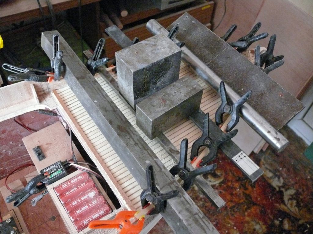

        The idea I came up with, was to use the 1mm white planks and fit the dark planks edge on as the Oakham stripes!
        Got the radio gear tried and tested…….The chain mech for the rudder works a treat

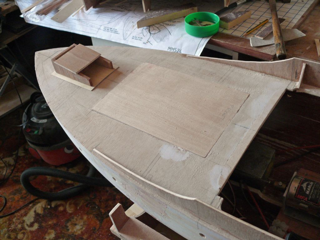

          Is it a trick of light or have you created a lovely camber on the foredeck, I agree with Mattias that it is crying out for proper planking.
          #66587
            Hello Paul
            It`s not a trick of light……It has about 5mm camber at mid point
            Not going to attempt your standard of planking or finish………Just building an interesting average quality model

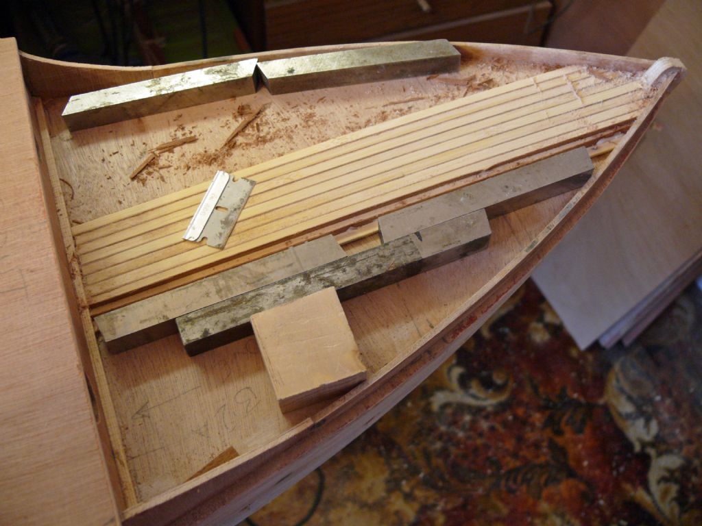

              Made a start on the fore deck planking
              Easy to do with no problems
              Using a blade as a scraper, to remove surplus veneer and glue
              The scraper is very pleasant to use and leaves a scratch free finish
              Note the blocks and use of side wall for wedge effect

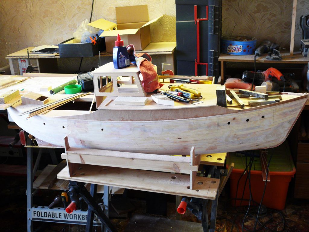

                What`s this all about, Bob lad?
                It`s just a peaceful general view of the latest state of play…….Nothing special
                It just appealed to me, as a pleasant sight of busy work in progress on a Sunday morning
                The untidiness of it all, adds to the interest?

                  That's a nice picture Bob and reflects the true state of play when making a model.
                  ​Before the highly polished and pixel perfect pictures appear in our illustrious magazine, this is what happens behind the scenes (Except DM`s workshop where tidiness reigns supreme ) ( as it would do in such a fantastic purpose built facility) (with "call-for-tea" button)
                  I dare not show my building space in full flow, it is too horrible to contemplate.
                  Actually, mostly I use a workmate in the garden (if you know what I mean vicar)

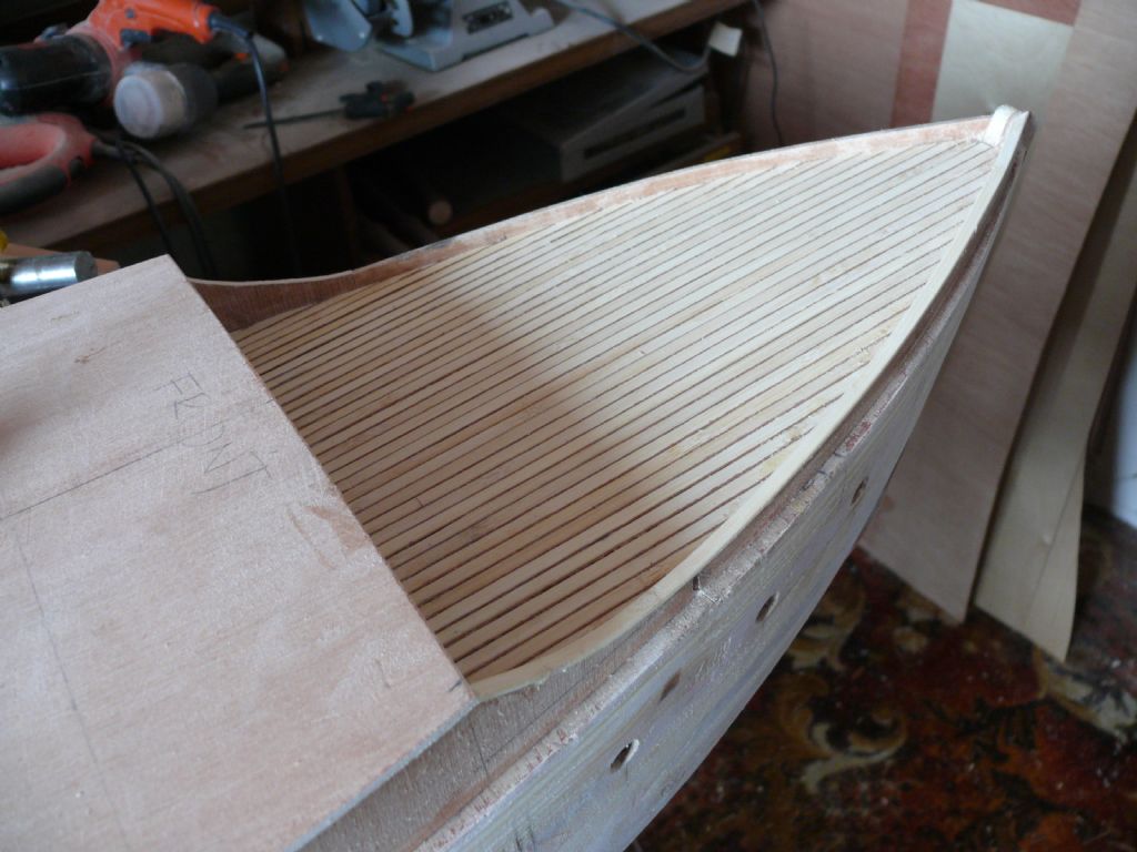

                            Just finished planking the foredeck……Now in the process of cleaning it up
                            It used up quite a bit of veneer too

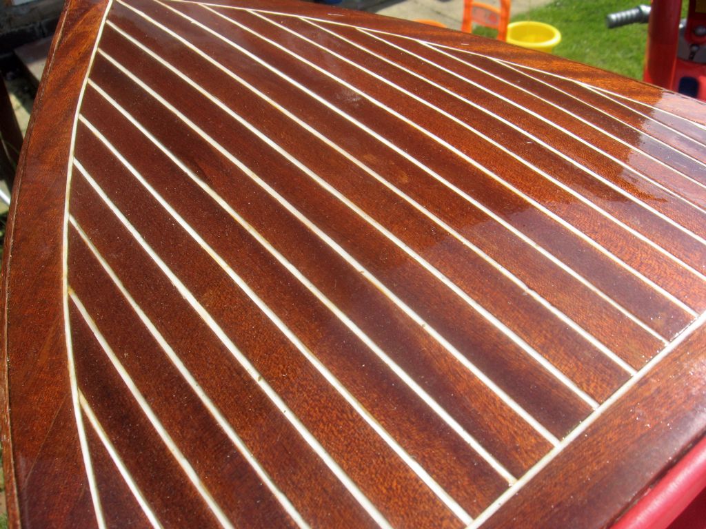

                                                It might be wise to apply a sealing coat of thinned down varnish to your lovely decking to protect it from inadvertent accidents.
                                                #66675
                                                  That's very kind and thoughtful of you, Paul
                                                  But I haven't finished scraping it yet………Got to admit, it's not the best planking in the world, but it'll have to do

                                                    Planking looking good to me. Wise words from Paul to protect it as soon as possible.
                                                    #66714
                                                      Captain Bob
                                                      Sealing not only protects the timber it also prevents moisture from getting into the fresh surface and stabilises the grain, which will make the sanding a lot easier and ultimately produce a better finish.
