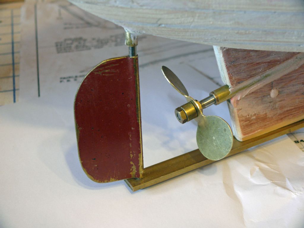

                  Not much to show for my efforts today, chaps
                  Besides finalising the motor drive and fixing in position and general fiddling etc……..Not to mention some more nonsense with Win 10!
                  I made another prop from sheet brass………Couldn`t use the GE prop afterall
                  Might have to make a new rudder now………Don`t like the prop / Rudder gap?
                  I was actually toying with the idea of reversing the rudder and having the blade in front of the prop!
                  Which would probably work?

                    Hi Bob
                    To reduce the gap you could make a new balanced blade with a section in front of your rudder post, I always thought that would reduce the load on the servo in operation ? rather like a balanced ailerons on a plane ?
                    Do your brass props work ok, I've just ordered a 80mm 4 blade prop for Cullamix £28 !!

                      Hello Ray
                      Congratulations on your Barge/ Boat publication
                      My Daughter has just purchased a similar full size jobbie……..Photo to follow
                      A balanced rudder would fill the gap nicely…….If only I had some brass
                      Could use Ali and rivet it?
                      My props work quite well………Take a look at Great Eastern sailing at Etherow
                      Just type in "Great Eastern at Etherow"………Not bad for a 540 motor and 3" prop……….And ……..7'- 0" long
                      Just popped the pond, moving it about!………….Will get a smaller one next time, just for floatation tests

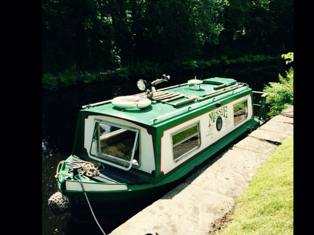

                          Found a picture of the aforesaid canal boat now………Would make a nice model?
                          #66496
                            Hi Bob
                            That's a lovely little "boat" of the narrow variety
                            You should make your daughter a model of Missie, take 6" out of the centre of my design and re-arrange the windows and Hey Prestow ! she would be pleased with that I'm sure.

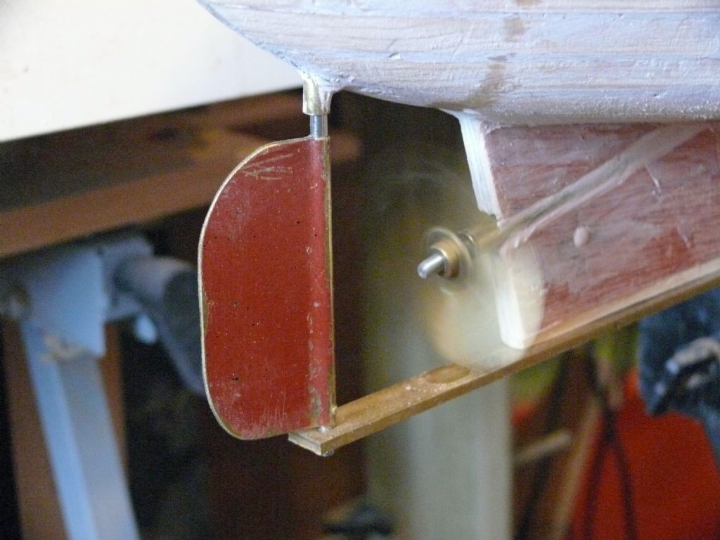

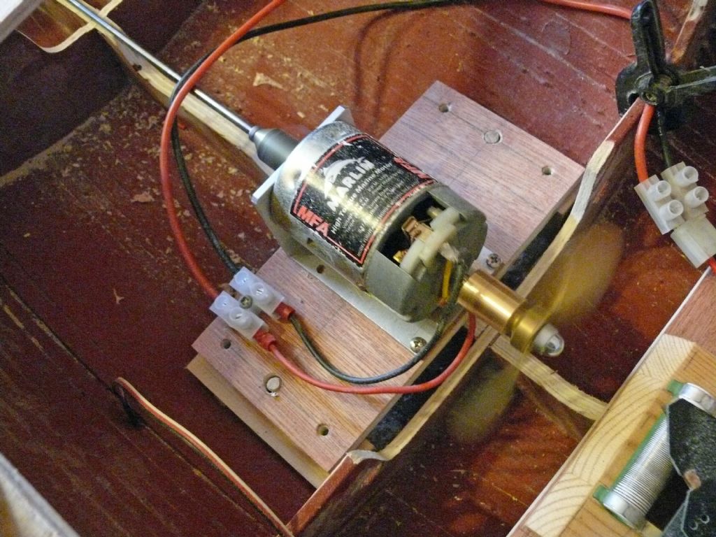

                              Just a few more pictures of the drive train, for those forum members interested?
                              Got the system more secure now and running like an old sewing machine
                              But there is some mechanical noise coming from the coupling area
                              I could fit a solid coupling or a midshaft bearing support…….Which would be more attractive………With an oil tube of course
                              Note the motor base fixing……..Screws and two dowels , passing through the hull wall
                              Didn`t fancy the usual blobs of chewing gum, all over the place
                              #66505

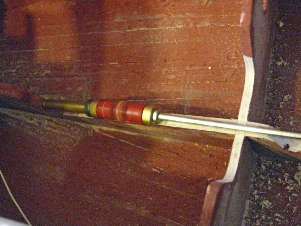

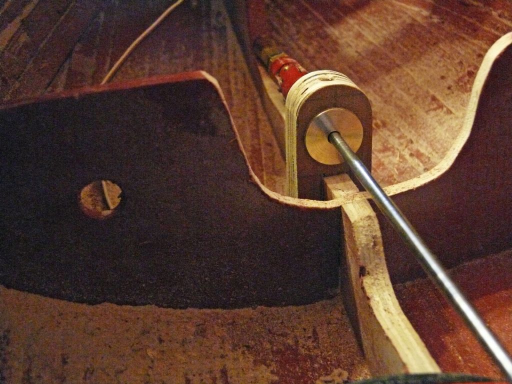

                                Problem solved
                                A bearing housing close to the loose end of the coupling has cured the noise problem
                                It was obvious really…….A flexible coupling has to have support at both ends!
                                #66518
                                  You heard it here first
                                  …………A flexible coupling has to have support at both ends!…….
                                  The ceaseless toil from generations of philosophers searching in vain for the right question, even knowing the answer is Twenty Two they still could not begin to fathom the depths of right question.
                                  Einstein came close with his theory of special relativity but even the greatest mind of our era couldn't solve this problem.
                                  And then Bob resets everything by moving the goalposts further back with his earth shattering statement.
                                  Paul wink
                                  btw I like the milkshake wizzer prop
                                  #66520
                                    Well Thomason……..You certainly missed the chance to get one over on me!
                                    I posted a picture of the unsupported coupling end and you all missed it!
                                    Lucky for me………I sussed out the answer to the problem……Without resorting to dy/dx reaching zero!
                                    Those were the days!
                                    Pleased you like the multi purpose milk shake whizzer!
                                    The cooling fan is also a multi purpose feature……..Going ahead it cools the controller and going astern, it cools the motor!
                                    What next….I ask myself?

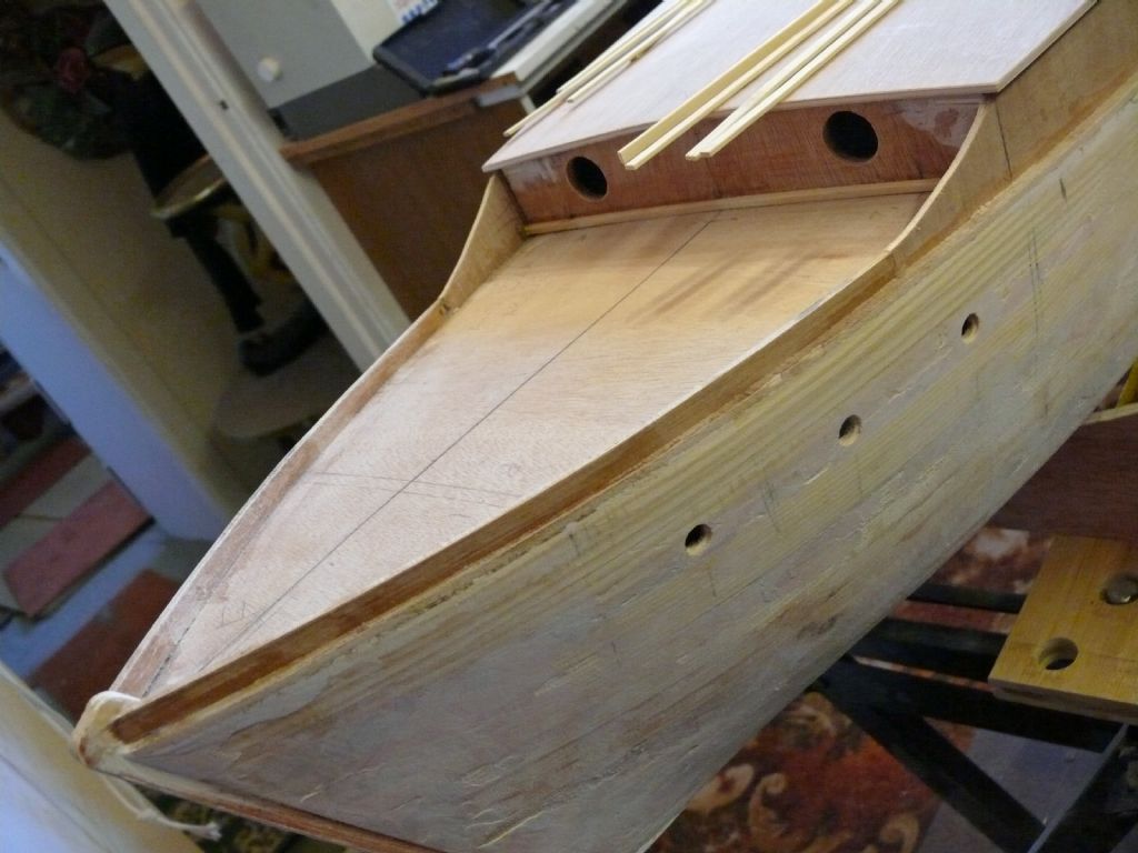

                                    #66554
                                      What's this then?………..Ian and Ray
                                      What's that, Captain?
                                      Look at the cabin side walls!
                                      Well?
                                      They extend all the way to the prow!
                                      Blimey!…….We never noticed that before!
                                      Perhaps, one of Vic's deliberate mistakes?
                                      Looks a nice departure from the plan…….And it's not too late to make a mod……….In my case
                                      Just the thing to generate conversation at the pond!
                                      Here we go boys
                                      #66555
                                        Sorry chaps…………Have I got egg on my face!………..It is on the plan!
                                        Edited By Bob Abell on 15/07/2016 08:34:09
                                        #66557
                                        Ian Gardner
                                          @iangardner62867
                                          I don't think those nice side wings coming forward of the wheelhouse front are on the plan and they may be a a nice touch- I only noticed them on the photograph after I finished building mine.
                                          I think it's always a good idea to spend time studying a plan, Bob.wink
                                          All the best,
                                          Ian
                                          #66558
                                            Hi Ian
                                            The plan is as above…….Not easy to spot
                                            I`ve found the plan a bit tricky at times

                                                  #66564

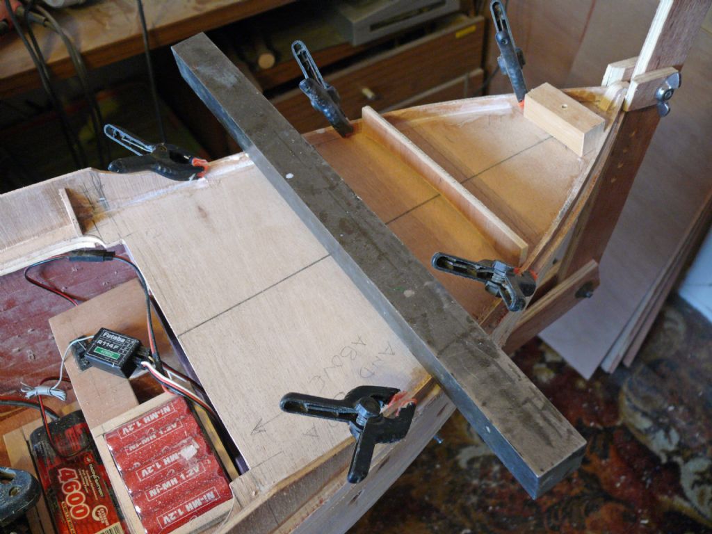

                                                    The usual Belts and Braces procedure………Must get it set right though……..All part of the fun, eh?
                                                    Good job I didn`t throw out the prow gadget!
                                                    Just the job for gripping the prow ends of the splash strips
                                                    #66571

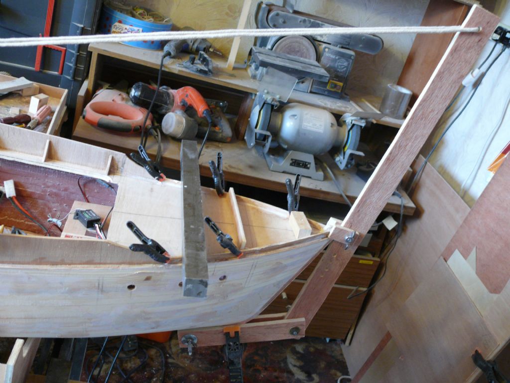

                                                      Splash walls finished
                                                      That foredeck is simply crying out to be deck planked!
                                                      Can`t really use the dark wood planks though, as intended…..Only 0.018" thick with no scope for sanding the glue off
                                                      So it`s plain white only, but don`t fancy the black oakum involvement
                                                      Hmmmmm………Ah!……Got an idea!
