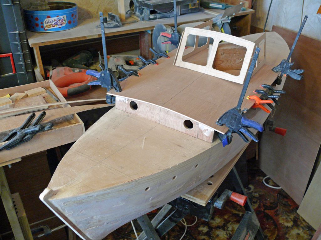

        Just a work in progress picture to keep the interested parties up to date with the latest idle chat
        Everything is in the melting pot at the moment and I`m just weighing up the situation
        Making great strides now, but don`t want to depart too far from Vics design
        Access to the motor drive, calls for a drastic mod to the main deck area

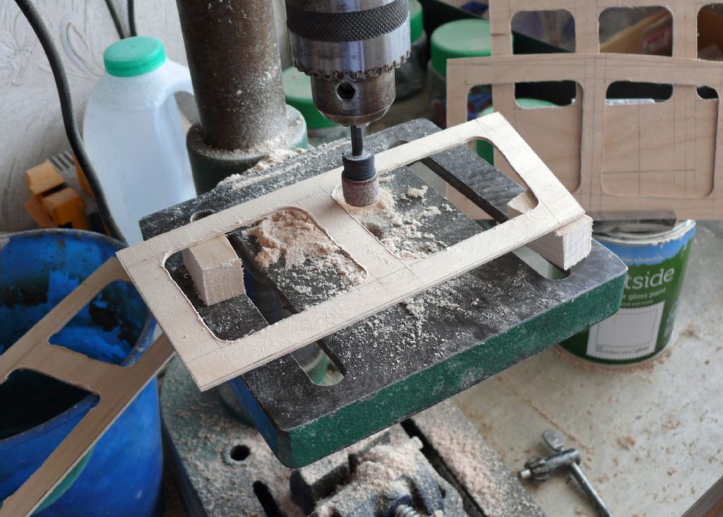

          Here`s a useful tip for cutting out window frames
          Grip a coarse grit rotary drum in the vertical drill, then use both hands to clean out the openings…..Easy
          The wood blocks are not tart of the exercise btw

            It's how I do windows- but I use a Dremel in a router table. Having just got a Proxxon saw table, which is brilliant, I'm highly tempted by their micro shaper, as it's great fun to make little mouldings with miniature router bits. The Dremel table isn't very stiff.

              Bob. I don`t do windows very often but I will file away that little gem, useful.

                  Pleased you like the window trick……..It does make life more bearable

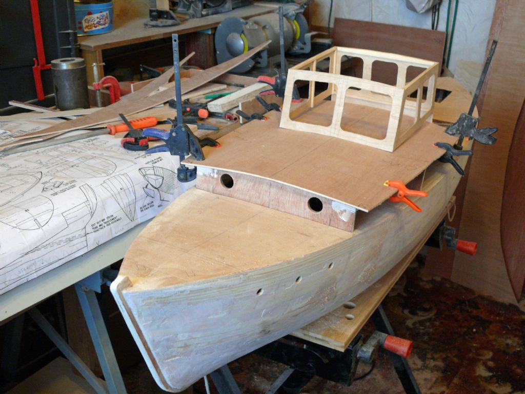

                        Work in progress
                        Seems a pity to cut through the main cabin roof, as Vic decreed?
                        Time for a cup o` tea and a think

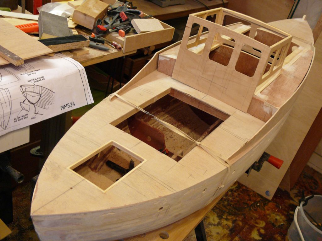

                          Rear access openings
                          The large opening just about misses the motor drive, so the cabin hatch is required afterall
                          Access to the rudder is a bit awkward too

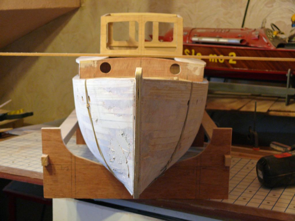

                            Have finally assembled and glued up the stand
                            Now`s the time to stand well back and look for trouble!
                            Have placed a straightedge across the deck and I`m looking for anything out of line etc
                            Luckily, all seems to be in order
                            Have decided to install the motor gear and propshaft etc next, before the cabins are glued in place and make life difficult
                            Then probably seal the hull and do a few buoyancy and floatation tests in the garden pond

                                  Is it an optical illusion or are the portholes on the R/H side lower than those on the L/H side?
                                  #66110
                                    Hello Discerning Nitpicker, Rivetcounter cum Troublemaker, Quality Control Officer……Ad Infinitum
                                    Nice to see you are checking my work!
                                    They are probably not in line……Can't imagine what I used as a reference at the time?
                                    Good job the holes are undersized at the moment?
                                    It's going to be a tricky job deciding what's what at the moment, as you can imagine
                                    The deck is probably a good starting point, when I get round to it

                                      Bob. It is a big boat. Install the most powerful motor, there is loads of room to swap them if reqd??? The MFA motor only needs to be roughly in line using a double coupling if it was the second motor to be tried, easy.
                                      ​Re portholes….make a note….do not photograph anything square on!!!!! Notice the arty pictures in any and all of my articles…are any of them square???…..wink
                                      Ashley (Not that any of my boats/cars/planes etc ARE wonky or have dodgy dubiously aligned bits, but sometimes the fall of light gives the wrong impression…know what I mean ??)
                                      #66116
                                        Thank you, Ashley……I know what you mean, but the photo was meant to show the effect of placing the straightedge on deck, to highlight any discrepances
                                        Lucky for me…..There were no glaring cock ups!
                                        It`s a visit to Specsavers now, for Paul, I`m afraid?
                                        PS……..Photoshop is a lifesaver at times!

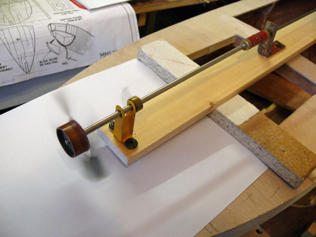

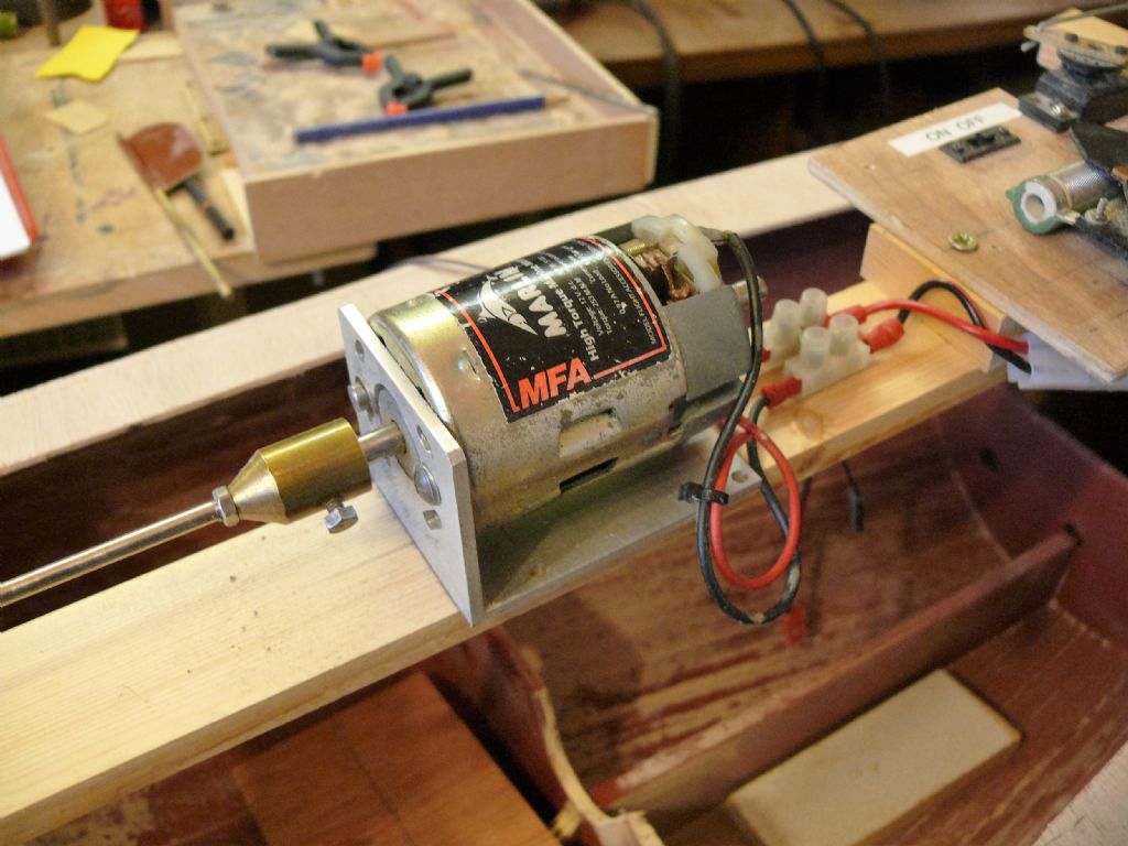

                                                #66153
                                                  Here`s something to brighten up the day and have a laugh!

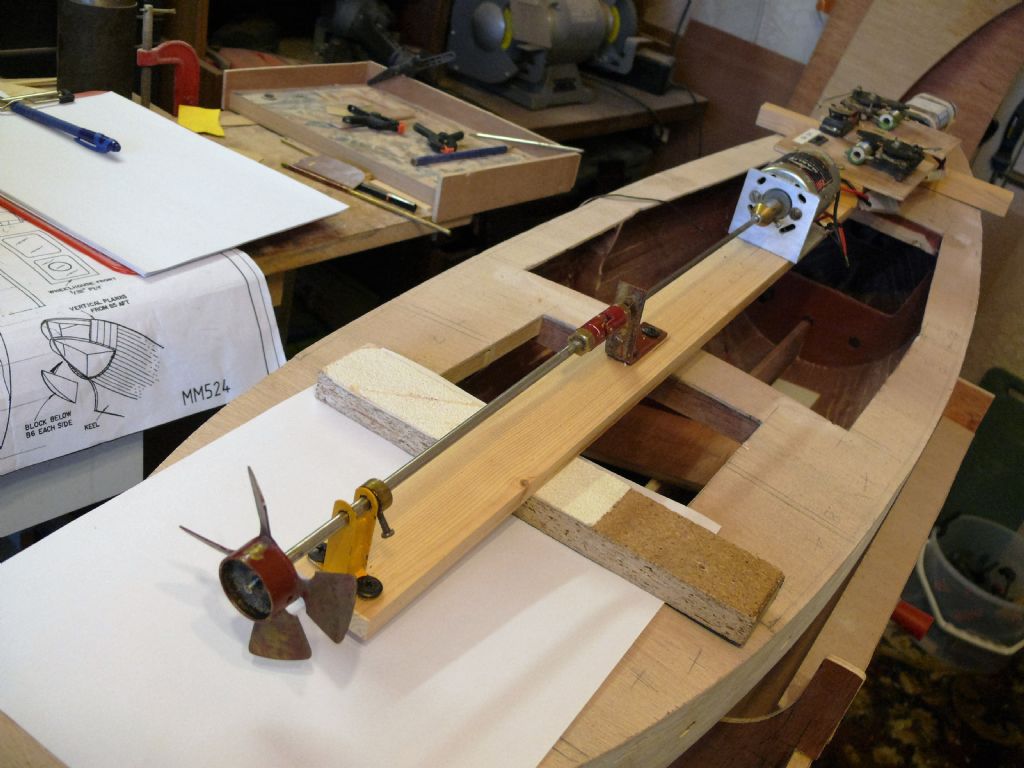

                                                  Lashed up the old MFA Marlin motor drive in order to check the system and it`s turned out…….Quite nice
                                                  I`m pleased that it runs like an old sewing machine
                                                  Also pleased that the antique speed controller is up for it too………For the time being at least
                                                  When it stops raining, I`ll try it in the pond, to test the system for the required splash factor and put the controller under a bit of load
                                                  I am aware that the setup is quite ghastly, but it is keeping with a model from yesteryear, using bits and pieces from the junk box

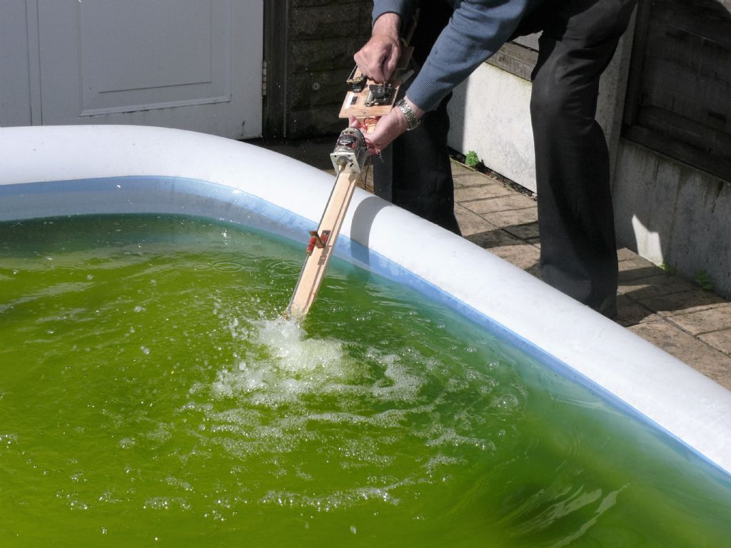

                                                  #66168
                                                    Well, it`s finally stopped raining and the pool was splendid………Nice colour too?
                                                    Lady Joyce took the pictures
                                                    The test rig behaved nicely and put on a good splash……..We can now proceed with confidence
                                                    The vintage speed controller seems OK to me
                                                    #66169
                                                      Hi Bob
                                                      That's a nice milk shake mixer
