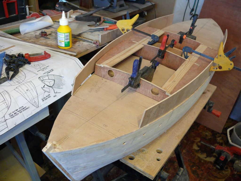

            Working on the hull deck which is always great fun and very satisfying
            #65821
            Ian Gardner
              @iangardner62867
              Looking very good, Bob. Got any plans for doing the deck?

                Hello Ian
                Thanks for looking in
                I was going to cover the deck with lining paper and draw the deck planks, but I would like to plank the deck now
                Because I've just remembered a drawer full of deck planks, left surplus from the failed galleon kit I started a couple of years ago

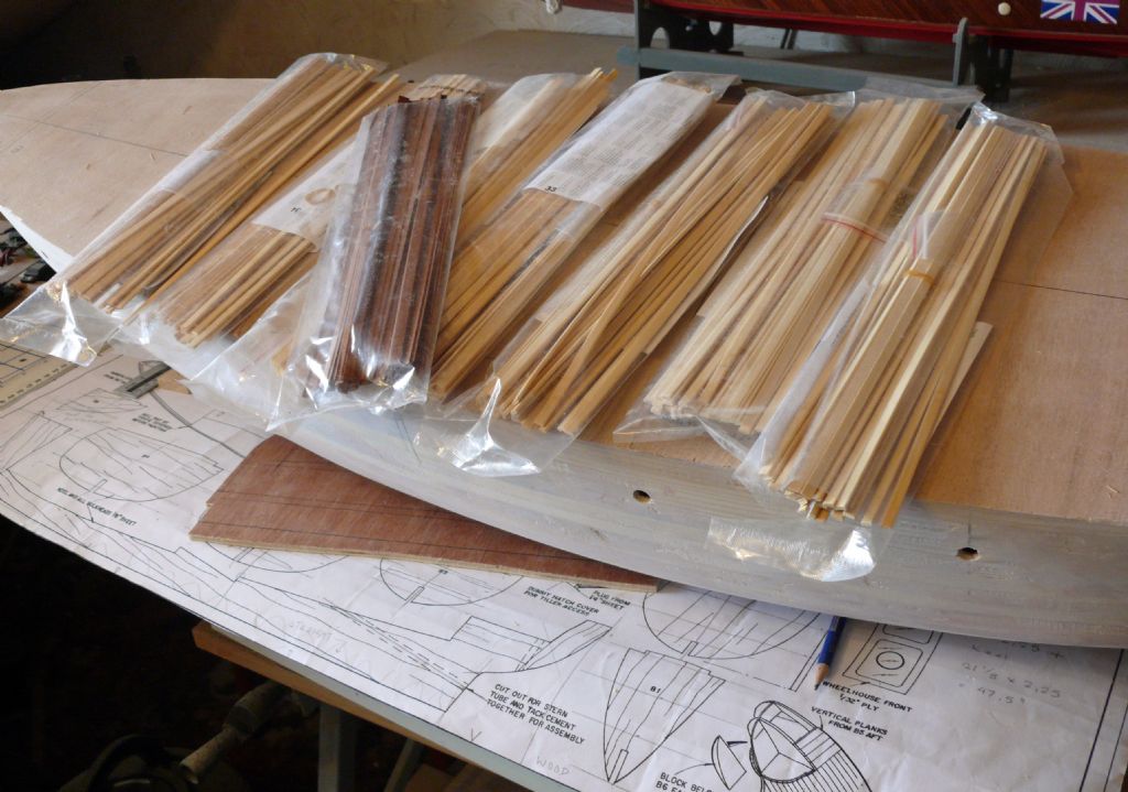

                        Ian………Managed to locate the long lost planks from the Sov of the Seas build
                        I knew they would come in handy, one day
                        So it`s a planked deck afterall

                        #65834
                        Ian Gardner
                          @iangardner62867
                          Excellent! So the long slog of deck planking begins, but always worth it in the end. I have often lost the will to live doing a deck but used to use parana pine as I fancied it looked more like teak. It was a bit harder to cut than the ubiquitous obeche. Black paper for caulking? Or do you have another method? I await with interest.

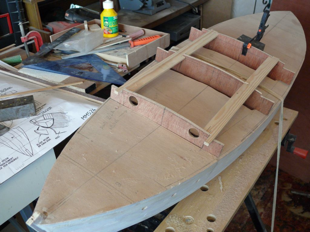

                              Using the top deck as my drawing board and fixture to hold the bulkheads in place, the cabin structure is taking shape
                              We must have cambered decks……It`s all part of the olde worlde look

                              #65880
                              Ian Gardner
                                @iangardner62867
                                Hi Bob,
                                With regard to access I made the wheelhouse and part of the deck forward of that removable- but I wish I'd made a hatch in the aft deck as well, as acess has been a bit of a problem – especially when I wanted to change motor and drive system. Just thought I'd mention it as now is the time to decide! I expect you have already made a decision.
                                It looks as though you will have loads of deck planking to play around with.
                                Ian
                                Edited By Ian Gardner on 06/06/2016 10:14:12

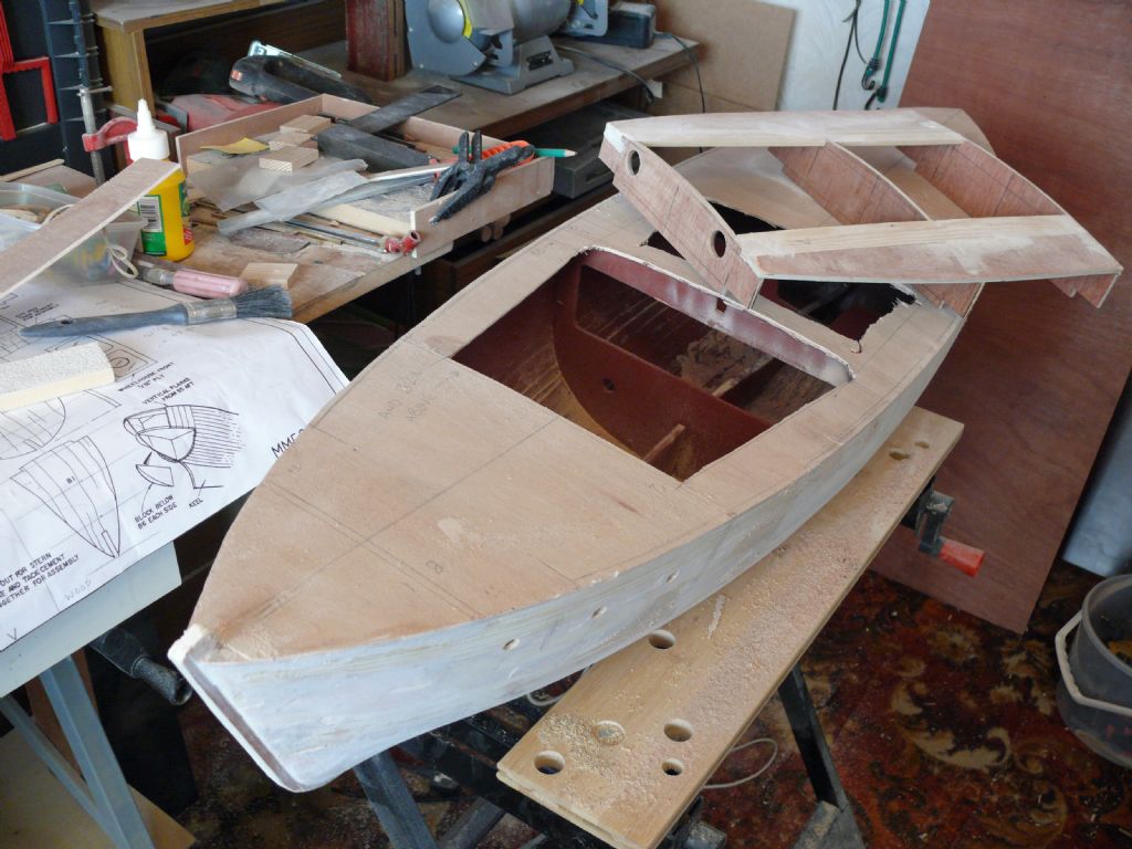

                                      The lower cabin, roughly assembled
                                      Decided to glue the cabin together, as a subassembly………Then place to one side in order to cut the top lid away
                                      Then glue the cabin in position permanently, as this section is not removable on completion
                                      Not one of Vic`s good ideas
                                      This is because the thin cabin sides have nothing to cling onto

                                      #65905
                                        Work in progress…….Mmmmmmm?
                                        The sub cabin is now glued and quite a solid structure and is a loose item at the moment
                                        I`m thinking about making it detachable, as is, with some neat method of locating the fragile spikey cabin wings
                                        Then the upper cabin can be a simple glued on item

                                            #65915
                                              Hello Ian
                                              Having read your post several times, it has finally dawned on me, what you are suggesting!
                                              Glue the bottom section down and have the top section removable, complete with bottom section roof!
                                              That`s more like it!
                                              Will look into it

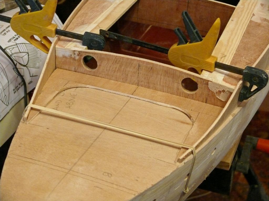

                                                    Thank you Ray
                                                    Just to satisfy an idea……I could support the wings with a double gusset as shown
                                                    What do we think?………..It has some potential, we have to think about the painted areas

                                                    #65942
                                                    Ian Gardner
                                                      @iangardner62867
                                                      Hello Bob,
                                                      I can see why you might want to go with this idea if the whole lower cabin was to be removable but I thought you were moving towards having acess in the upper deck only, as actually shown in your last photo, which would be the best option, in my opinion. In that case a more elegant solution would be to glue the the shaped wings to the deck and perhaps reinforce them with a quadrant or rectangular strip glued inside them at deck level. You could even pin them with thin brass rod and put an elegant capping piece over the top. Vic Smeed describes them as a 'foot strip or spurn water'.
                                                      I'm not quite sure how you would achieve your deck planking with your double gusset. It might look a bit odd if it was painted and the deck underneath planked. Just my thoughts.
