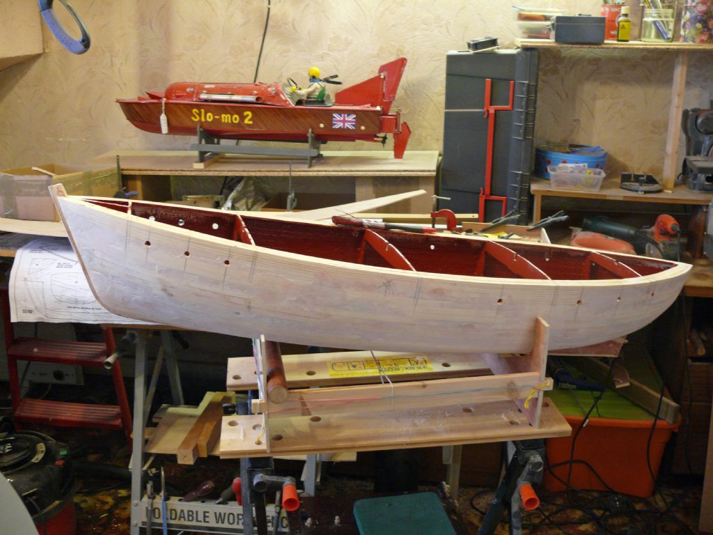

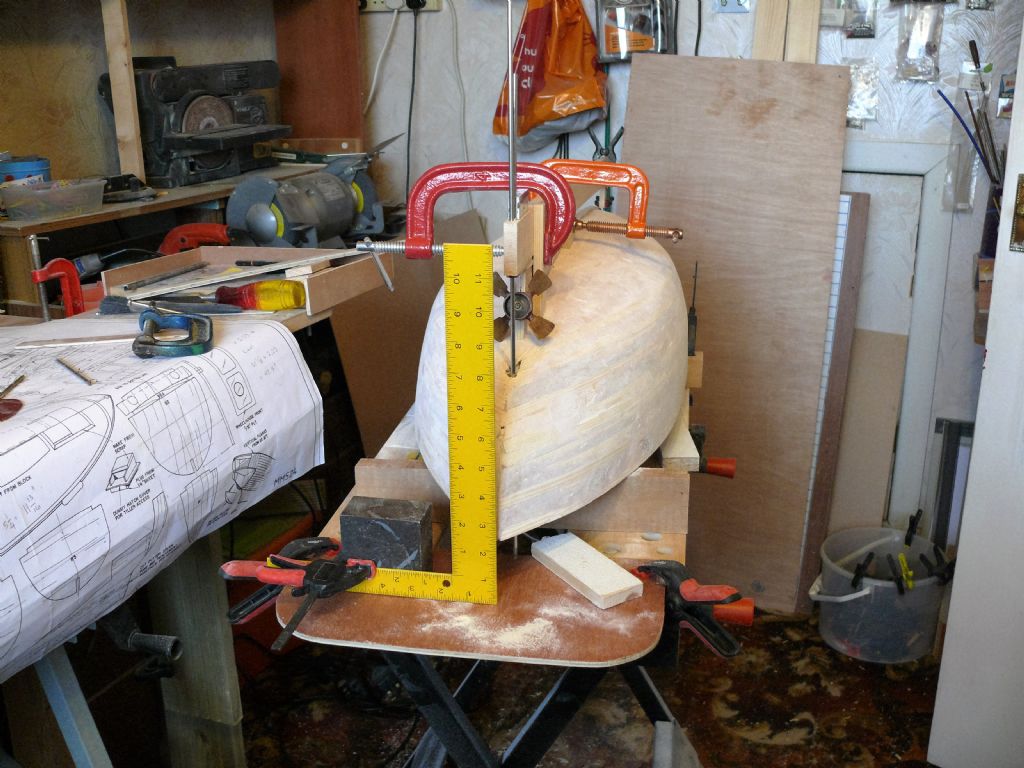

                  Work in progress
                  Does my B** look big in this?
                  Checking and adjusting the pointy tail end to be in line with the rudder axis

                    Chaps: I am larfing too much to see the pictures properly!!
                    ​Discerning nit-picker …its just toooo much !
                    I know what Bob means…a nice traditional boat like this has to have a vertical rudder. I fully agree.
                    Oddly enough I don't think any on my craft have anything BUT vertical (ish) rudders despite not being traditional, although only the Alvis has NO rudder as this is controlled by differential motor manipulation..and having said that it could do with a rudder to keep going in a straight line.
                    Are you going to use that (presumably GE) propeller Bob? or is it just there for effect?

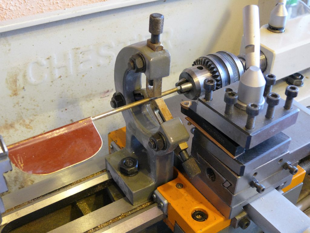

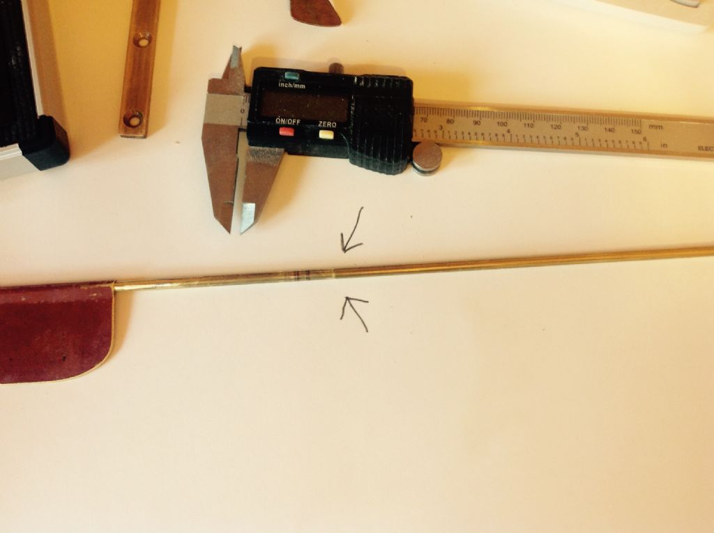

                        Ho! Ho! Ho!…….This could be fun?
                        Going to make use of an old rudder………But the rudder shaft is too short
                        Need to extend it, using a short length of brass tube
                        The shaft needs to be turned down to 3 mm…..In the lathe……..For a nice soldered accurate joint

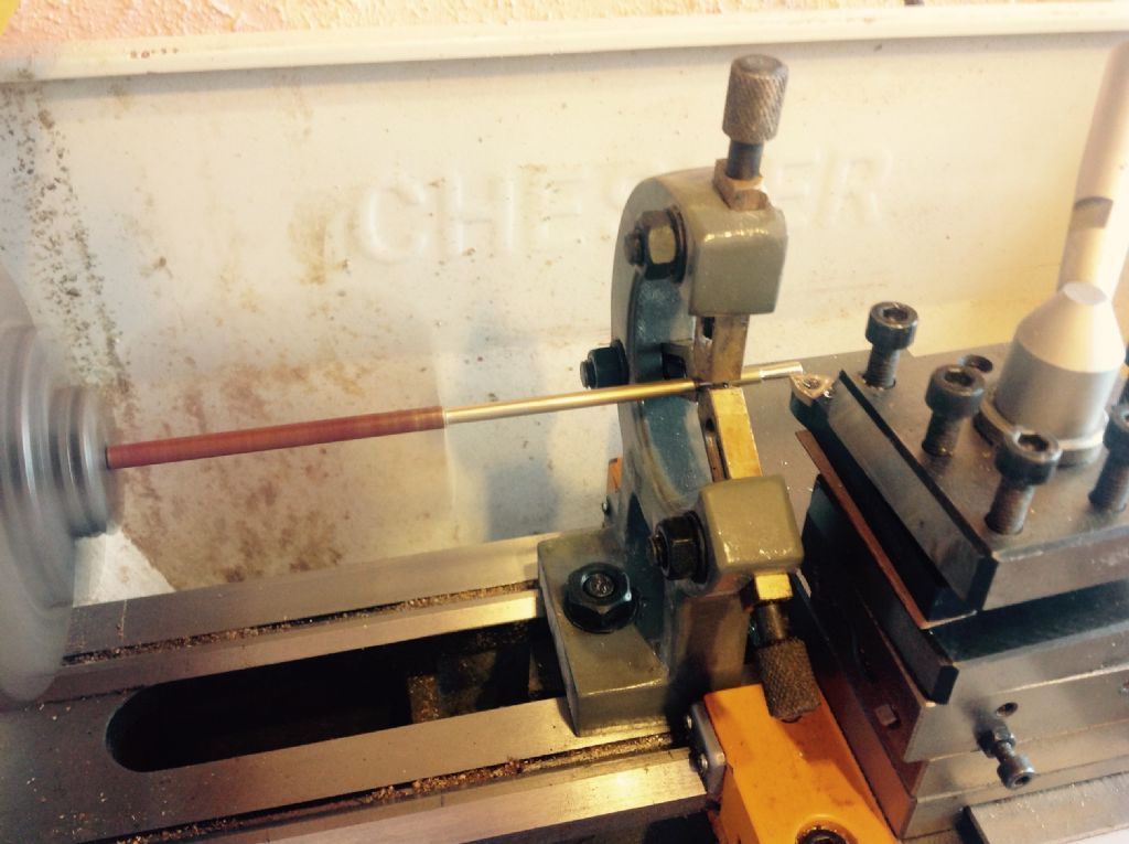

                        Due to the rudder blade being in the way, we will need to use the three point steady!
                        This is worth a look, Colin………..But be very careful!………..This could be quite dangerous, in the wrong hands!
                        Due to the rudder blade flying about!
                        This is the setup……
                        Rudder shaft in chuck with the end to be turned, loosely held in the drill chuck
                        The steady pads are adjusted to a nice running fit on the rudder shaft………Then the tailstock is moved out of the way
                        Avoid any loose clothing in the area,,,,,Ties especially
                        Be aware of the rudder blade hazard……..Rotate the chuck by hand, to ensure all is ready and safe
                        Switch on and carefully turn the shaft…….Turning a 4mm shaft needs special care, as it could dip and destroy itself
                        Eventually…….Job done

                          Part 2
                          The rudder shaft is being turned
                          For small diameter jobs…….Use a very sharp tool
                          Note the dangerous rotating blade
                          In the real world, this operation is highly dangerous
                          When I was a turner in the fifties, it was a common practice……..Turning gear shift arms
                          Sadly, I witness some ghastly accidents

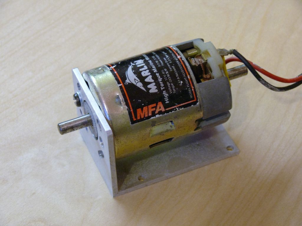

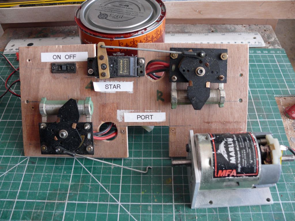

                              A club member has donated an old looking motor to the project
                              It`s an MFA "Marlin"……..Same size as an MFA 850
                              High Torque Marine motor….12 volts…..5100 rpm…..68 watts
                              Could be a suitable motor from the Good Old Days, that Vic would approve?
                              Many thanks Jimmie
                              Any good?
                              #65733
                                Bob. I think that this is what the 800/850 motors were called (Marlin) before they were called 800/850.
                                At 5100 rpm yours would be an 800 and a suitable choice.

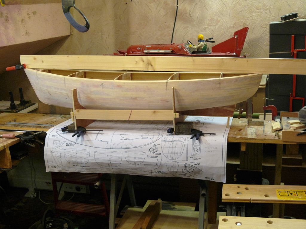

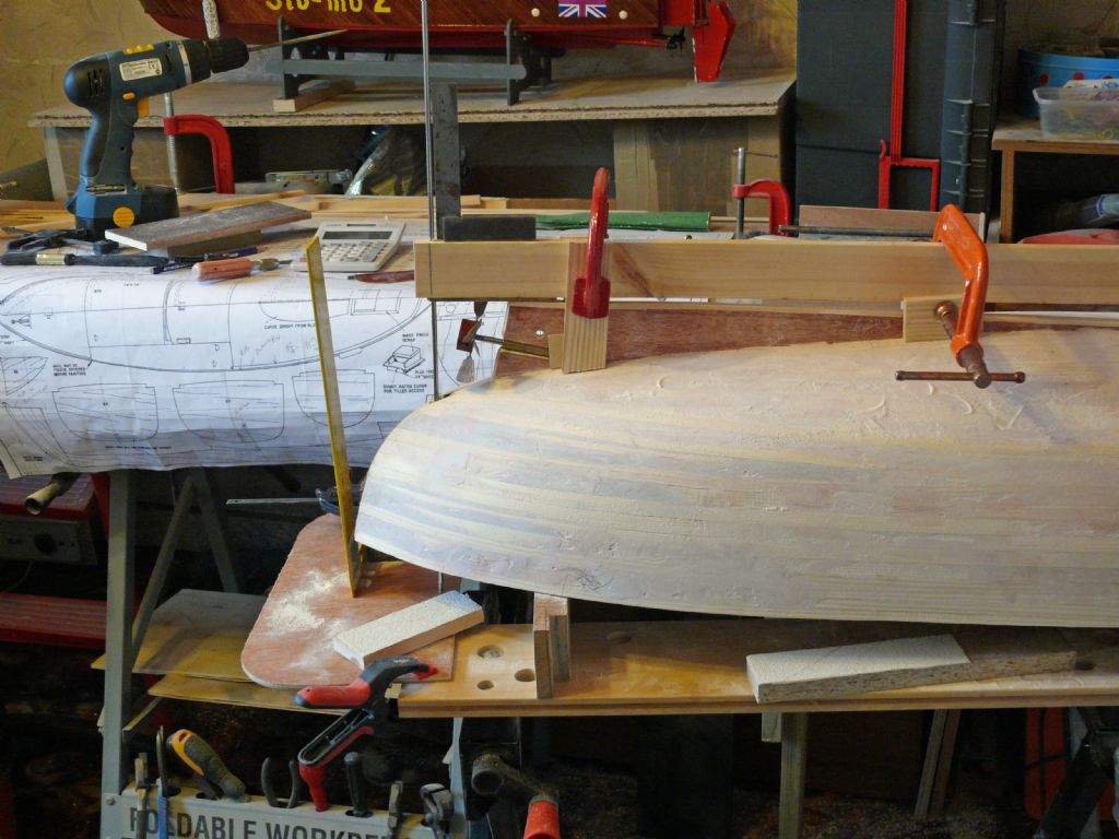

                                                Another set up
                                                Set at water level………With the keel sloping up at 1.6" and the rudder vertical
                                                It has the look of a trawler and takes some getting used to
                                                The port holes should improve matters………Tomorrow

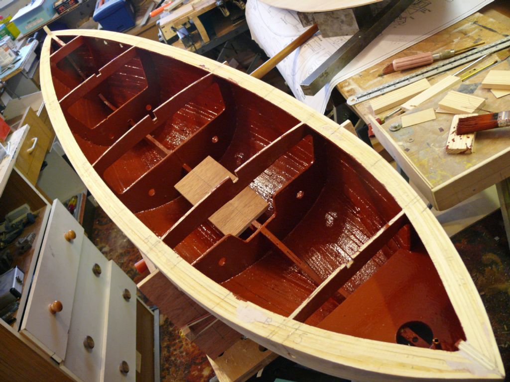

                                                  Work in progress……Progress at last!
                                                  Painted the inside of the hull, prior to fitting the lid
                                                  Quite a lot of the inside is quite inaccessible, once the top is glued in place
                                                  Did have a few more pix to post, but the Win10 Gremlins are still active!

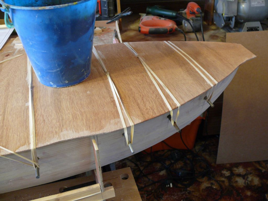

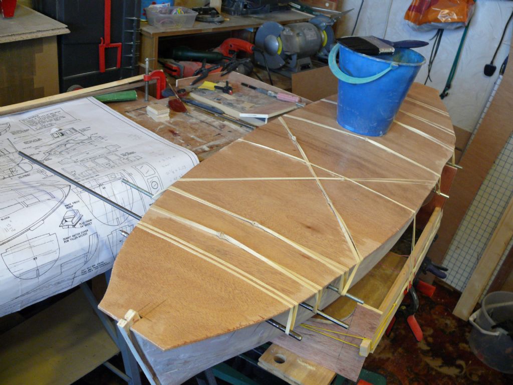

                                                    Cheap type 3mm ply offcut from the local shop……….With the grain going the wrong way
                                                    It was 3mm with a 2.5mm core and 0.25mm skins……..But it didn`t like bending, camberwise!
                                                    Soon persuaded it to cooperate though………I cut the skin underneath, with the scalpel, up and down the sheet and it was instantly pliable
                                                    Just look how handy those portholes are!……….Ideal for the lacky band anchorages

                                                    Just decided to use an old MFA BOB`S type board for the Speed Controller now……..Feel sure, Vic would approve?
                                                    #65805
                                                      How`s this for the Fickle Finger of Fate?
                                                      The controller being recycled is off a previous model…………."Starlet"………..By Vic Smeed himself!
                                                      What could be better?
