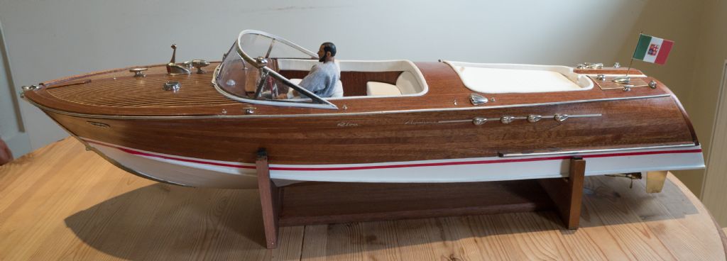

      Thanks, Martin. It is the wooden kit, planked first in lime and then in Mahogany. I agree your comments on the windscreen. I made a real mess of it. You may notice that I have left out the padding round the cockpit. One of the "improvements" in the revised version of the kit was to replace all padded leather parts by PVC mouldings. Just about OK for the seats and rear deck but the padding looked horrible. Overall, I can only think that the "improvements" were made to reduce cost rather than to enhance the model.

        I used 60 thou. styrene sheeting, suitably carved with creases and slight folds. for the seats themselves I used layers of Ureol modelling board to represent pleats and individually stuffed seat sections. More carved creases, then matt paint, buffed with a very clean pinky (little finger is the cleanest as it does the least). This looks more like leather/Naugahide/Vinyl than the real thing ever does.

          Etched bras sheet – actually it doesn't look to bad. I still thinks it's the padding/cushioning round the cockpit that really lets them down – as well as the replacement of the steel rubbing strip by a white plastic extrusion which they encourage you to paint chrome. I used their strip but covered it with an American product "Bare Metal" which looks pretty much like chrome.

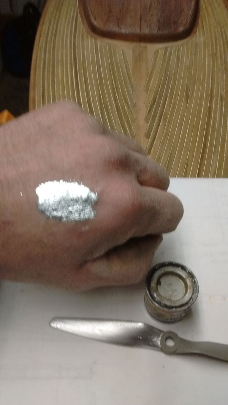

              Hi Martin I beg to differ on the paint ! I've been making airfix kits for years I've an old quality Street tin full of airfix and humbrol paints ,Ive an old tin of humbrol "chrome metal coat" it realy is chrome not just silver and no it's not metallic !!!…….mark

                      Hi No I did say it wasn't matalic I do know the difference !! Maybe I will post a pick to prove you both wrong and yes it it bright not a steel silver at all…. mark

                                Looks like mill finish aluminium to me, if it's the prop blade I'm supposed to be looking at. Chrome it ain't! Unless you wanted the look of chrome on fine sandpaper<G>
