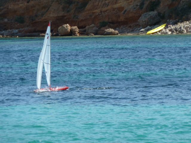

                            We have some very big holes in our International One Metres and self-adhesive Dacron is indeed the material used.
                            At this very moment I am making a new set for mine but first of all I made some templates in 3mm MDF so I can quickly and accurately cut spares. Eventually they do use their stick but how long they last depends very much on how you treat them. Always keep the backing material and if you remove a patch for any reason, immediately put it back on the backing to stop it getting contaminated with dirt and dust which are the biggest enemies. If you do this you should be able to re-use them many times.
                            The patches must go on dead flat with no wrinkles or they will leak and the easiest trick is to wet the area of the deck under the patch with water which has a few drops of detergent in it. A good alternative is domestic window cleaning fluid (not car stuff). The patch can then be slid into position and any wrinkles removed using a piece of plastic card as a squeegee. This is what the sign maker do with their vinyl lettering and designs.
                            It is very important that the edges are well stuck down and cannot catch on anything. I had a problem once where a hook on the sheeting system caught the edge of the patch and started to pull it off. Luckily the winch stalled and saved the day!
                            Here is a picture of my IOM (red one) hard to windward in a Regatta in a harbor in Mallorca.
                            Here the boat is emulating a submarine and relying totally on the integrity of those patches.
                            The boats usually have a drain plug high on the transom so it is easy to check if any water has got in and drain it.

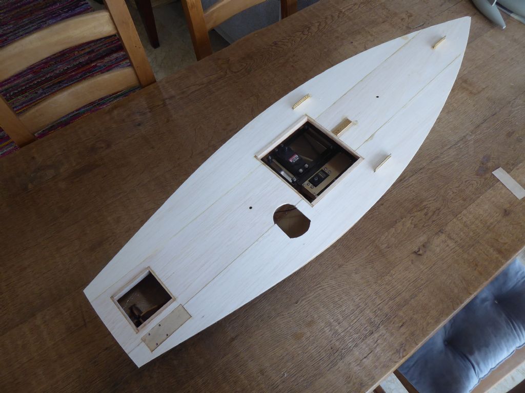

                            Here is the deck of my Galileo Resurrection. The main hatch for winch and steering servo access. It also allows access to remove the bolt retaining the keel. The small hatch gives access to the rudder stock and steering linkage. The rectangular patch is a hard point for a GoPro camera mount and the nearly round hole is for the screw top pot. The main hatches will be flush fitting and sealed around the edges with clear tape. This is much more reliable than having a hatch fitted over a coaming.
