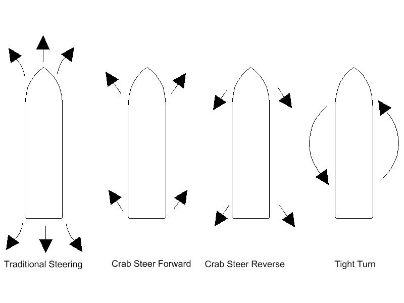

                  I'd have thought a tug would need very good if not exceptional manoeuvrability which should make it good in a steering competition as well. Modern harbour tugs can virtually spin on the spot. A good bit of oomph in the drive department should just add to the fun.

                    It's not always that simple. Models that have excellent manoeuvrability usually require constant hands on corrections whereas models with good directional stability tend to go where they are pointed.
                    In the end I have always found that it depends on knowing the steering characteristics of your model. My best steering boat had a single screw and rudder but I knew just how it would behave in almost every situation. Having lots of different controls and thrusters can sometimes make things more difficult rather than easier.

                          Meanwhile I am proposing that the model should be capable of delicate and precise manoeuvrability in the way shown below.

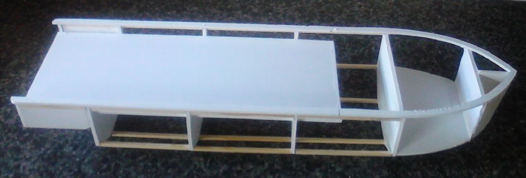

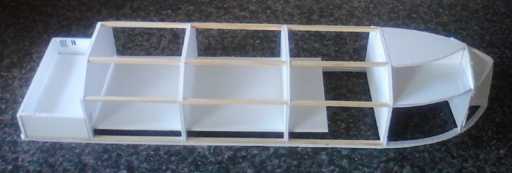

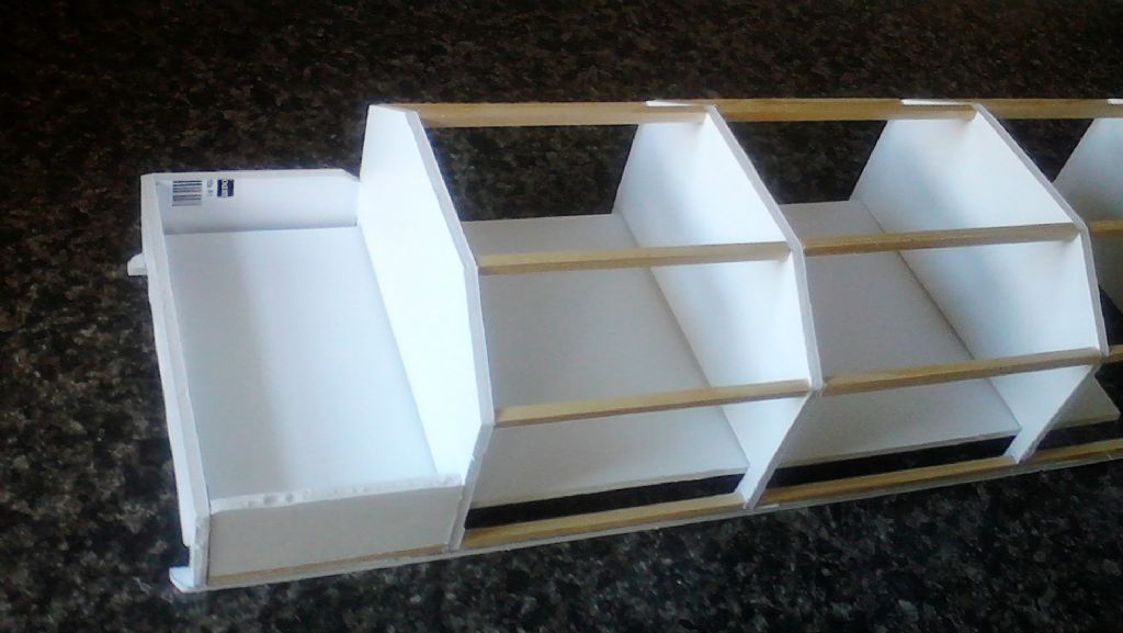

                                I have started making a foamboard prototype of a 3ft tug, the design is a hybrid of a tug, rig support vessel and icebreaker.
