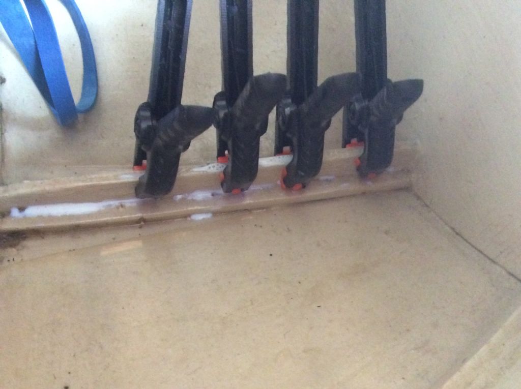

        My Wavemaster cruiser fared well on water but the long strip of ply that makes up the keel plank has drawn up water and blown apart again, this time nearer the bow.
        I wasn't sure how to address this as PVA is too thick to penetrate without dismantling, so I fed loads of that Captain Tolleys crack cure into it and clamped it. Hopefully this will bond it back together and leave it vaguely waterproof. I fed so much in from the inside that it started seeping out the bottom.
        Any other suggestions gratefully received.

          There are two thing s here. Making good the damage, and making sure it does not get wet again!! Superglue works quite well as a penetrative adhesive, or you could also lever up the bits and shove PVA in there. I would imaging the captain gunge will do ok. Make sure you varnish/seal this well when dry, and also look and see if water isn't getting underneath….

            Thanks. Bit gutted its done this as the keel did de-laminate really badly the other month but was able to split it and fill with PVA. Not so easy this time as it is right at the bow. Boat was very dry up to now. Sob sob.
            Thinking of eezy-kote ing the bottom – good choice?
            Noel.
            #74271
              Yes, that is easy and will be effective if there are any hairline cracks. Ashley

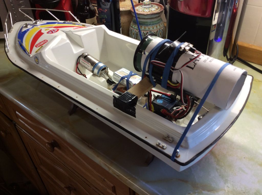

                                                    Nice to hear Ashley is making progress, and that also as above I am not the only person messing about with EDFs.  I have not been boating on a Sunday for a few weeks. Other stuff came first. sorry.
                                                    Did manage to get down on Saturday 25th for a quick trial with the EDF jet strapped on my Academy cruiser:
                                                    The jet, its battery, ESC and receiver were all added standalone and controlled from a second Tx.
                                                    Therefore all-up weight was high at 1.5kg.
                                                    Overall performance was moderate, it planed under jet alone but not spectacularly fast.
                                                    Bystanders were more impressed than I was frankly.

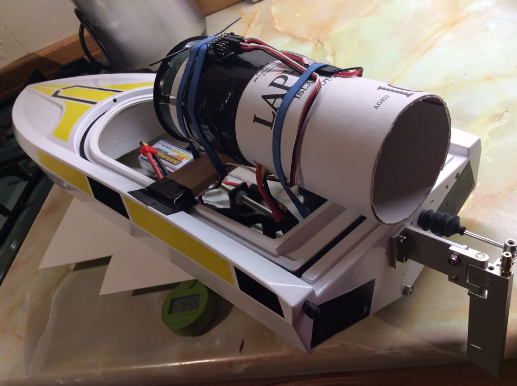

                                                    Anyway, not be put off, I've moved the EDF assembly to it's intended hull (to which I have added a rudder assembly) and this looks much better. Weight is 859g, so this should be a bit more lively, especially as the hull is narrower and therefore there's much less wetted area and friction.
                                                    Not sure when it will get an outing, but if it works well I will build a cockpit and make it look good.
                                                    If it doesn't work well, hmm, well I will just have to get a bigger EDF!!
                                                    Edited By Noel on 06/12/2017 12:20:11
                                                    #74394
                                                      Noel. Nice one, look forward to that.
                                                      I am sure its the hull wetted area that makes the difference. This is where catamarans score, as the wetted area dramatically decreases when it lifts and then the high speed of the air out the jet can get to work.
                                                      For small boats, like you have just converted (albeit temporary) a normal air prop would be more efficient, but not so much fun and certainly the unit looks the part. Peters 6 zillion watt EDF makes a fantastic noise at full chat..
                                                      We have had several goes at this down at Bushy and it is more tricky than at first supposed.
                                                      Just POSSIBLY something MIGHT be "outing" in a few months, and all that talk of wetted areas and thrust MIGHT be relevant. I say no more….
