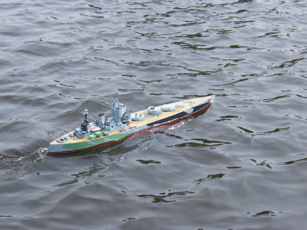

                                Bob. Picture as below of the Nelson. The ramming attack was seen by a lot of people as a valid method of offence as it appeared that the guns/armour race at the time was at a stalemate, and the ships would get so close that a ramming may well achieve a sinking, which the guns would not. By the same token, the smaller guns on the battleships ( 6 inch) were seen as providing a "hail of fire" and destroying all the upper-works and command and control, including the driving position etc due to the close fighting ranges, leaving the big 12 inch guns (or whatever) to do the big ship killing damage.
                                ​I think ships had ram-bows almost up until the Dreadnought, which had a rounded ram bow, but for hydrodynamic reasons rather than combat…so saying I believe the Dreadnought sunk a U boat by ramming.. (will check on that)
                                ​Unfortunately there were very few actual actions, and the technology was changing such that by the time a new ship was built, it had been made obsolete by new guns/armour/engines and so on.
                                ​Yes, building stuff from little info amuses me. In this case , the Sans is just a bit of fun, and there is sufficient info out there to give it a proper go if I wanted to.

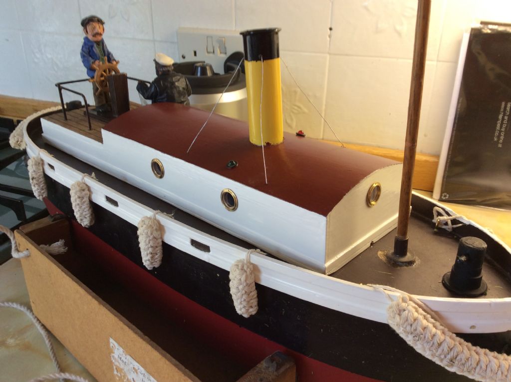

                                              Noel
                                                @noel26080
                                                This is very impressive progress.
                                                For myself I have managed to add some portholes to the tug boat, which I think really enhance it:
                                                That's about it!
                                                Edited By Noel on 29/07/2017 09:29:07

                                                    Noel
                                                      @noel26080
                                                      I thought two each side was enough as its only the engine room down there! Getting two holes lined up is easier than there anyway.
                                                      Just wants a hatch in the roof and it's done I think.
