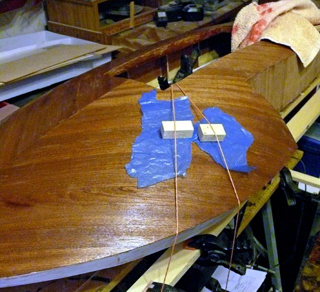

          Mixed success and lessons learned.
          One part was super…veneer flat and stuck down on all sides.
          2nd part..nice and flat…two horrid black marks on veneer due to the steel holding down blocks…presume rust or some reaction to moisture from the PVA drying. Bugger.
          However, not too much of an issue I will just sand to thin a fraction and glue another bit on..the offending part will be 0.4mm wider than the other bit, hardly anything to shout about.
          Good lesson learnt however and just as well it happened now and not on some tricky bit later on.

          #58068
            To hide the black stains, just use Acrylic paint, straight from the tube
            Recco…..Burnt Sienna, Raw umber and a touch of black……In random amounts

                    Well….. Re-veneered the stained bit…all ok. No one will notice one side is 0.07mm wider than the other.
                    Experimented with contact adhesive…
                    I have a tube of UHU POR glue which is meant for expanded polystyrene and other foams. It says spread thinly on both sides wait 10 mins and press together and I did, and the bit in question has stuck perfectly.
                    On the shelf is a tub of Armaflex impact adhesive purchased along with the Armaflex tube for the Hovervan skirt. When I first opened it I thought it smelled just like evo-stick, and it seems to be much the same..but it is a bit thinner and spreads really nice and even with minimal stringing (unlike evo-stick).
                    I have stuck a scrap bit of veneer to a scrap bit of plywood and it is all ok. Last night I varnished this bit and in the morning it seems to have dried and there has been no lifting or melting of adhesive, so this is what I am going to go for.
                    Dm says he uses contact adhesive,Bob uses PVA and I think there are uses for both types of glue. Flat sections that can be weighted down I think may benefit from PVA, but you certainly cant beat the impact stuff for curves and awkward hold-down situations.
                    The bench is in the garden and i will be polluting the atmosphere with volatile vapours on and off all day.

                      1/2 the proj no2 has been veneered now, unbelievably. Has gone on really well. Unfortunately I have the difficult bits left to do, and although I made some nice hatches and so on, the veneer means that some of them will have to be re-done. There are a few edges that will need painting or staining as well.
                      Its tricky this, the veneer is delicate and splits very easily, and the grain direction has to be taken into account when cutting and trimming or your cuts can suddenly take on a life of their own, and overhanging bits break and or split if you are not careful before you start trimming.

                          A tip from when I used to make marquetry pictures is to cover the "wrong" side of the veneer with cheap sellotape, well thumbed-down onto the surface. Cut out the shape, apply the adhesive and fit the piece, then peel off the tape. This prevents the veneer from splitting when you cut it or just handle it.
                          #58142
                            Dm thanks for that. I have been veneering outside so my roll can lay flat to prevet splitting, The end of the roll has been taped at manufacture. There is a lot to think about, this veneering lark..there is more to it than meets the eye.

                              The other two tight curves have gone on really well. veneering now finished, at least, the sticking on bit, apart from the access hatches. Now comes the varnishing….
                              Sanding this thursday eve as I am in and just possibly apply first coat of thinned varnish as a sealer, thats if it is not raining, and should be well dry for a rub down saturday.

                                  Veneering done. Tricky bits not tricky at all once you get down to it., First coat of sealing varnish on the ljkdhifhkjh and the kbndjnfkjsddf…..how pretty!! should look wonderful this boat, and yes, it is a boat this time. Proj No1 is a bit, well, and proj no3 (eventually) is sort of boatish..boatish with a twist perhaps (thats a little joke for those in the know)
                                  If I say it myself, the veneer has gone on very well, if not REALLY well. We now come to the long bit of any build, the painting. The KM Ecranoplan used one whole tinlet per coat, and I had to do it all in one as matt or satin Humbrol seems to have a habot of changing colour or matt/satin-ness if done in patches. Actually, the Alvis looks quite good done like this as it makes it look like it has been used a bit.
