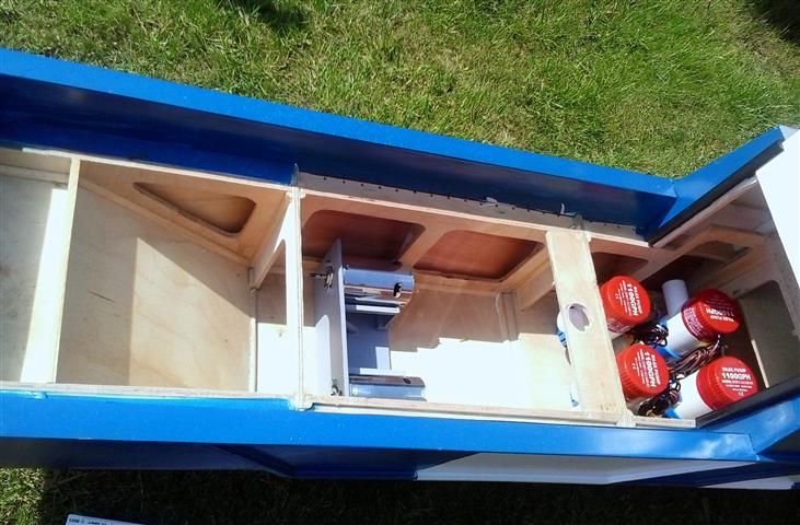

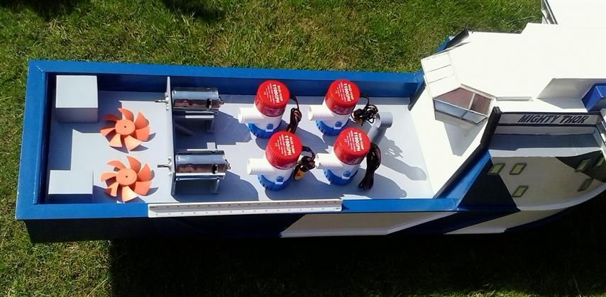

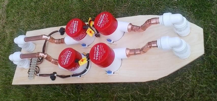

        I used these pumps in a tug, they were great for vectored steering and for additional thrust but they couldn't compete with thrust compared with the main motors.

          That is quite some drive system that you have got there!
          I expected that they would not be very efficient but if you don't ask……………

            Hi Chris
            The pumps are quite efficient and a single unit can move 1.3 litres p/second, if the outlet nozzle is restricted down to 15mm you can achieve a very good thrust, This type of propulsion is used in some bait boats
            I used them for tight steering as the vectored nozzles were far more effective than traditional props and bow thrusters.
            However the combined forward thrust of the combined props and pumps was very impressive and was capable of towing my friends 9 ton canal boat.

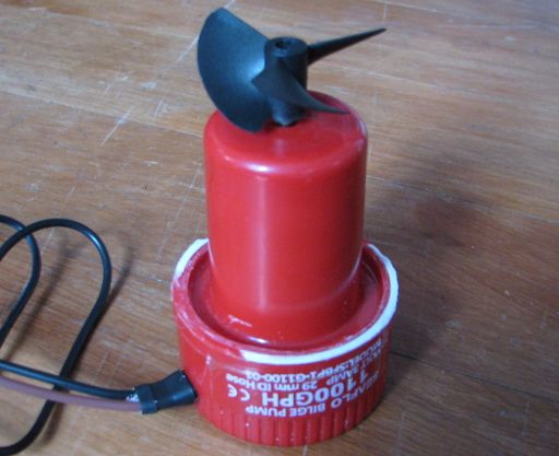

              I can well believe that they work well as thrusters.
              Some bilge pumps can have the complete waterproof motor unit removed from the housing and connected directly to a normal prop – making an azipod. The whole lot can then be used as a underwater steerable drive system. The underwater ROV crowd used them.
              #97005
                I have often thought of building an ROV for cistern inspections but still haven't got around to it.
                This photo is from LINK Tech Monkey Business
                Edited By Paul T on 20/07/2021 13:59:31

                  Thats it although the ones that I knew about had a rather more streamlined motor housing than that..
                  There are now lots of thrusters on ebay although I know nothing about how well they work nor how waterproof they are.
