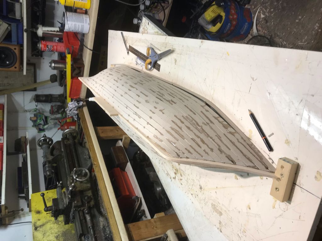

      Hi all,
      Having washed and polished my car, painted the garage door, dug various holes in the garden (all good exercise) the call of the shed was too much so I’ve started a new project after checking I had enough materials. I’ve always fancied a three masted Brig, so I’ve cut a keel and frames ready for planking. Should keep me out of trouble for a few weeks.
      Anybody else starting a new boat? (Apart from Ashley who’s in constant production!)

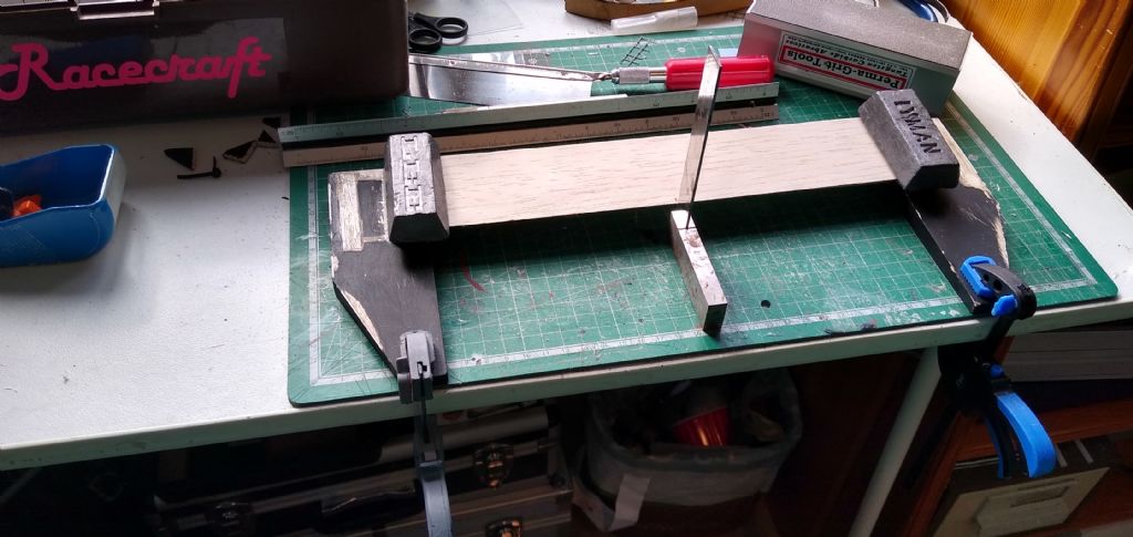

            Have been widening the beam of the sponsons on Satan's tooth pick. Now almost double the width, plus the plank of balsa ties them together now and should make it a bit more robust.
            That ought to prevent any further rollovers!
            #86339
              Noel. Yes, those weights will keep it stable!

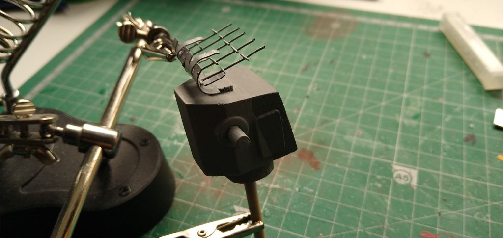

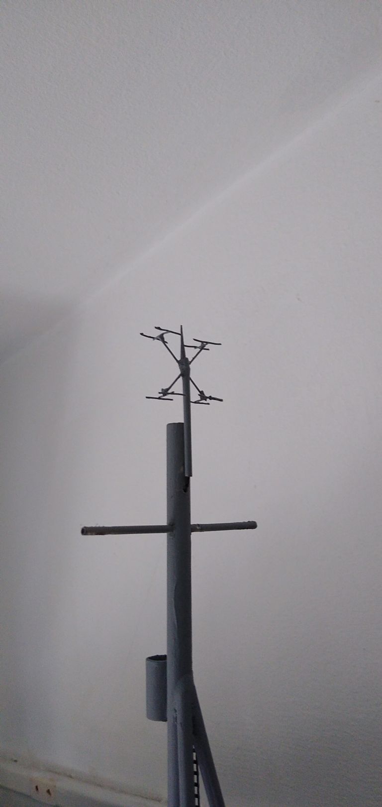

                  Have been making radar aerials.
                  They are not exactly fine scale but look correct from 10 feet away (like the rest of the vessel!)
                  Type 285 and 291 respectively.  Now I have to do a MFDF antenna for the destroyer and that will be its major fittings done.
                  Edited By Noel on 02/04/2020 14:00:06
                  #86426
                    Solder, brass wire?
                    Should look effective on the water. Good work!
                    Bought a 1022 radar kit for the 1:96 Manchester, but there were so many small bits I gave up. An adequate (on the water) Ariel was achieved with aluminium mesh and a few bits of card..

                      Radars are done from bits of wire mesh chopped into little H sections and soldered to pins, and some aluminium cable clips bent to form the reflectors on the 285 yagis.
                      The 291 X shape one is then glued onto the inside stick from a cotton wool bud.  These are useful as they are hollow and can slide over a mounting spike (and can be removed  to avoid damage in transit), but are also a little bit bendy so will flex when knocked rather than snap off.   The yards on the tripod mast are the same, the bit of flex saves them from breaking whenever you nudge them.

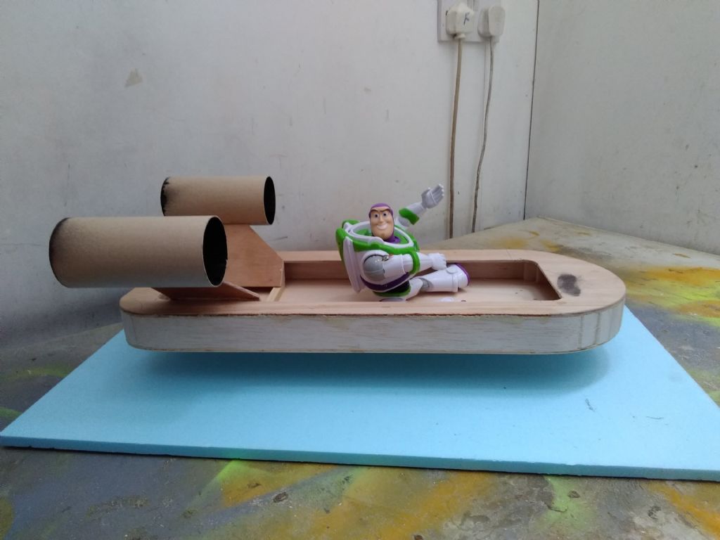

                          I have joined in with the Bushey Park Toy Story theme and decided Buzz would get the pick of the toy box.

                            Ah! To Hampton Court and Beyond! (maybe even as far as Twicknham…)
                            #86455
                              He wont be smiling when you put that in the water!!!!
                              Levitation….cool.

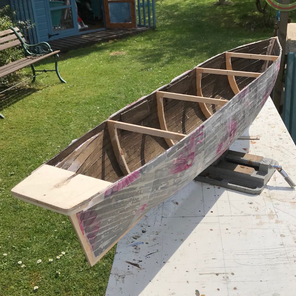

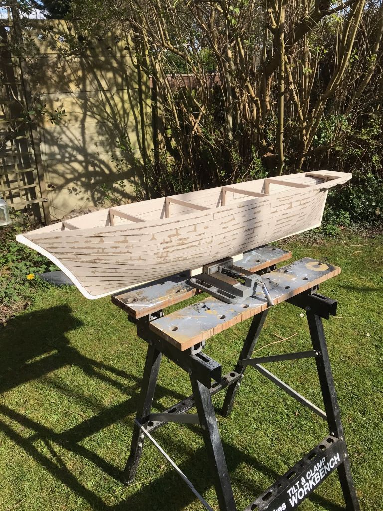

                                I think I might’ve peaked to early as I’ve run out of materials to go any further, still it’s something to put on the ‘to do’ shelf.

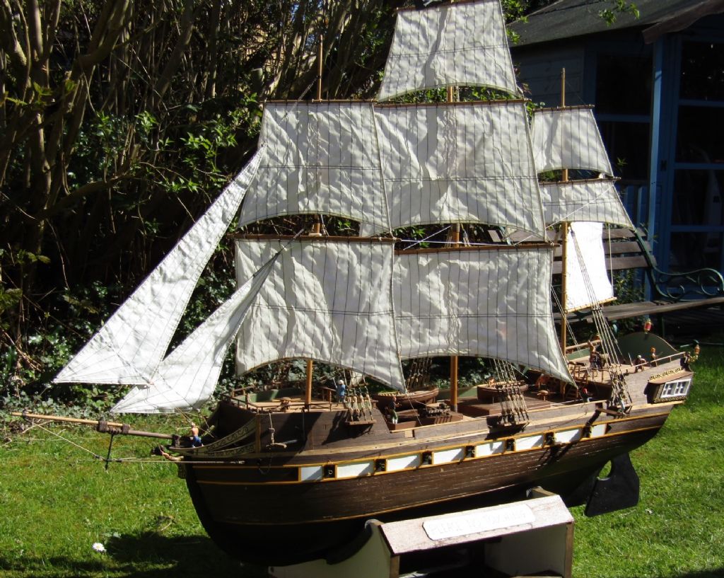

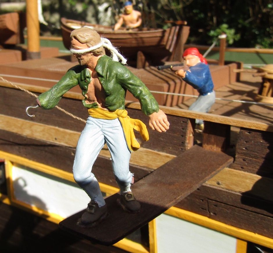

                                  Had a little photo shoot today with the Galleon sporting it’s new livery, should make it stand out more on the water.
                                  The ex captain still refuses to jump!

                                    Nice Richard. I see you are going for a "London" look. Hull looks good, nice shape. No prop?
                                    Shame about the materials…what have you run out of?? I think on-line deliveries are continuing.

                                        Will be fitting a prop shaft once fiberglassed.

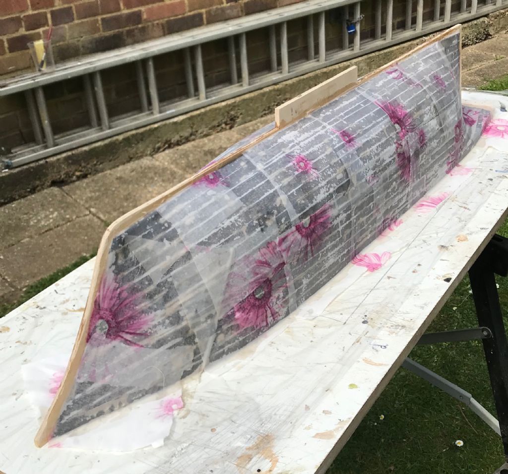

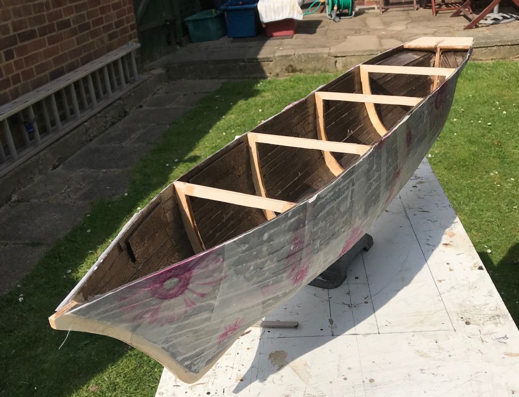

                                                BriggBriggPerfect day for fibreglass and yes, those are flowers plastered all over the hull! Having no access to my local fibreglass shop an old cotton duvet cover did the trick. A test piece was knocked up a few nights ago just to see.
                                                The fine weave worked well and it should be nice and watertight, the next step is a thin layer of body filler then another stint rubbing it all down. It’s a lark this boat building!

                                                  Richard..a quick sand down and varnish eh? Seems a shame to hide that nice pattern..😎
