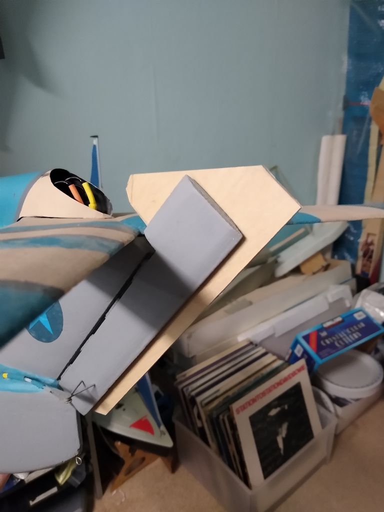

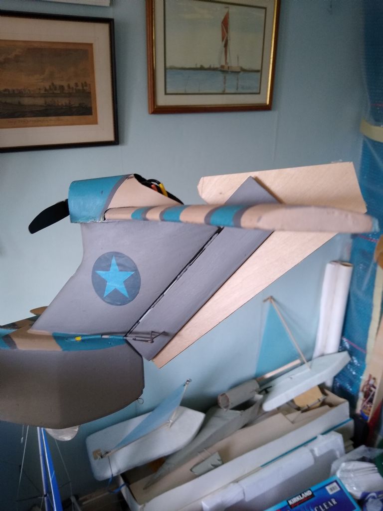

                  Motor I fitted is 2060kv, not 2600, and that was still plenty of revs on 3S. And speaking of ekranoplan, here is proposed enlarged rudder on mine:
                  Too much or just right?

                    Wow! Noel, that’s got its own postcode!
                    maybe a tad taller but a bit thinner so it’s in keeping with the original would look better, just a thought, your call.

                      Yes it looks a bit big in that shot.
                      Can't really be any taller as it won't look right sticking up above the engine cowl, but I wanted some more meat to it up the top where its in the airflow of the prop. Maybe I could chop off the last 25mm or so that sticks out the back?

                          Even more impressed Noel; if only 2k Kv. I would add about 10mm as a strip on the rear and perhaps 12mm or 20mm as an extension to the top…either square on or triangular to keep the top level. That would keep the look and provide quite a big extension to the surface area. I don't think there is scope to have more rudder throw, its about max at the moment.
                          Its funny, mine steers ok ? But I suppose any deviation from the original makes a difference.

                            Toned it down a lot. Looks a lot more in keeping:
                            Will try a horn with multiple holes in it so can adjust the throw a bit.

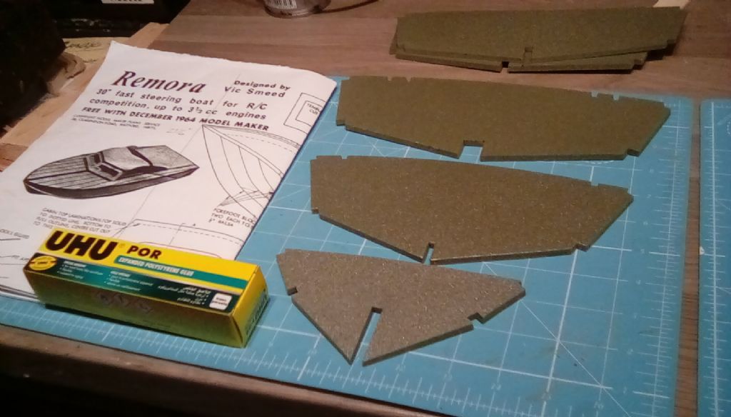

                                      Hi Ashley,
                                      It has revolutionized model aeroplane building, half the weight of balsa construction, the white depron in the smaller thickness say 3mm & 2mm has become rare not sure why but Vitrex floor underlay for laminate is the same stuff only grey & 5mm thick 10 sheets from Home base only £17.99 = 9metres square !! Bends & rolls easily, glue with UHU Por or epoxy 😀
                                      I started cutting out the bulkhead s for a light weight Remora to be glass clothed & water based resin as an experiment.
