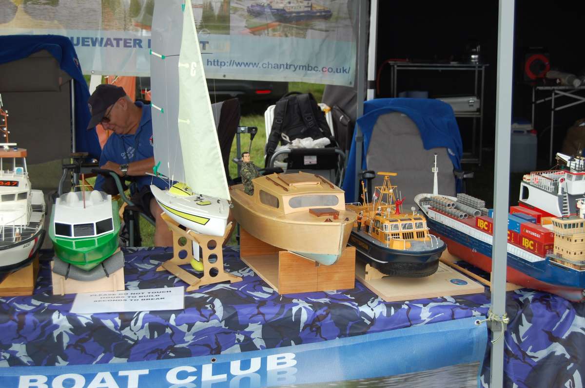

      The weight of the is still going to be a mystery ! once I have sealed the hull I will find how much ballast it will need, watch this space, the ships wheel just arrived from Cornwall model boats, I’m not painting her till after the Southern Model Show on the 30th & 31st August the tug will be on the Cygnets stand on Saturday and the Chantry stand on Sunday 🙂
      It’s probably the biggest show of model boat clubs of the year down SouthHeadcorn 1Headcorn 2Headcorn 3 here in Kent and with RC flying , cars & trains something for everybody 🙂
