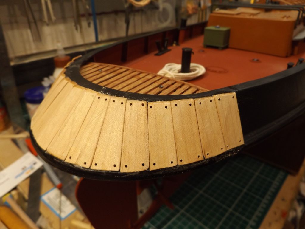

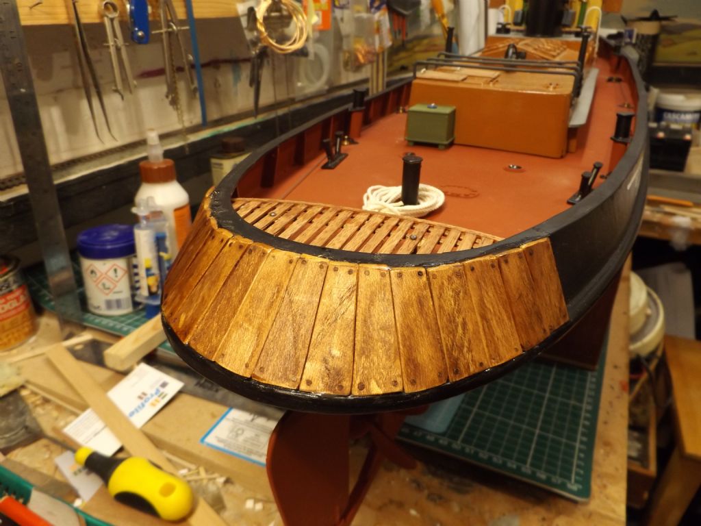

      cullamix stern 011117 001.jpgHi All
      The end is in sight ! well at least the stern rubbing boards to allow barges to rub on the rear of the tug. the tapered sections expoxyed in place individually, I guess this would be replaced regularly on the fullsize so went with a rustic look not joinery standard, drilled no.57 size holes and cocktail sticks cut as pegs & stained Burmese teak, I think it looks ok. Ballast/bath time soon

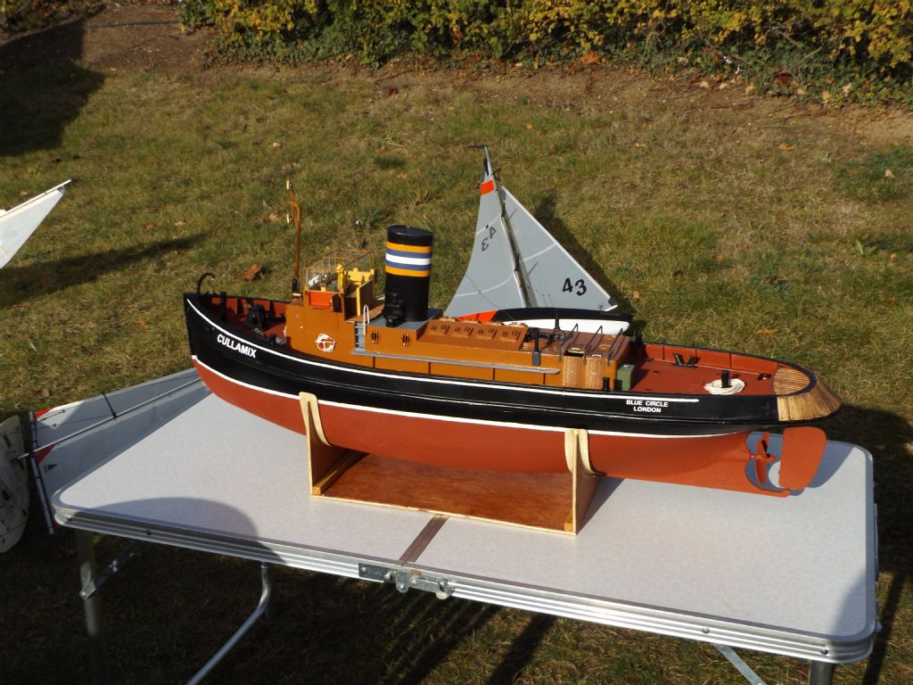

        That's all for this year ! moved onto re-organising the workshop and little 30"bluewater 051117 004.jpg Giralda Thames Sailing Barge
        Cullamix made it down to the lake on 5th November, but still needs lbs of ballast installed and the radio fitted, launch date March 2018

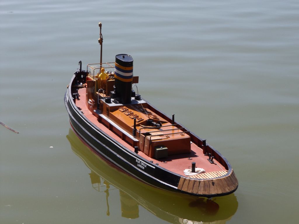

          cullbw1.jpgHi All,
          Just to prove she floats! and to complete the thread, Cullamix on the water on Saturday morning, must build a barge for her to tow now
