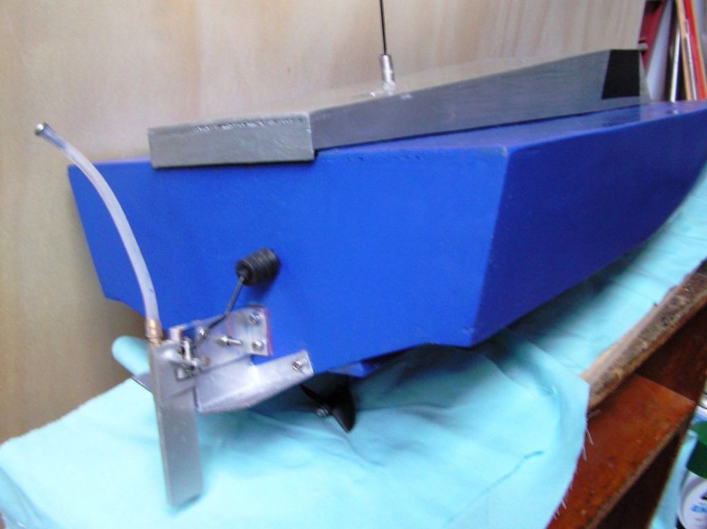

      The rudder was a bit small and I set it to low on the stern, so I added a home made fixed trim tab extension today(see my ABLUM (blue boat).

          I testing the trim tab setup today, it made the boat bury the bow on the turns.
          I am raising rear of the tabs up and trimming a bit of the sizes.

            Harry. Picture ??? Ashley
            #57395
              Blue Boat pictures added today
              #57398
                Harry……I hope you don't mind
                I've posted one of your photos, to help you out

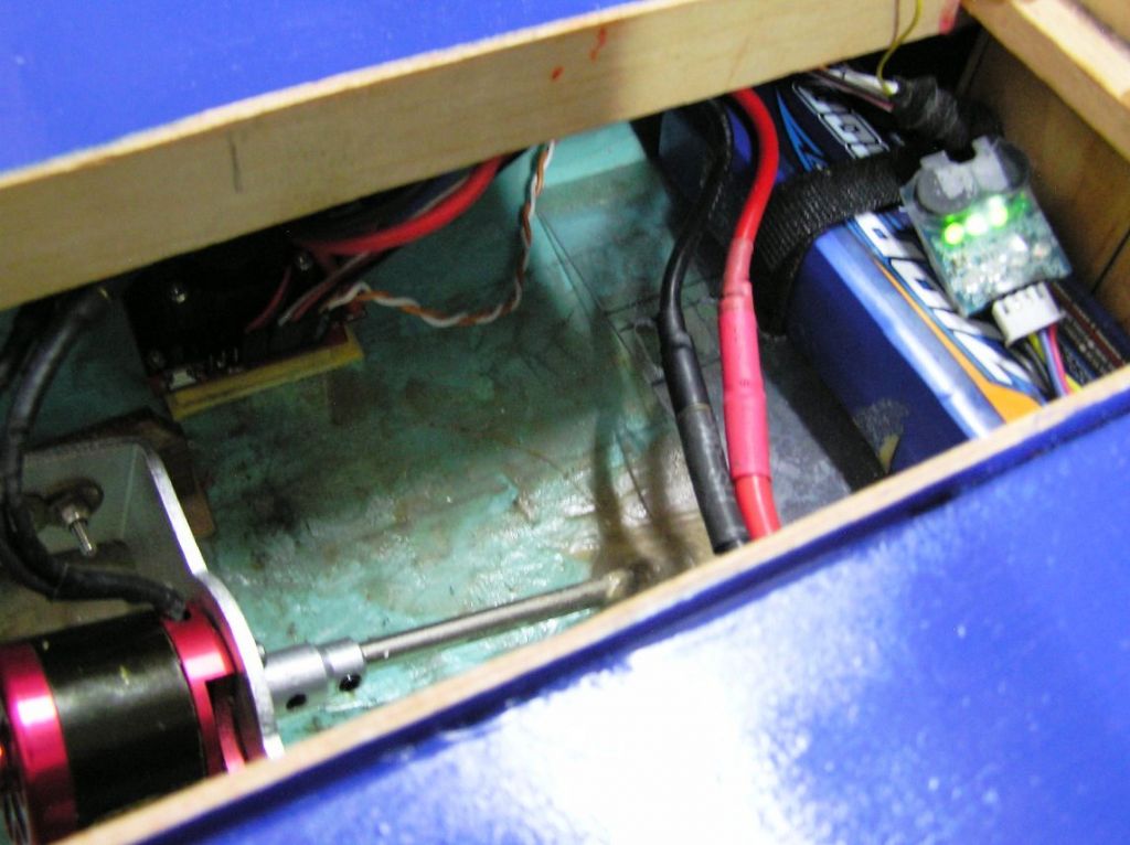

                    Hi Ashley
                    The prop is a Hobbyking HK_2B01x38(dog drive) from my other boat as the 3639-1100kv motor.
                    As for the under water prop setup it was from the original hole drive line setup for the boat years ago.
                    The young chaps(grumpy old men now days) got it right to start with!!!!
                    The setup under water gives a more constant drive in rough conditions,but, in flat conditions the surface drive is faster.
                    The boat runs very well on this setup for it's first run and other than the rudder setup I was very happy with the boat balance and ride.
                    The large spray rails work beautifully so if I get around to building the Swordsman Mark H she will have large spray rails.
                    The mount motor is a Hobbyking 100 mm wide aluminium which with the slotted motor mount holes will hold smaller and larger motors than the 36mm.
                    Also a very good heat sink, I run the boat hard for about 1/2 a hour and the motor was only warm.
                    As for the rudder well it was in the spare parts.
                    Next to test when it arrives is a D3548/4-1100kv 910watts which will handle 3-5S Lipo batteries.
                    I will go 4S as the ESC handles 4S(4000rpm added) but not 5S.
                    I do not wish to over power the boat for the grandson, but, I have a B36.50-07S 5000kv 1100watt 2-3S motor to test.
