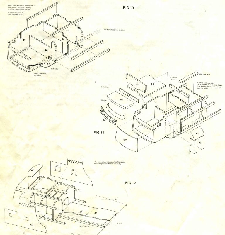

      Hi all I’ve manage to nearly complete upper deck structure and have a question. How do I form the curves over the bulkheads behind the open bridge. I’ve formed port and Stbd doorways out of solid balsa but not sure how to attempt the piece I’ve mentioned any help would be much appreciated KR Gary

          Hi Gary
          The Precedent kit boats had a one piece thin plywood precut sheet for the outer skin and two frames behind the wheelhouse.
          The Aft section was made separate and glue to the forward section.
          Harry Smith
          #80316
            Hi Gary
            A picture from the build booklet.

              Harry that’s brilliant a picture does it for me. Alway get a great response from you guys on this site thankyou very much ☺
