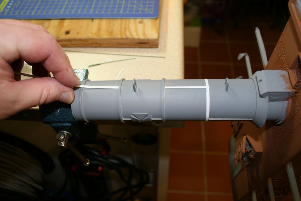

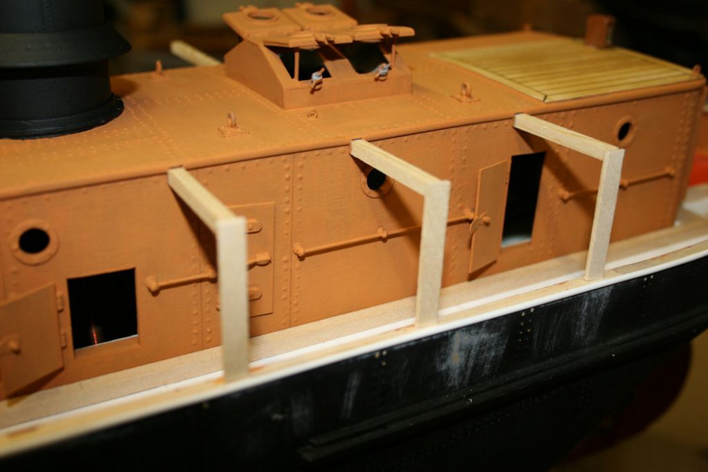

                        Hello David Howe
                        A few years ago, I built a large model of the PS Great Eastern and I also fancied the "Riveted steel appearance"
                        The model was 7 feet in length and a plain painted black hull needed the touch of antiquity?
                        I used thickish card about 0.018" thick and in strips about 18mm wide and about 12" long. For the rivets,I used a blunt spring loaded centre punch, for rivet size consistency;
                        The card was glued to the hull using PVA
                        When dry, it was a shear pleasure to paint the hull with semi matt black paint
                        The effect was splendid
                        Photo`s to follow
                        #93396
                          The GE rivet photo`s……
                          You may ask any questions if necessary

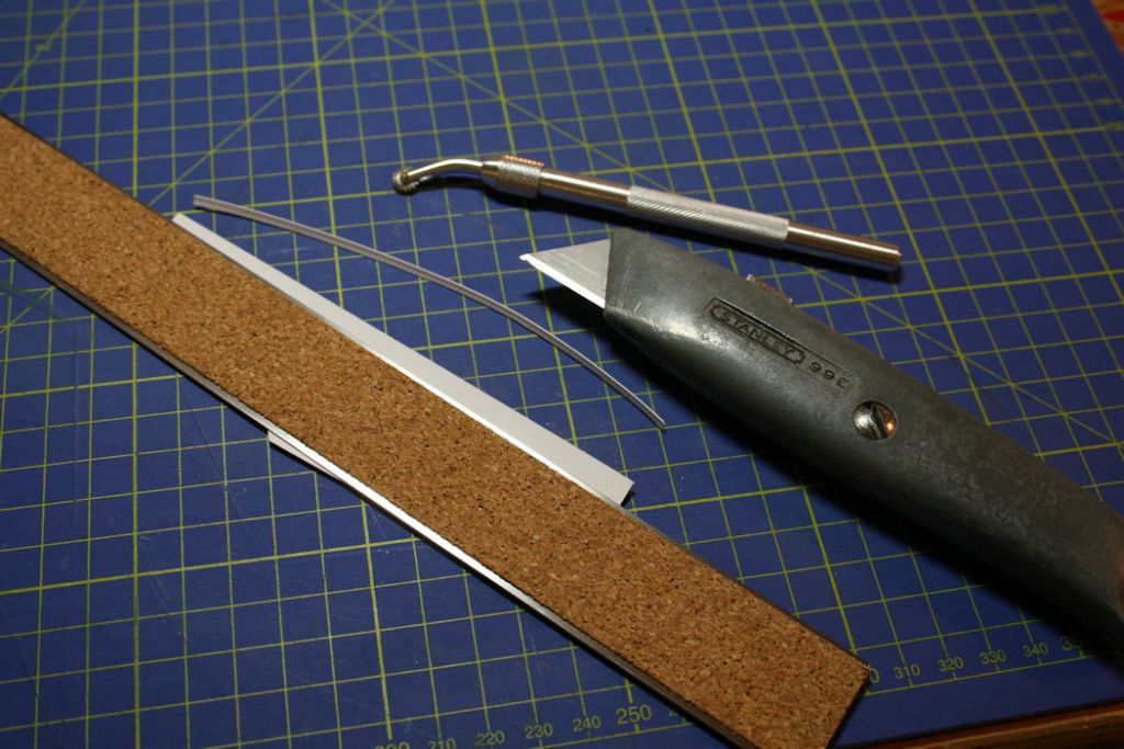

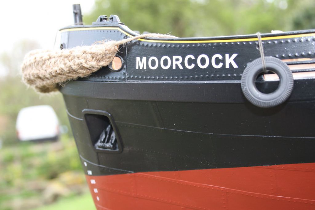

                                Just some other ideas for the pot.
                                The Moorcock, built by Mr Keith Heyes, was completely plated by overlaying printer's litho plate over the hull. The edges of the plate were riveted by "Pounce" or "Ponce" wheels, as per Neil's sewing suggestion, from the rear before glueing them on. You can buy them in sets, usually of three, which will last a lifetime.
                                For strap joints I have used the same ponce wheels to make riveted straps in heavy paper. Again simply roll the wheel across the paper, cut and glue to the model. One or two rows of rivets are just as easy.
                                Finally I did this one with spots of cyano gell. You can't do it directly to the fibre glass as it soaks in and you don't get a nice 'blob' but if you prime it first the gell forms a nice neat blob on the surface.
