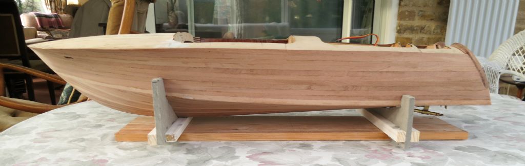

        I have seen videos of model Amati Riva Aquaramas ploughing through the water, almost submerged in their bow waves. The prototype Riva has spray rails along the chine and I wonder whether the model should also have them (although they are not included in the Amati kit). If they should be fitted, I would appreciate advice on how far forward they should go and on the ideal cross-sectional dimensions and profile. The hull is 1/10th scale and 876mm long.

          I don't think that the boat had spray rails, at least I haven't come across them on any Riva boats that I have ever seen.
          Your model is looking very good and should look superb when varnished, your woodwork is tremendous.

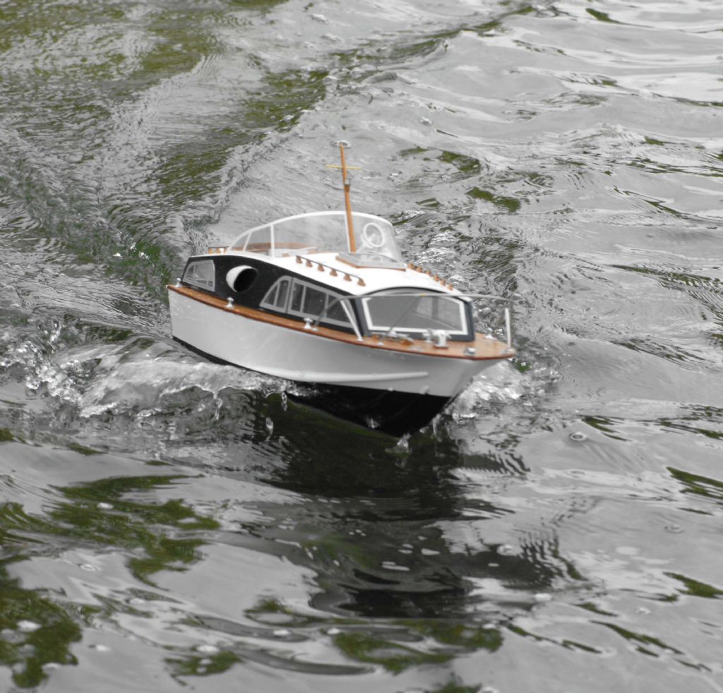

                From my experiences with Fairey power boats and similar I'd say that spray rails at chine level are pretty much mandatory. I would suggest a square section with the lower outer edge left sharp and the upper one rounded; size maybe 4mm x 4mm. Leave the bottom face unshaped so that the water is deflected downwards as well as outwards.
                This should give you a good idea of the efficiency of spray rails in keeping the boat dry.
                For material I use bass stripwood which is quite soft, fine-grained and easily bent with application of steam.

                    I think that 3mm square would probably do; the size I quoted is pro-rata with the smaller Huntsman in the picture (which uses 3mm sq). Quite where you end them at the bow depends on you – under the headlights looks like a suitable sort of area.

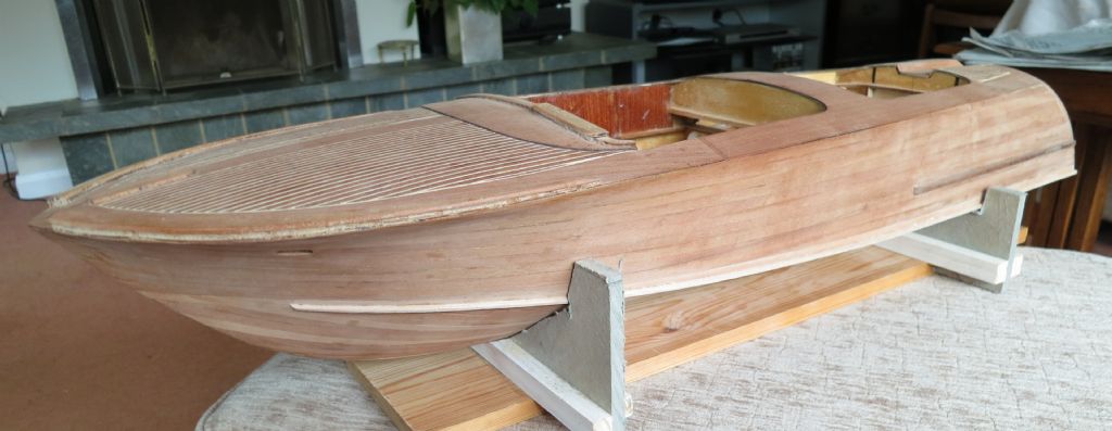

                      Spray rails added. I will have to wait and see if they do the job. As they will be on the painted part of the hull, they could be modified if necessary. Thanks for the advice20160123-img_1046.jpg
