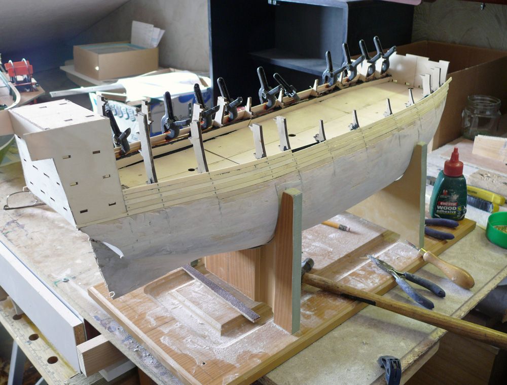

                #40051
                  Working on the top deck at the moment, and makes a nice change from planking!
                  The strips along the deck are the back walls of the dummy gun ports and will be painted black, shortly
                  Planking the top section is the next job
                  No info about the scrag end where the keel will fit, at the moment!

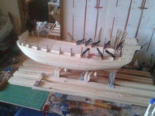

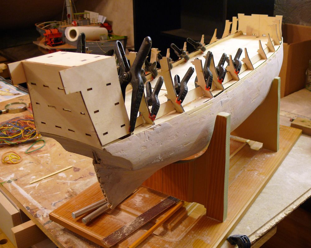

                  #40104
                    Planking the gunwhales is quite interesting, as you can see the end in sight!……But only for the time being!
                    The top five planks need to be fitted neatly, as they can be seen from the inside!
                    Note the tools needed for planking…
                    Pencil to mark the pin positions
                    Bradawl to make the pilot hole
                    Pliers to pick up the pin
                    Small hammer to finish off
                    Not forgetting the PVA of course
                    Your comments are always welcome……….Bob

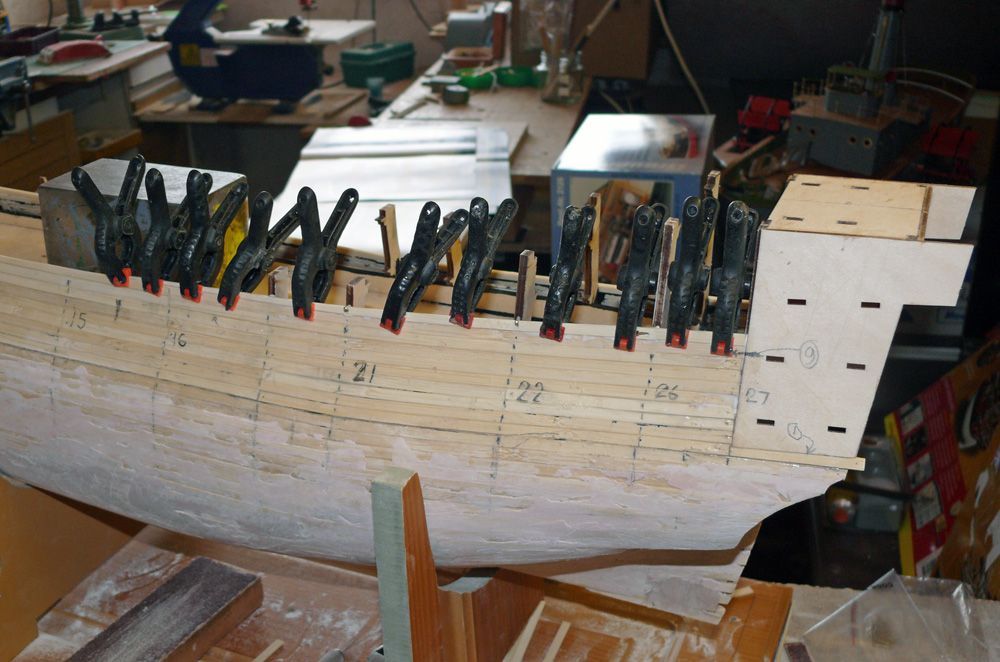

                    #40508
                      The top planking continues
                      Some of the top planks are tapered at this stage, and since I had`t followed the printed "blow by blow" instructions, it was rather tricky deciding where these tapered planks occured!
                      I used a magnifying glass to count the plank positions on the photographs and are now marked accordingly on the hull
