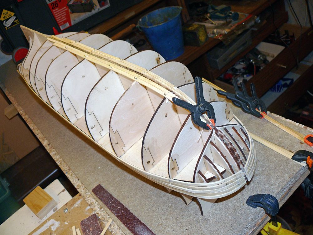

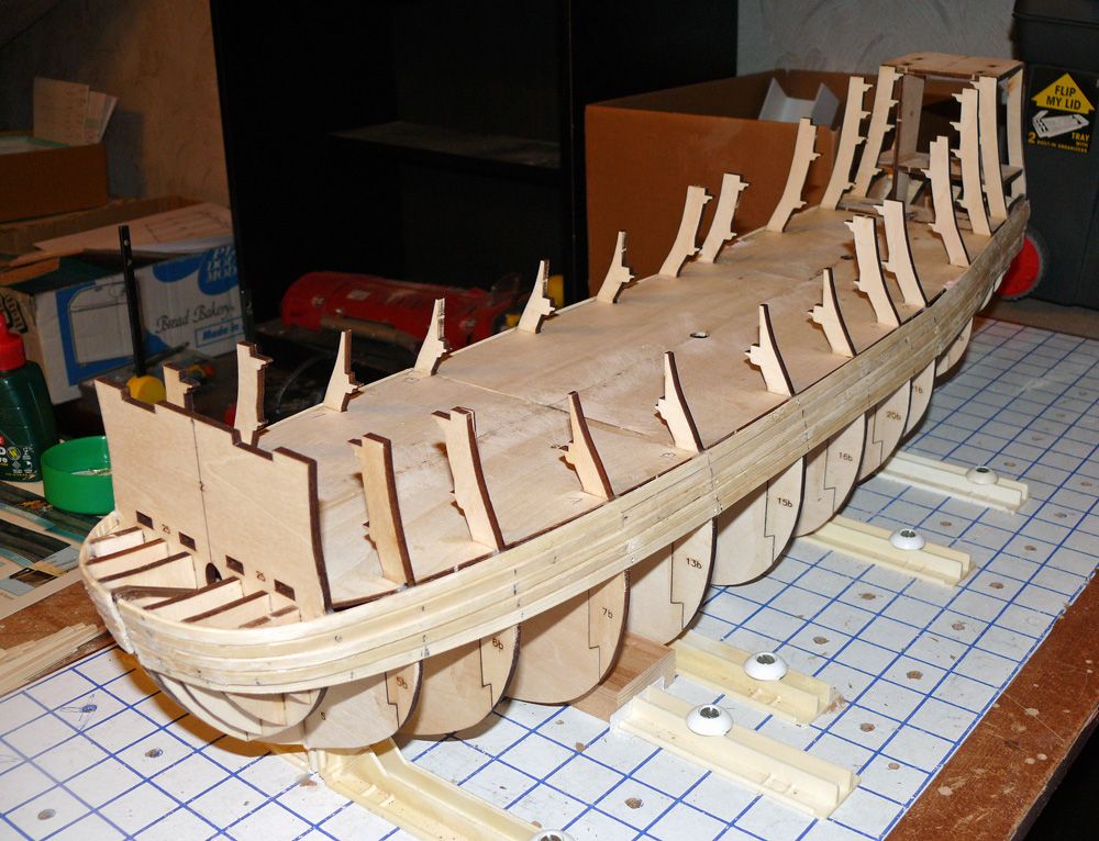

      Sub stage completed……..Phew!
      I actually abandoned the project quite a few times during the planking stage, due to the frustration of setting the nails through the bamboo and into the formers………all covered in glue!
      With a box full of bent nails, I found the solution was to use a bigger hammer! Once the nail bites into the former, they are easily tapped in
      The bamboo goes round the bend quite easily, but getting the nails in, is quite a job at times and not for the feint hearted!
      Completion of the first stage of planking. Next we turn the hull over and make a start on the bottom planks

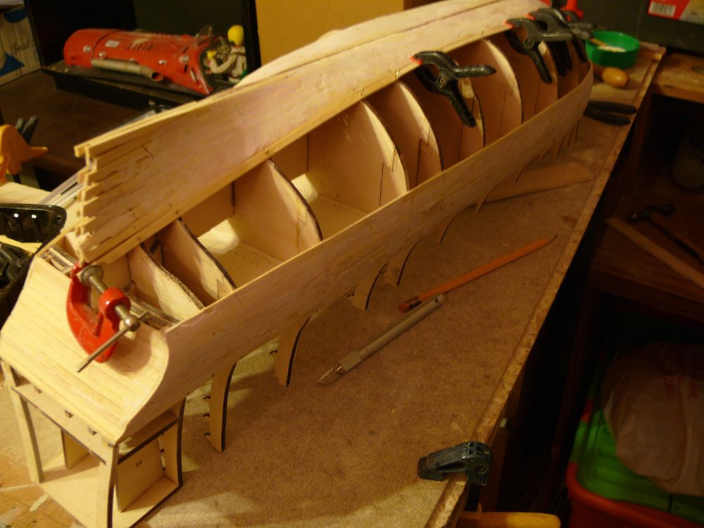

        #38631
          The bottom planks are quite easy to fit, but are a little uneven
          Filler should put things right, but I would like to know how the top layer of planks are fiited
          The Sovereign website seem to keep it a secret!

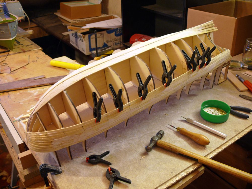

          #38712
            Latest stage of the plank battle!
            I seem to have settled down to the routine of installing the planks and is quite enjoyable now!
            The trick is to cut the plank to length, mark the nail positions, make nail holes using a blunt bradawl, apply the glue, place plank in position, select an easy laying hole for the first nail, place the nail in the hole and press nail firmly…….Then finish off with the hammer
            Apply a gusset of glue at every corner and all the nooks and crannies
            Made a start with the P38 filler and rub down at my leisure

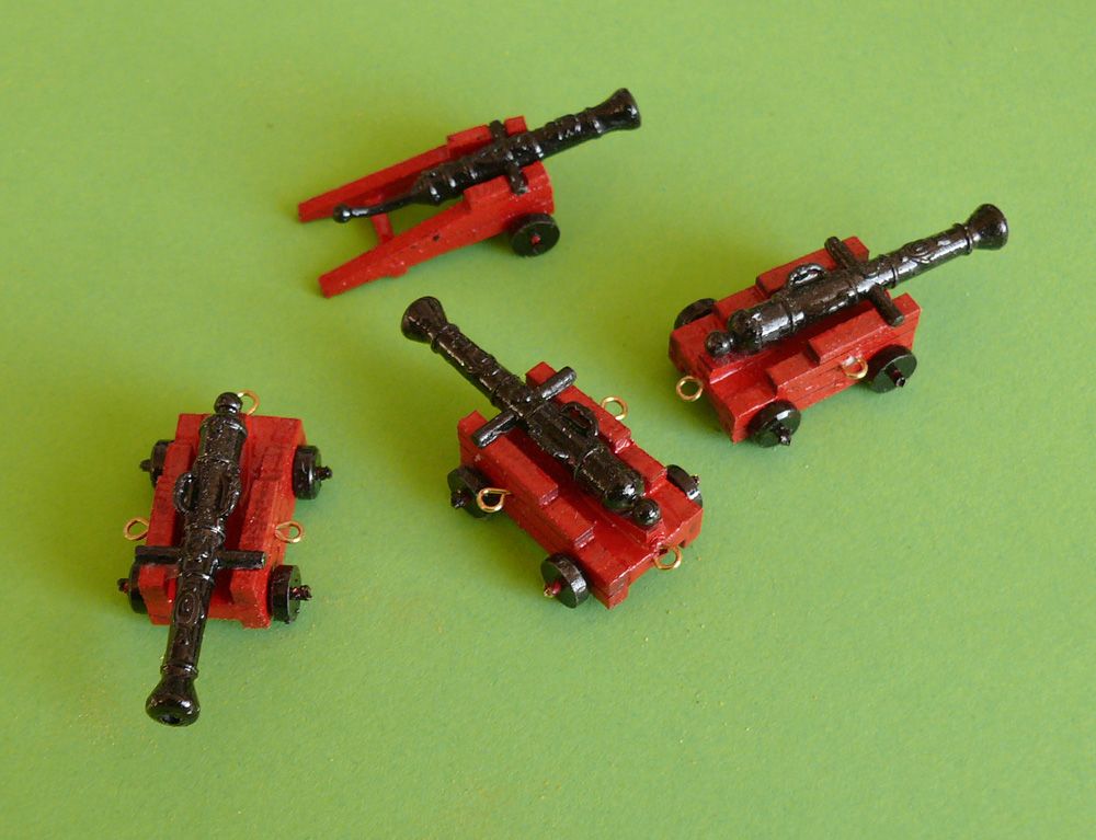

                      The first four of one hundred guns!……….Although some are just barrels protruding
                      A visit to SpecSavers was very necessary in order to make these little beauties!

                                Back on the planking again!
                                Still don`t know how the planks finish up at the stern end
                                Newbie Len……..I hope you possess some planking skills, as this part of the build is quite difficult and would test the patience of Jobe!

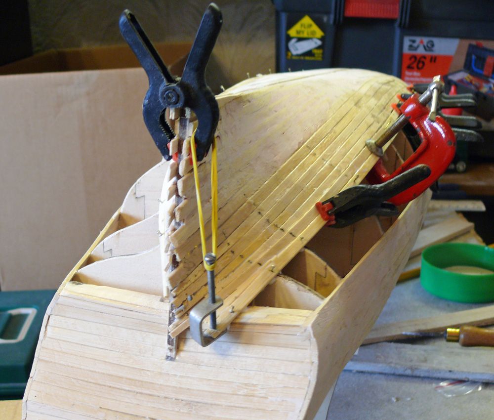

                                    #39360
                                      Going round the bend…….In more ways than one!
                                      The hull planking is now levelling out at the stern, so now I can make some progress
                                      The little clamp is retaining the twist in the plank via the lacky band, while the glue sets
                                      The ends of the planks, looking like a dog`s dinner at the moment, will be levelled off shortly, Awaiting instructions
                                      The P38 makes a lot of dust……..I now use it with PVA, to fill the nooks and crannies……Can`t waste it

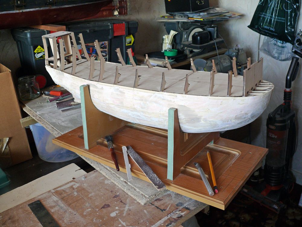

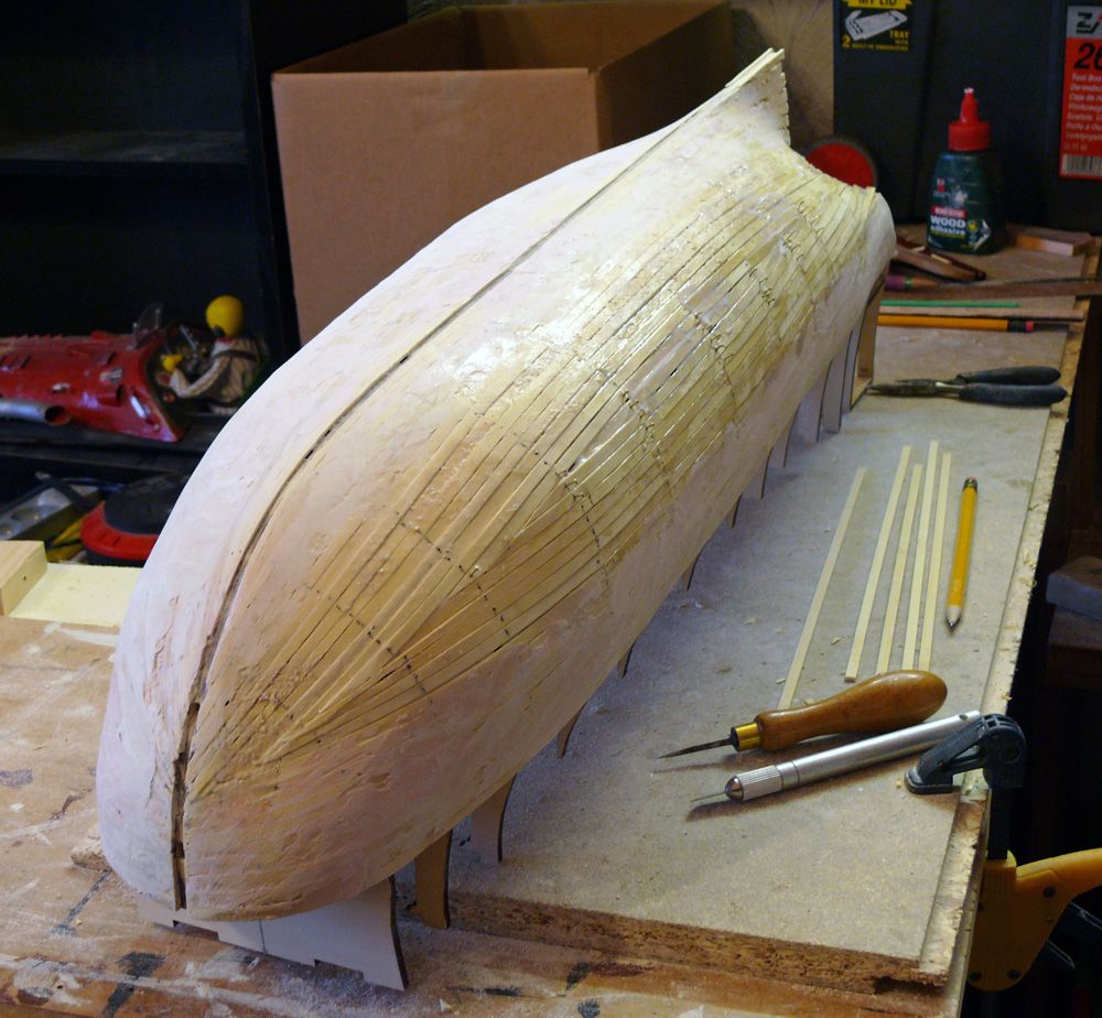

                                            After about two months of fiddly tedious work, the bottom half of the hull is finally rough planked!
                                            Will need plenty of P38 to finish off prior to final planking with fine veneer
                                            I would guess, the planking stage sees off most budding modellers?………Me included……..almost!……..Several times in fact!
                                            Just grit yer teeth and gerron with it!………..Today`s motto
                                            #39617
                                              Next week, hopefully, we will be planking the top section.
                                              Made a temporary stand in anticipation…..
                                              #39621
                                              Kimosubby Shipyards
                                                @kimosubbyshipyards
                                                Bob,
                                                once Ashley sees that hull as a door knob like you've shown, he'll want one too!
                                                Kimmo
                                                #39622
                                                  The mrs wouldnt let me put a door knob like that up I am afraid.
                                                  Bob. Good on yer, i suspect you are dead right and the planking would see off most budding builders!
                                                  AND you have to plank it again!! Its too much.
                                                  Paint it black and join the pirate fleet!
                                                  #39624
                                                    What are you two on about?
                                                    What door knob?
                                                    #39633
                                                      The children are referring to the kitchen unit door that forms the base of your new stand and how the model looks like an oversize handle.
                                                      (Ashley please note how I have resisted the knob related puns)
