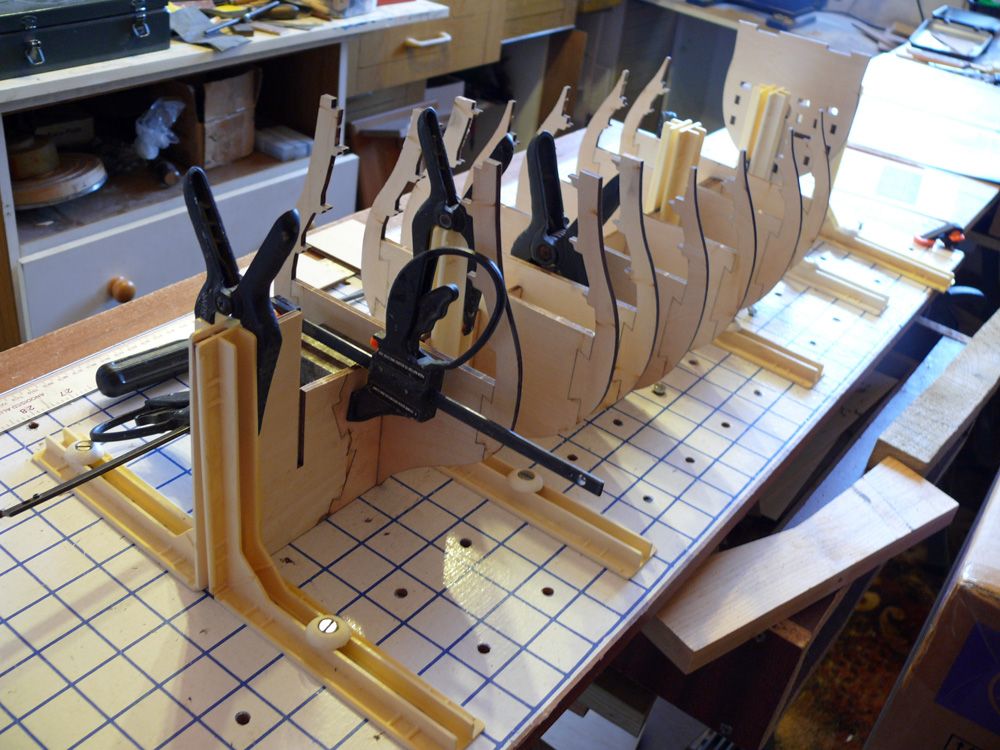

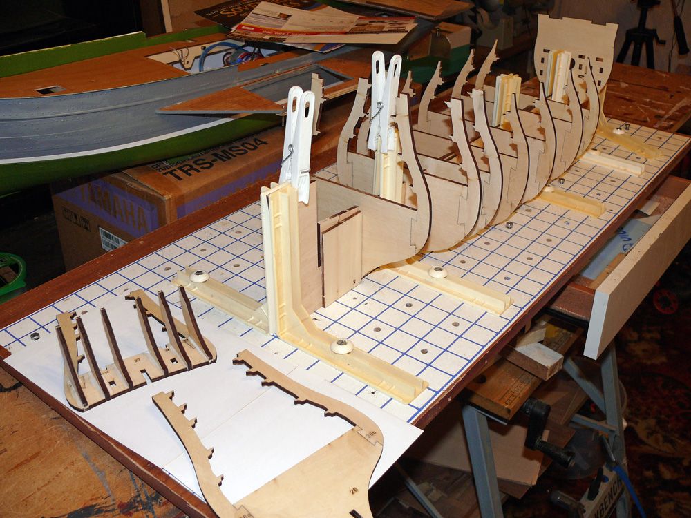

            Went to Smith`s today and it`s about turn chaps!…..Got part five after all!
            Didn`t take long to add a single piece of keel and one former………. Noticed that the presentation of the last two issues are very poor compared to the earlier issues. Suppose they think that if you`ve reached issue five……Your hooked!
            Don`t you bank on it…….Matey Boy!
            The assembly jig is nice to tinker with…….bOB

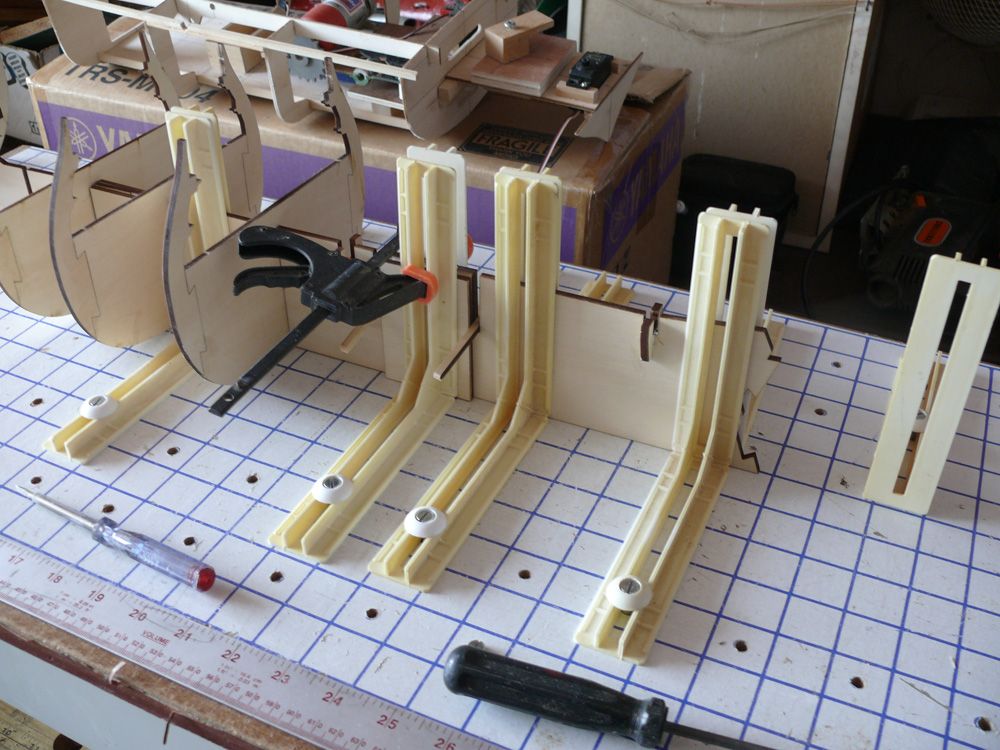

                  #37014

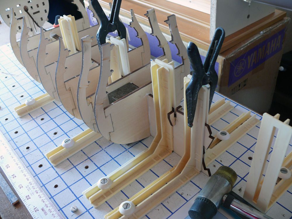

                    Two more formers added…..20 and 21
                    At the moment, Smith`s have no record of me ordering the long lost issue two, even though I`ve paid for it and have a reciept!………..Such is life
                    The clamps at the top of the angle brackets make a nice locking action on the keel

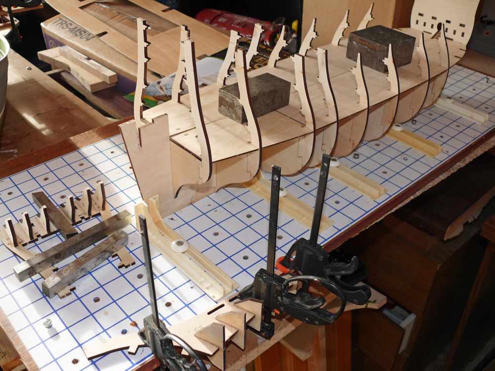

                    #37102
                      Issue 7 completes the keel making the hull length of 26"

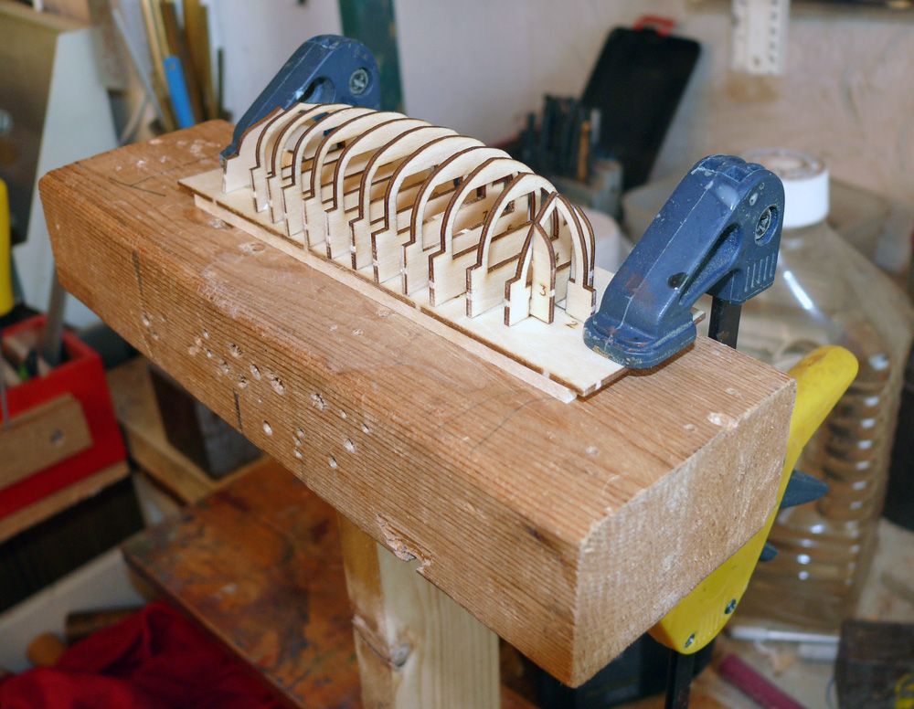

                      #37225

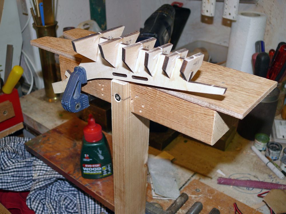

                        This week`s issue is the Jolly Boat or Ship`s Launch
                        The package comes with a building jig……..Nice idea……
                        In which the formers are glued into and will be cut off on completion, no doubt?
                        The build is on the new Eureka Moment…."Eye level work rest" …..Which makes life a lot easier!
                        #37241
                          All the formers are in place now…….More parts coming next week
                          It seems a great pity that the keel is not let into the formers?
                          The hull is clinker built and may require some steaming of the planks to get round those tight bends?………I`ve never had much success with steaming…..so we may not need a Jolly boat!

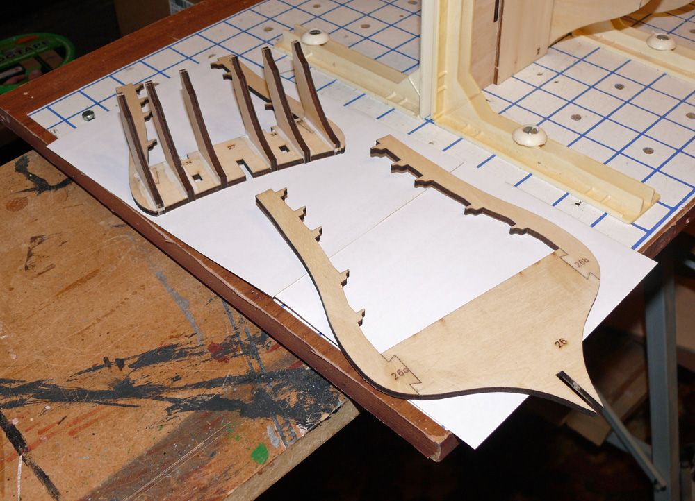

                            Week Nine……Transom
                            Simple assembly from superbly lazer cut jigsaw parts!
                            And a WIP picture for good measure
                            Still enjoying the build…..Bob

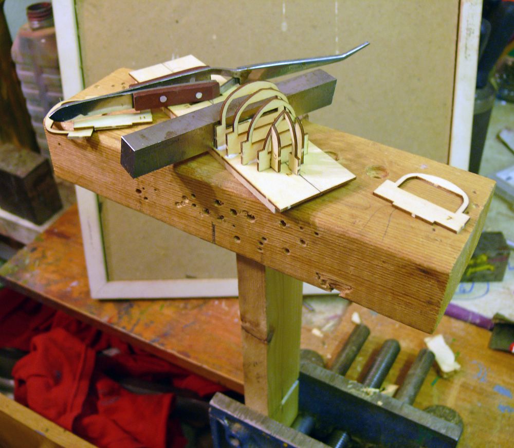

                              Week 10 is the Bowsprit assembly
                              Built in comfort on the high level work bench

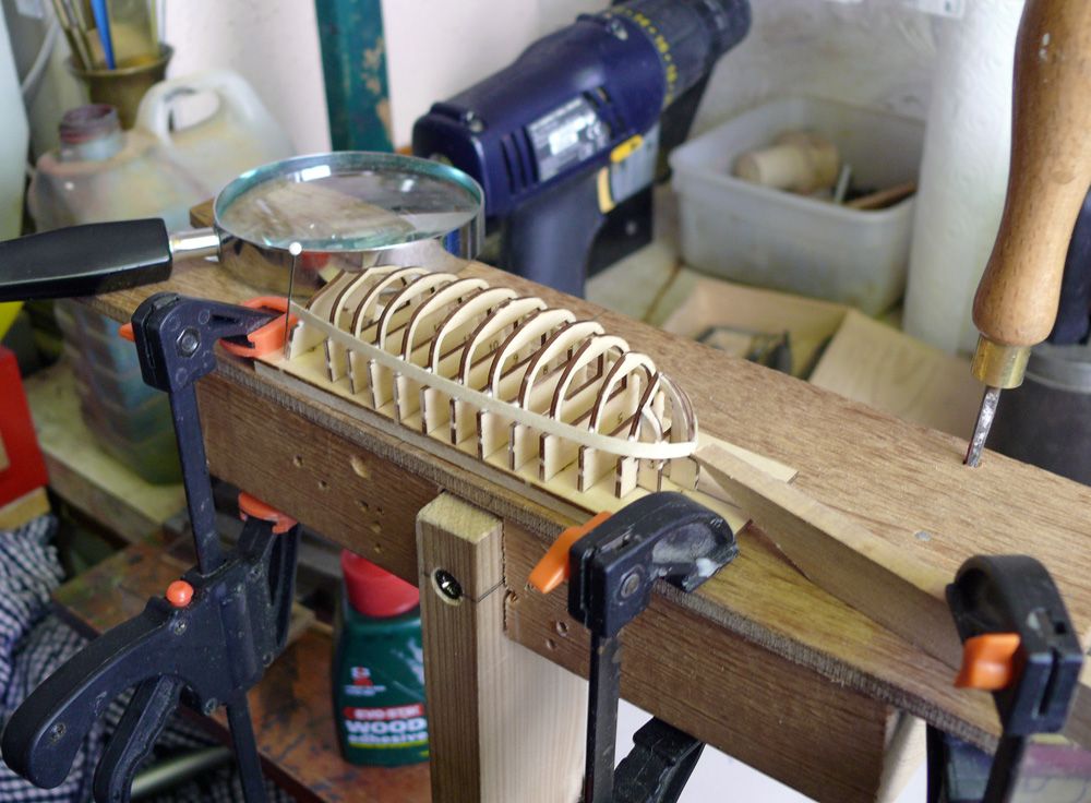

                              #37475
                                Back on the Jolly boat once again……..Planking with 0.6 x 3mm stripwood
                                Had to resort to the magnifying glass………Next Eureka moment will be a versatile mount for same!
                                Note the precise manner, the clamped pointed stick in holding the plank end in position…..Much better than a pin
                                PVA glue was applied with a brush and the surplus brushed away later
                                So far, so good………Bob

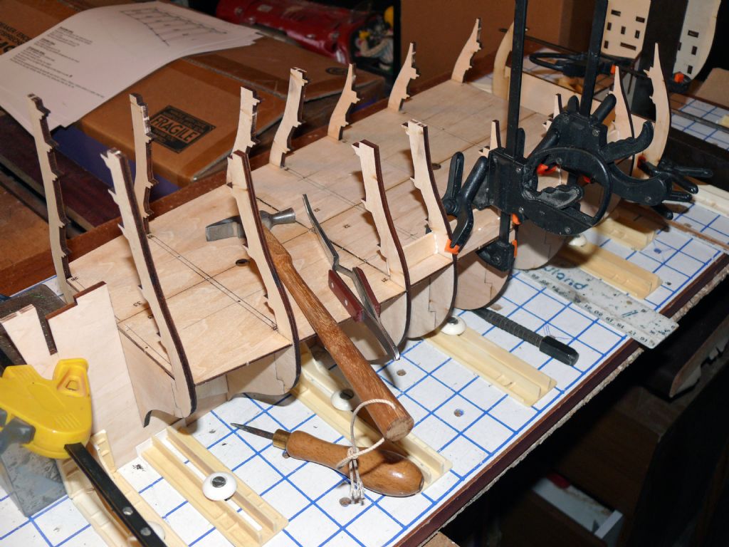

                                            Issue 11……..Brings the lower deck floor
                                            The instructions say……."Glue it in position"
                                            Next week, the instructions say…….."Now nail it!"………..eh?
                                            All part of the fun!
                                            The parts in the foregound are in storage and clamped down to stop them from warping
                                            #37631
