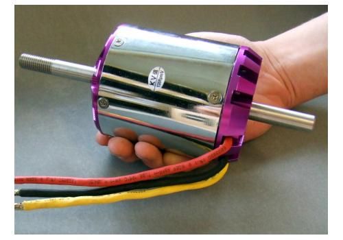

                                                  Phil Winks 1
                                                    @philwinks1
                                                    Here you go Bob
                                                    Big Boy!!! – 7000 Watts of Power for less than 100GBP
                                                    Model: XYH80-100-A
                                                    Turns:
                                                    6
                                                    Maximum Power: 7000W
                                                    Resistance: 17ohm
                                                    Idle Current: 3.5A
                                                    ESC: 150A
                                                    Input Voltage : max. 48V
                                                    Kv : 180 rpm/V
                                                    Weight: 1750g
                                                    Shaft: 12mm
                                                    Voltage Range: 20-48v
                                                    Non Load Current: 3.3A
                                                    Equivalent: 60-80cc Gas Engine
                                                    Prop Size: 30×15
                                                    this is the sort of size they go to but this one aint exactly practicle
                                                    mind you it’d get that beast on the plane if it were not for the 40 Nimh’s and 1750g of motor dragging her to the bottom at high speed and it’s a hundred quid give or take.
                                                    cables would also have to be enourmously thick to carry that current, about 6mm squared I reckon and it turns at a poultry 8640 rpm on 48V. mind you the prop could possibly be about 4″ maybe 6″
                                                    Maybe I’ll design a 1/2 size tug to take it eh?
                                                    If you go for 1/2 that size so you can have two in the boat the weight  issue is much the same if not worse.
                                                    Phil
