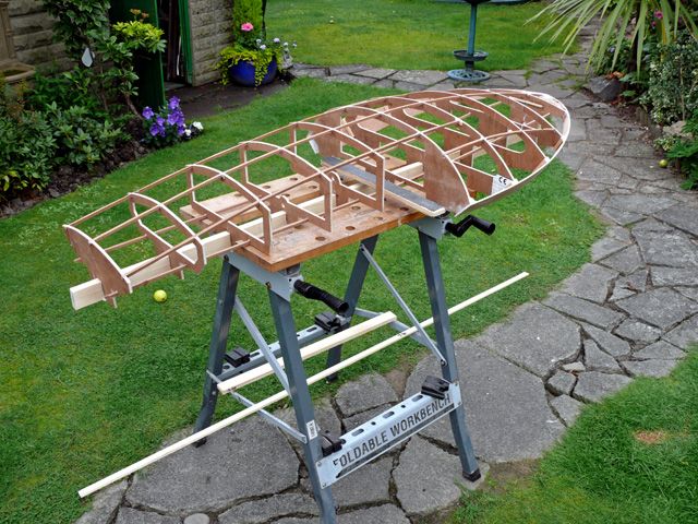

                  Work in progress…………It took five days to get the chassis finally adjusted and glued, due mainly to the damp weather.
                  Now cutting the planks, which are 4mm x 20 mm section Liteply.
                  The problem at the mo, is sorting out the front side pieces, can`t be sure the former ends are correct yet?
                  #22399
                    Finally sorted out the side walls………………….Luckily, the natural bend of the plywood just matched the former ends………………I couldn`t believe my luck!

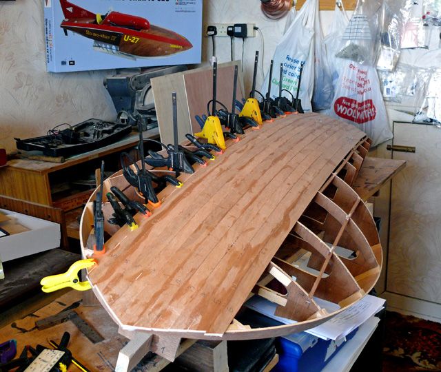

                                            Work in progress
                                            Started the planking using strips of 3/4″ x 3mm liteply………Easy enjoyable work at the moment!
                                            Note clamps holding seams in line with each other…………curvature of the planks is more important than the formers……this ensures a smooth rippleless surface

                                            Phil Winks 1
                                              @philwinks1
                                              Now thats a lot of clamps Bob. this is one of my favourite parts of the build as you start to see a proper hull emerging. Keep it up lad looks like your doing a “proper job” as they say in the west country

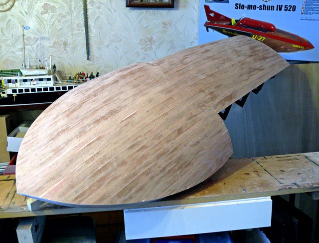

                                                #22757
                                                  Top deck planking now finished

                                                  Phil Winks 1
                                                    @philwinks1
                                                    Looks great Bob keep it up

                                                      Morning Bob
                                                      It is starting to take shape and is looking very nice…..but when are you going to start building the big one?
