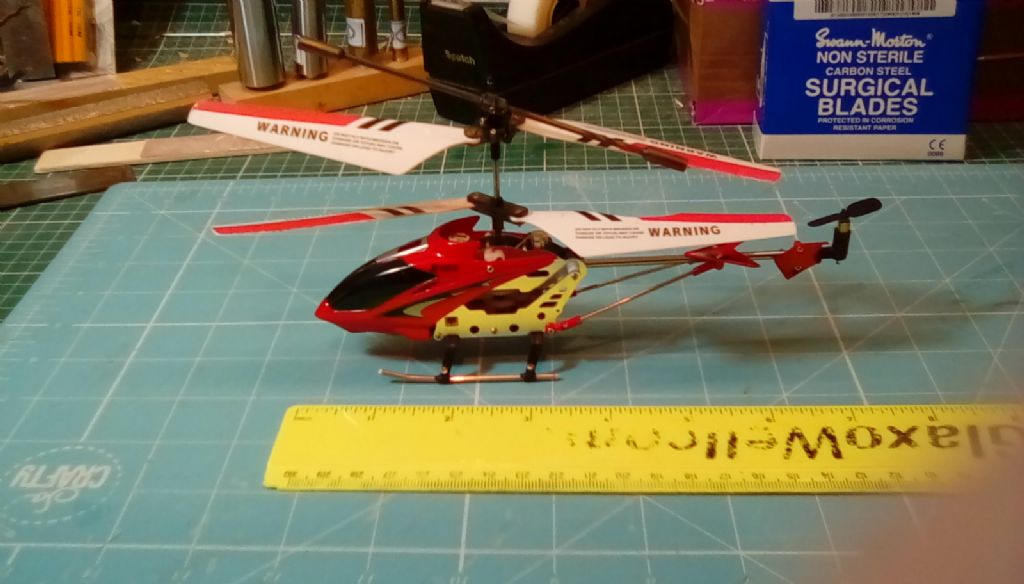

              Hi Stephen,
              Why not use one of these as a basis £15 it's infrared and managed 100's of flights so far 😀
              You could build a body over the mechanical frame remove the top rotor and then turn tail rotor sideways job done.
              This one is 56ft long at 1/96th scale

                Thank's everyone for the replies. I think I'll opt for the infrared option as the structure is then done. My attempts to create the chopper so far weren't anywhere near sensible 😂
