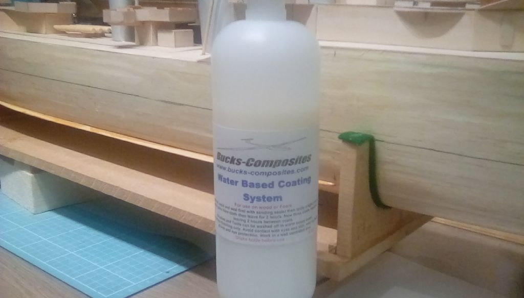

          #84591
            Hi John,
            As Ashley says, I use a similar water based resin,from Graham @ Bucks Composites, and it doesn't crack with multiple coats like sanding sealer 😀
