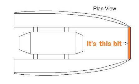

                                          Its not a parabolic hull…..its a parabolic hydrofoil wing that spans between the two sponsons.
                                          #51747
                                            Can`t see this parabollick wing thing in the plan view?
                                            I would like to see the prop stuff….Out back, SloMo style and an animated driver of course

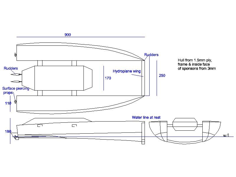

                                                I take it this bit is in the water?? It looks very thin if so (sweeping statement not knowing how big the rest is of course)
                                                AND it is straight and not curved so less of it stays in the water at high speed?? waterjets or surface piercing props?

                                                  waterjets sound good if you know where they can be purchased at a reasonable cost
