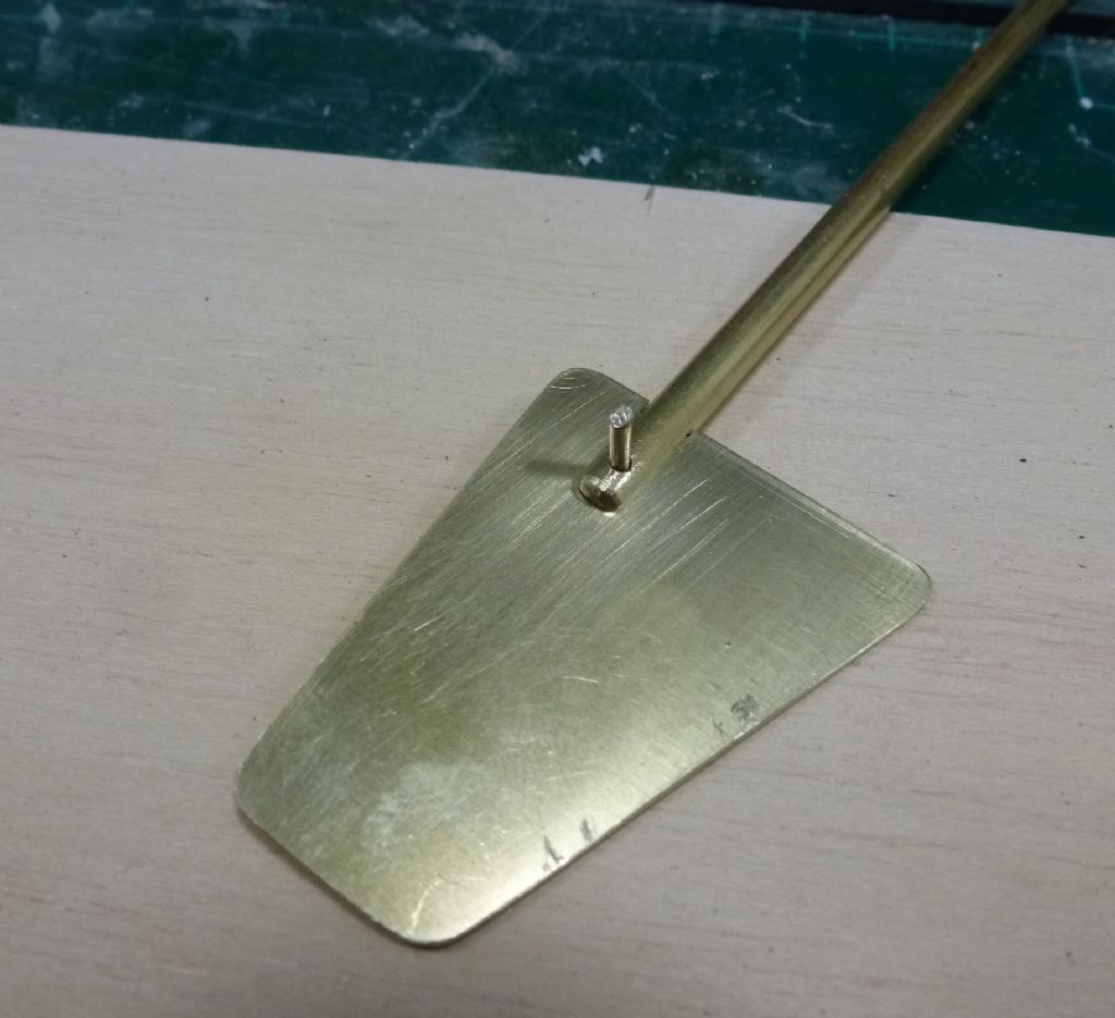

          #75968
            John. Welcome to the forum. As Colin says, more info needed,
            BUT usually rudders and shafts are made from brass, and the rudder flat will either be soldered on or riveted.
            If it is not brass then we would need a picture to see what style you have. A measurement of the shaft would be useful as well.

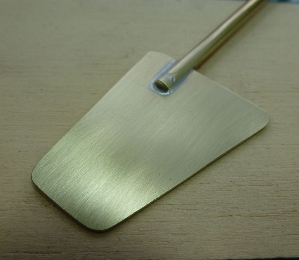

              #75978
                I make my own nowadays. The small bandsaw slots 5mm brass rod very easily, brass sheet cut to size for the blade, soldered on, brass tube as a sliding fit for the rudder post, nylon clamp-on tiller. Easy.
                #75979
                  Some piccies to go with Ashley's words:
