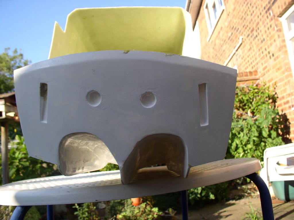

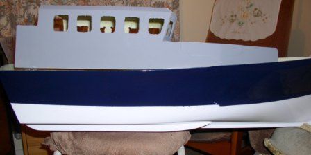

                Right, Mersey hull has now arrived from Models by Design. Supplied with 55mm “handed” props [4 blade].

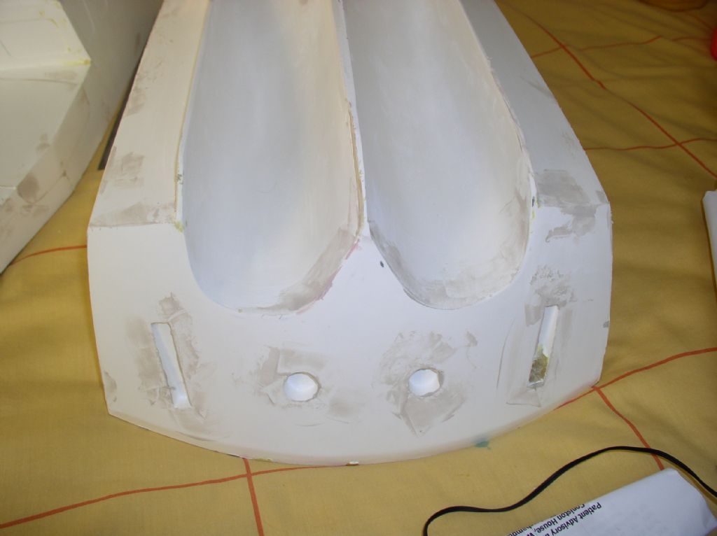

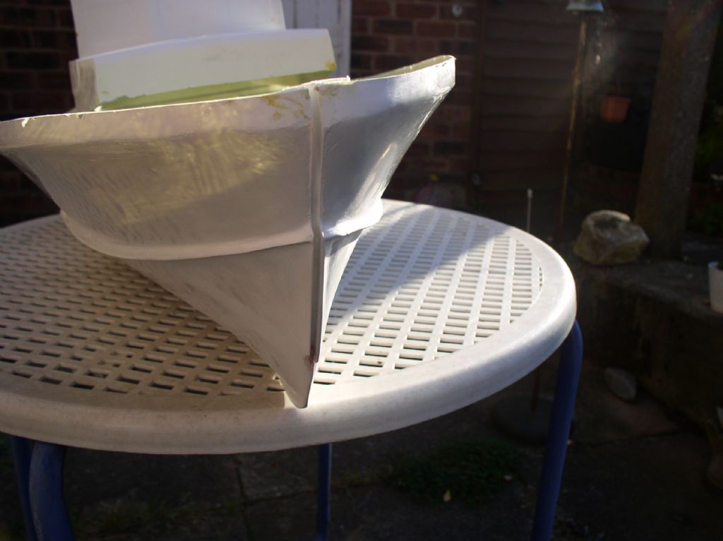

                I decided fist job was to give it a wash over, then apply a bit of “knifing putty” to all the slight imperffectiosn in the outer gel coat before any sanding work starts, so it can all be knocked back together, making life a little easier.
                #31917
                Steve Gregory 1
                  @stevegregory1

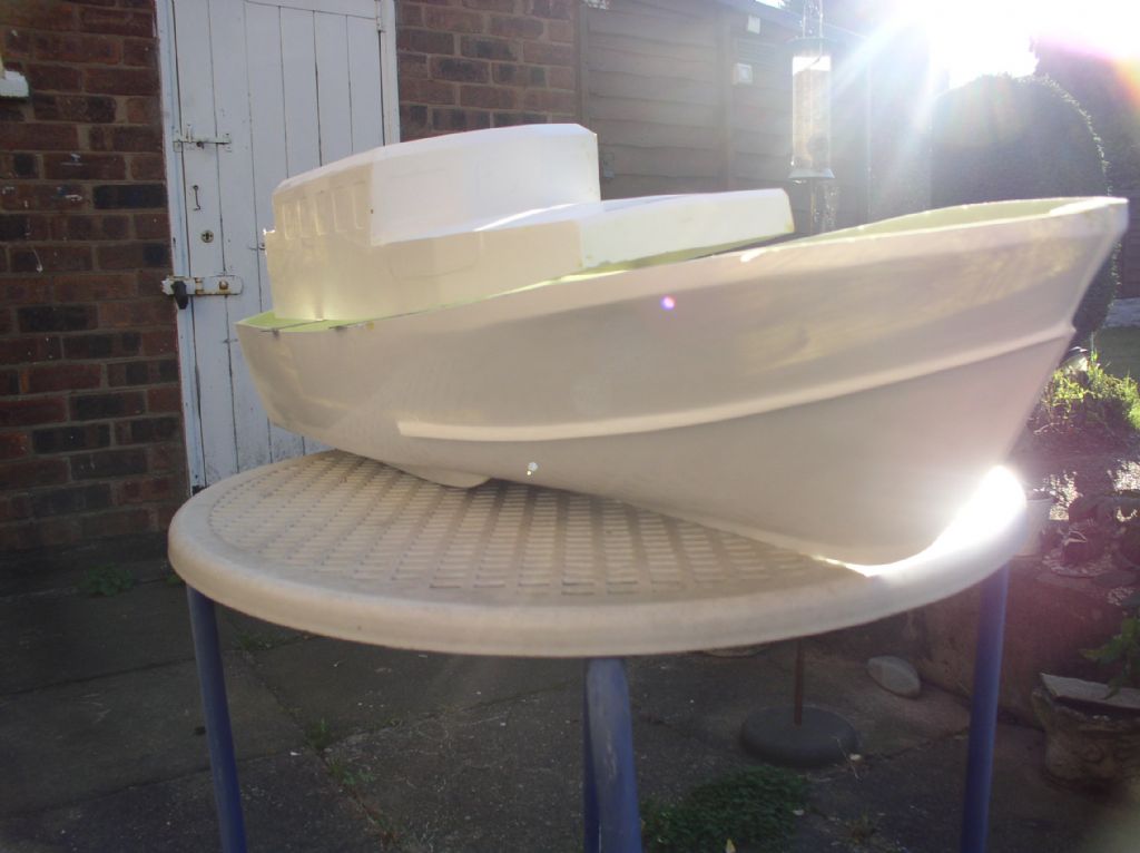

                  hull has now been sanded again after a few more filler points sorted and has first coat of grey primer, this has now highlioghted a few more areas to be filled, so will do these before further flatting and priming.

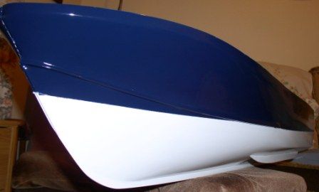

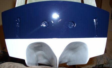

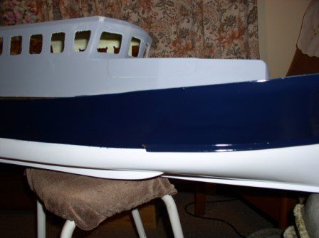

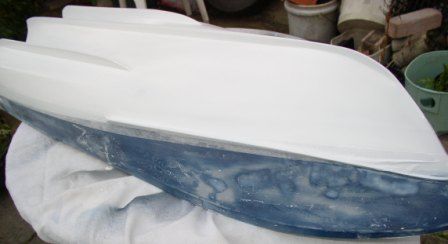

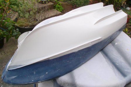

                    I have now managed to finsih filling and sanding the hull off and applied its first coat of white paint to the lower half. Once fully dried this will be given a final flat with some 800 wet paper and painted again. a third and final coat will go one after this has dried, once flatted with 1200 paper.
                    #31976
                    Steve Gregory 1
                      @stevegregory1

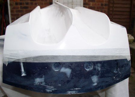

                      the lower hull has had a further 2 coats of white paint. this has dried sufficiently for it to take masking tape [48 hrs], so have masked the white off to apply the deep blue upper band. this had had 3 deep coats of paint to give added deepness to the colour and glossy “sheen”. I am yet to finish off the edge between the colours as too soft to clean yet.

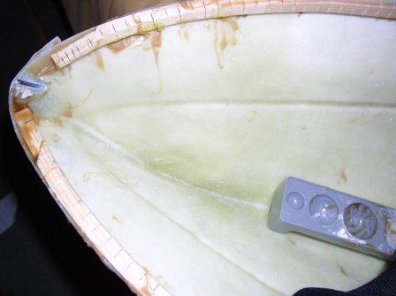

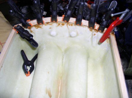

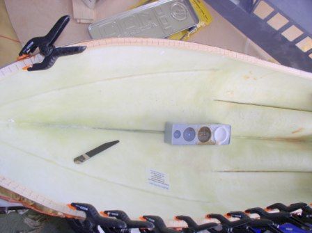

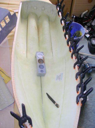

                            Started on fitting the internal wooden support pieces today. I use stabilit express glue to attach the wooden pieces to fibre glass, once in, it dont move again. Ive had to put a fair few saw cuts in to the wood, simply to get it to bend to the correct shape.
                            once the glue has fully dried, the saw cuts will be brushed and filled with a nice runny mix of cascamite to put the strength back in to the wooden pieces.

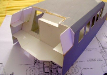

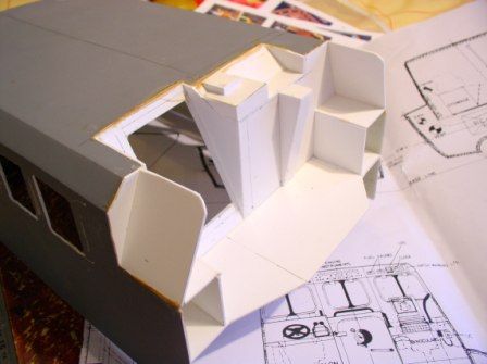

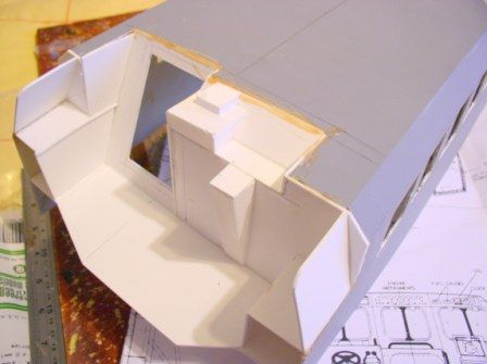

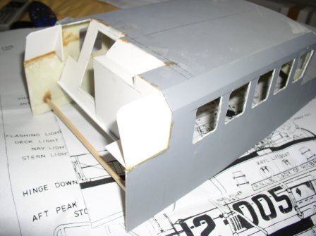

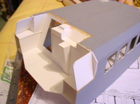

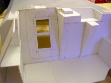

                                I have now started construction of the rear section of the main cabin. Careful measurement of the plans and conversion to 1/12th scale dimensions needed at all times to ensure accuracy. Especially as there are quite a few angled pieces involved.
                                I am using styrene sheet , admittidly I am well versed with its use in previous scratch builds, including my “Egrete Pusher tug” and RMAS Moorhen. its a light very easy to use item and can give sufficient strength to support where necessary.
                                #32062

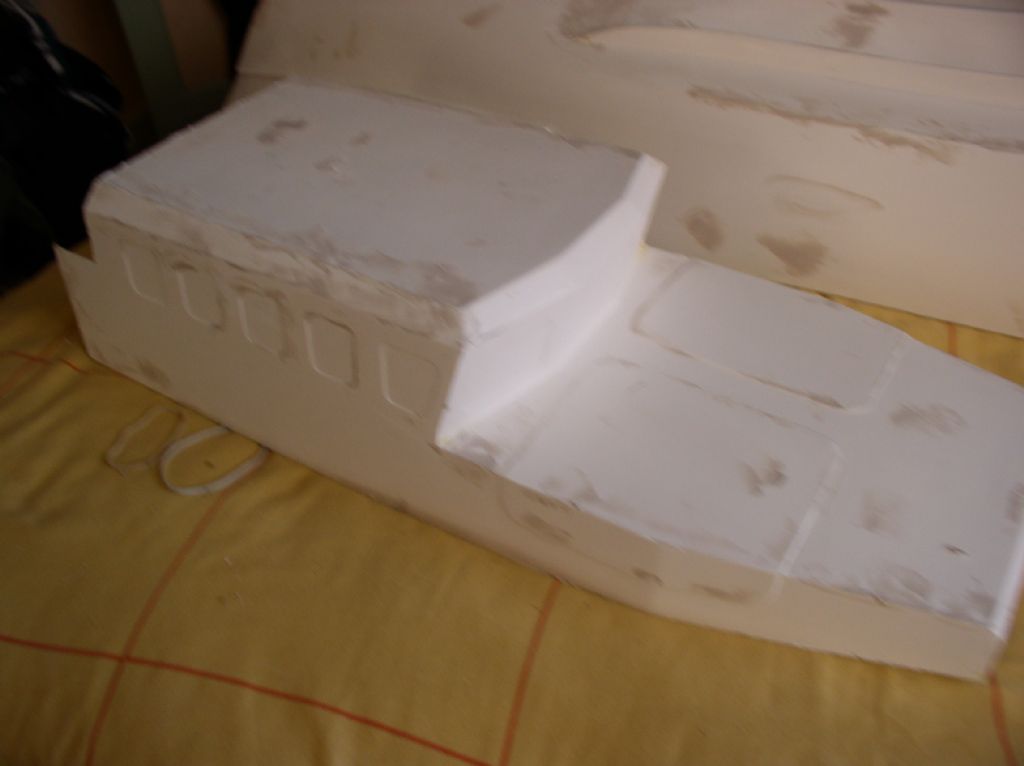

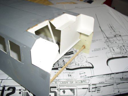

                                  Have started work on the stern flying bridge section, so at least this will strengthen the open rear end of the cabin up, before any internal work is commenced.
                                  All items are made from styrene sheet, for simplicity of construction and also weight.
                                  #32104
                                  Steve Gregory 1
                                    @stevegregory1

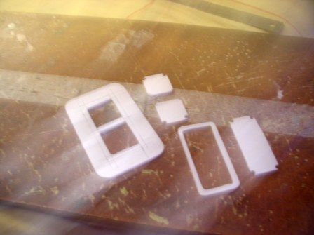

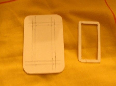

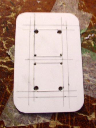

                                    Ive now started construction of the rear cabin door, being as the layout and build of the open wheelhouse area is going ok. I decided to make the door in a similar fashion to the speedline window kit I have in stock for it, so its a “sandwich” construction.
                                    The main door fram, has a clear perspex window panel, topped off with a further “window surround” frame.
                                    Now how to recreate the retaining bolts?
                                    I was simply going to carefully “slice” a load of pieces off a length of olid plastic rod, butcan’t really guarantee each one is going to be same thickness at such a small size, so Im going to experiment with drilling the completed door, making a series of holes all around the window frame, then cutting lengths of plastic rod to pass right through the door assembly, thus creating a bolt/nut effect on both sides in one easy go.
                                    more pics once ive managed to do such, see what you think !
