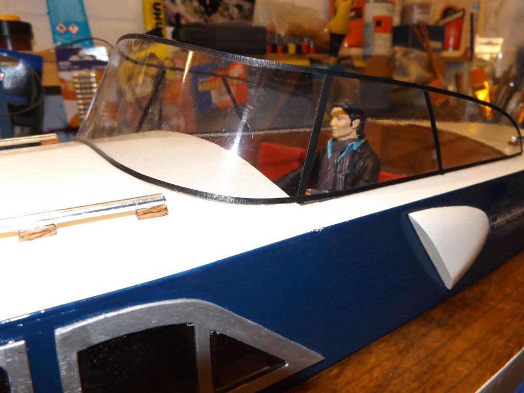

                My choice of canopy glue is Formula 560 by Pacer, proclaims on the bottle to be "The world's best" !! So it must be true ?? I have found it pretty good and dries clear 😃,
