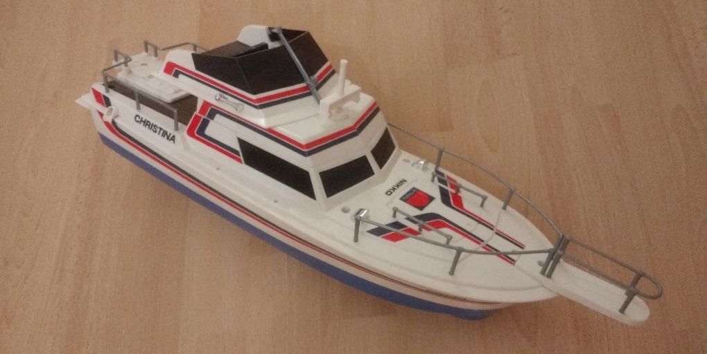

      While my clyde puffer kit is still in production by Mountfleet, I thought I will refurbish a 40 cm toy yacht to reach 2 goals:
      1 – get a "driveable" vehicle for the local club meeting season start on 12th may
      2 – get a boat which my daughter could drive without risking to sink a very expensive puffer, and get it already this summer
      The boat itself is very old, it was probably a high end toy back in the 70es. It is equipped with 27mhz propietary RC system, solenoid-based steering, and needed 4x C battery, and 4x AA battery. Motor also drives a pump

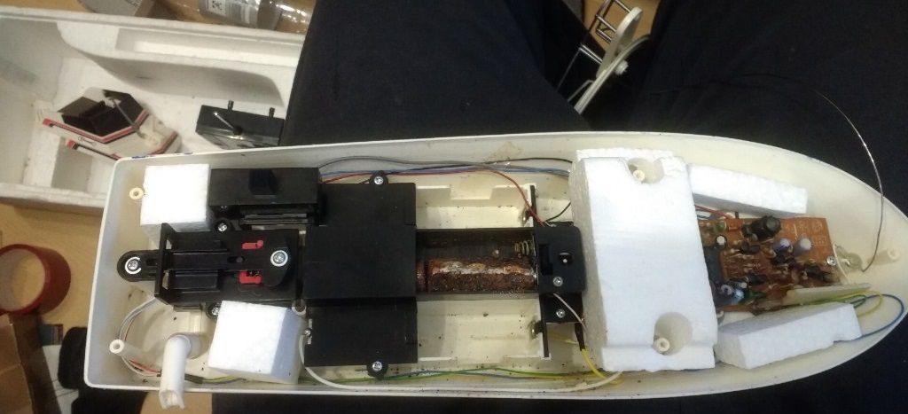

      The boat I got was nearly gone to the trash can – I brought some trash out, and met my neighbour who was going to toss the boat into the bin. Outside, the boat looks more then ok. Inside, it was damaged and dirtied alot, as the batteries were left in place for probably 20 years or so – so ran out, rusted away. Same also happened with the battery inside the control.
      So, my plan is now two-stage:

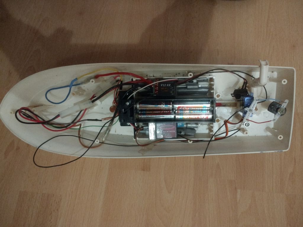

      1) Get her running. For that, I carefully removed all the equipment inside, and removed most of the crusted stuff from the batteries. The motor runs well, and will stay there for now. Solenoid gear is now out, and replaced by a simple 9g servo. I will use the AA battery case and fit 2400 or 2700mAh NiMh cells there. Missing C-type batteries will be replaced with lead tyre weights at 1-1 basis. A 3 channel simple RC from Reely would be added, using an ESC from Modelcraft. I would probably add some LEDs inside the cabin.

          So, I fitted the boat out today, I was lazy to go to the cellar to fetch the 3 channel RC sender and receiver, so used the 4+1 channel Jamara Compa X4+1 from the snowberry, on 40 Mhz Channel 4. I ran it for 5 mins in the bathtub, and it was tight. No water ingress, trim is all right, and it moves and steers well. I however found out that nearly all my rechargeable AA cells are dead, I used usual AA Batteries for the trial. I ordered a big batch of Chinese AA 3800 mAh cells, lets see if they live up to expectations. I will get some more cells tomorrow in a store.
