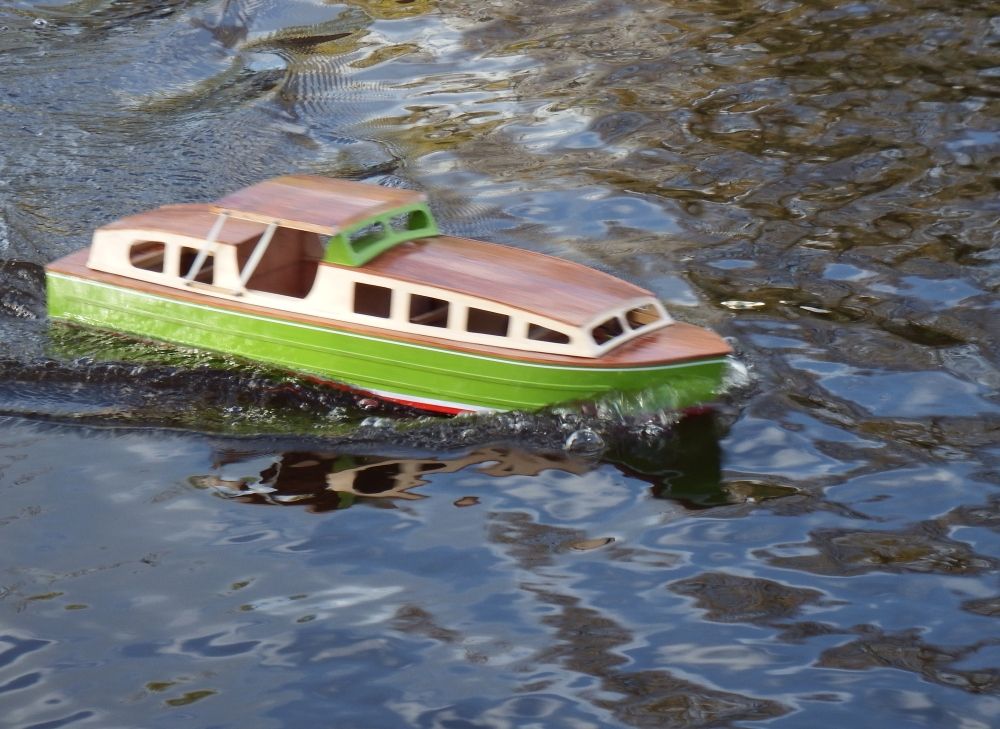

          I was just looking at the practically finished Ellie Cruiser this morning and wondered about the Centre of Gravity position, in preparation for today`s maiden voyage
          The waterline has a length of 35 inches. I placed the model on a length of Ali tubing, midway along the waterline and to my complete surprise……It balanced!
          That must be down to the Chief Designer?……..Well done Paul!
          And for good measure, the model, complete with two stick batteries weighs 4.5 Kg…..(9.9lb)
          All good info for the Drawing Office

                        We ignored the howling wind and the roar of the crowds and the fireworks etc
                        After a quick check that all was well, we launched Ellie into the choppy icy water……..and she purred away!
                        All was well, perfect balance first time……..Well done Paul
                        Dashed about the lake, fast and slow….No problems at all
                        Had a very good turn of speed ……..That`s good news for Sea Spray and even better news for Red Leader…..They will fly!
                        The only problem we had, was that the Tranny had the controls reversed on this crazy programmable device and we`d forgotten how to set it. Not a problem with the stills, but may be noticeable on the video
                        Now for the pix…..
                        sail-4.jpgMight be slightly nose down, but the batteries can be slid backwards to correct this
                        Picking up speed with a good bow wave
                        Purring away
                        Moving the batteries back, should get the nose up?
                        Very pleased with the Maiden voyage

                        #45043
                          Very very pleased with the results Bob, slightly heavy in in bow but easily corrected.

                                Nice, Bob. Glad I've fitted the spray rails though, as Sea Spray will be more bow-heavy than Ellie (twin motors).
                                #45048
                                  The model was quite fast, even though I hadn`t set the ESC
                                  Since it was running quite well on the bench, I didn`t fiddle with it
                                  On the water, the motor kept cutting out on full throttle………It sounded like a shot up B17
                                  I wondered, would it be possible to make it run erratically intentionally?…As it was quite interesting?

                                                  As already mentioned earlier, the motor was very noisy on the maiden voyage and could be caused by the following……..
                                                  The 20 inch propshaft could be whirling
                                                  The hull skin could be vibrating and may need a doubler somewhere?
                                                  The motor coupling could be the cause……Dave M has some info on this subject
                                                  Have moved the batteries to the rear and will have another sea trial and report back
                                                  Bob…….Research and Development department
