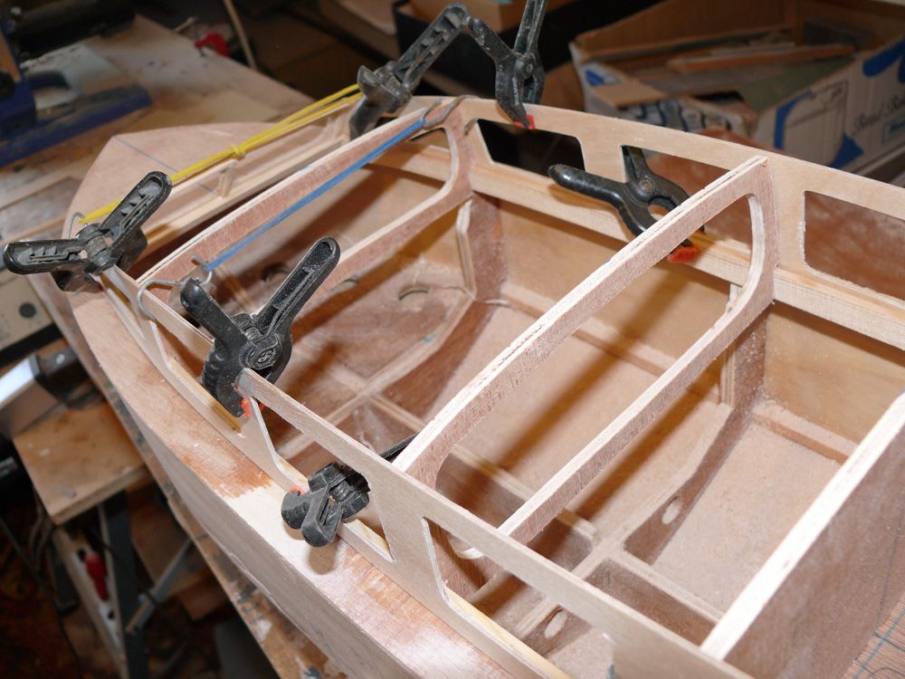

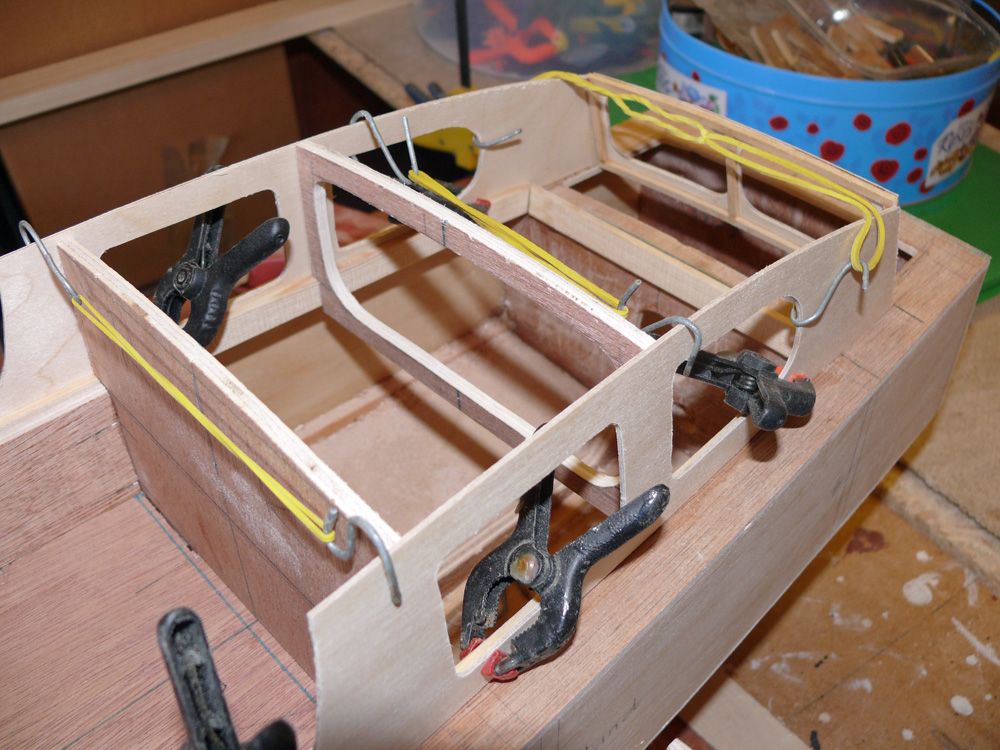

              The front and rear screens are finished and the inner formers have been modified by removing the central areas of the walls
              The next job is to remove the cabin structure and mask off the coaming prior to reassembly and final glueing!……Wow!

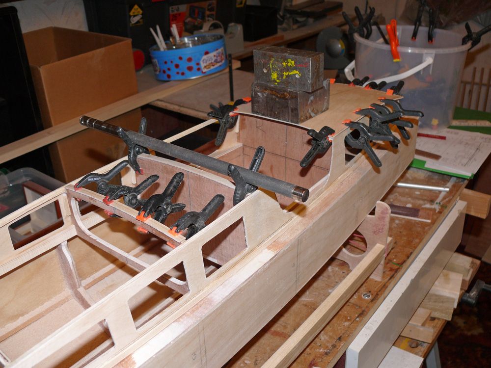

              #43733

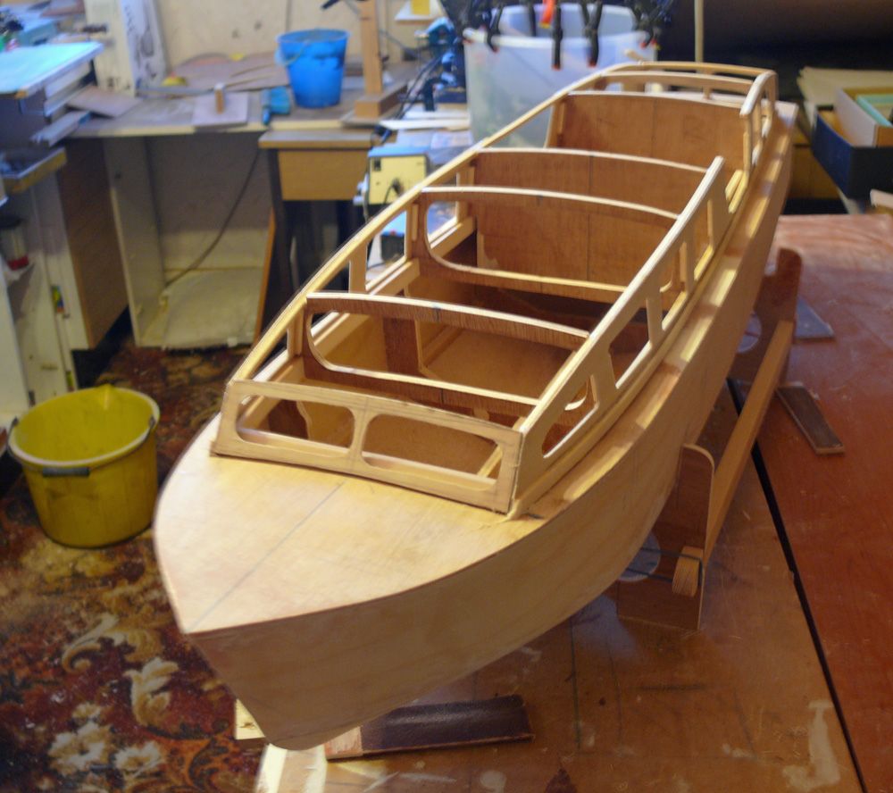

                Red Leader recommends we glue reinforcement stringers to the cabin sides
                The drawings have finally been amended, incorporating the choice of 1.5 ply for the superstructure
                Note the top stringer is applied full length, which will come in handy, when the roofs are being fitted

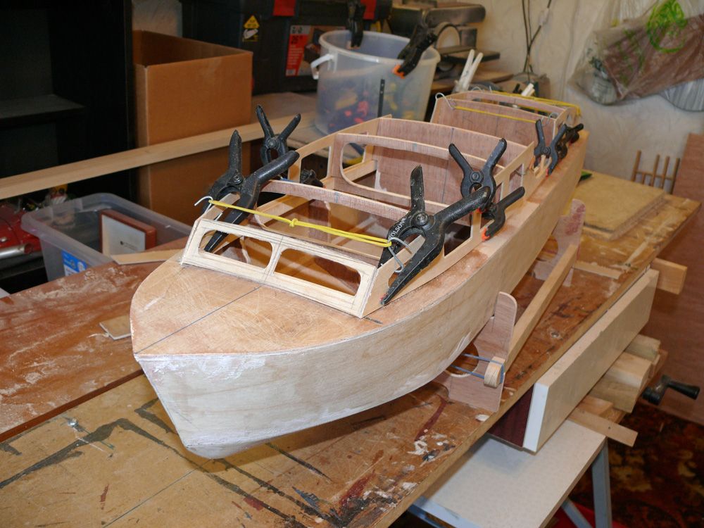

                                  Hi Boyz!

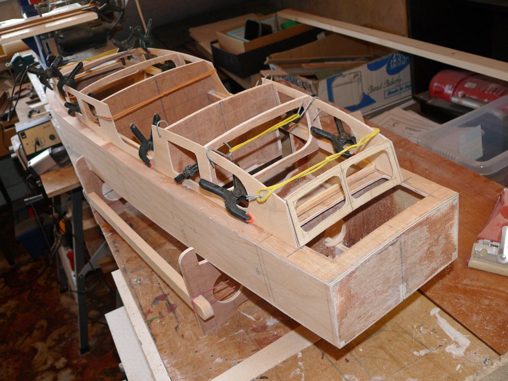

                                  Finally glued up the cabin structure!…….Wow!….What a milestone of a love/hate relationship!
                                  Nice to build, but you need to be alert to the smooth shape of the structure!……ie…..No lumps and bumps are allowed!
                                  My advice to the Newbies……..Take your time and work accurately
                                  What a great looking model? Congrats Paul
                                  Now for a good clean up and glue fillets need to be added inside
                                  Be careful when glueing the formers……..Don`t want any glue near the coaming or you`ve just built yourself a static model!
                                  Now then, Red Leader……..Does the roof edge overlap the cabin walls?
                                  If not, then we could use 1mm ply for the roof material and will be easier to shape?

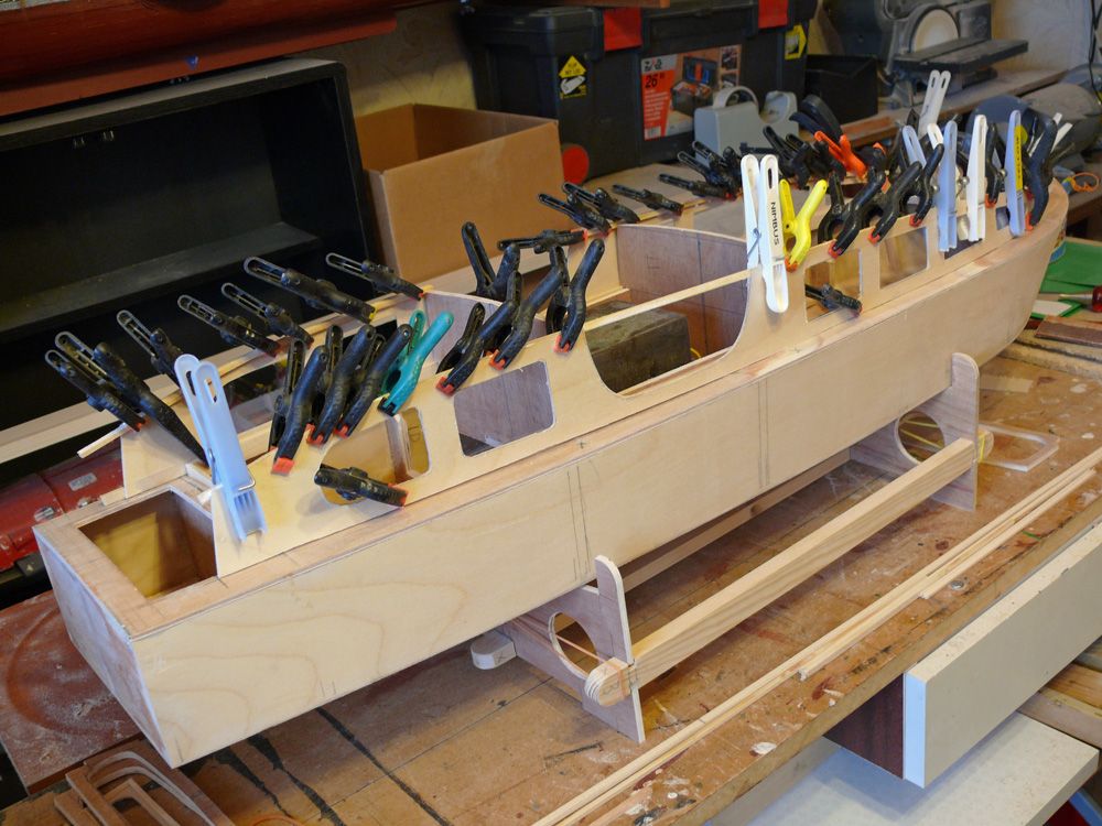

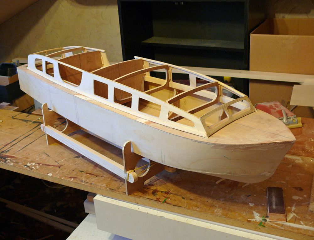

                                      #43776
                                        Hello Bob
                                        The cabin roof finishes flush with the cabin walls so you could use a thinner ply or even balsa if you wished. For a decorative effect I added a gutter strip to the cabin walls.
                                        Re: the ease of lifting off the cabin.
                                        The cabin is designed to fit snugly without being overtight this should provide an adequate level of waterproofing without having to mechanically fix the cabin to the hull.

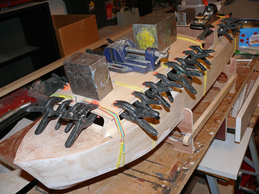

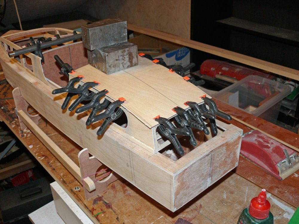

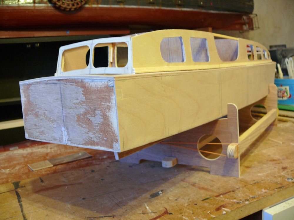

                                              Making a start on the roofing
                                              Tried 1mm ply, but this was far too thin and wouldn`t flex uniformily
                                              1.5mm is perfect for the job and flexed just right
                                              Some of the formers needed filling as can be seen in the foreground

                                                  This is what it takes to clamp the roof down!
                                                  Plywood can be funny stuff at times, due to the grain!
                                                  Only hope it hasn`t got any lumps and bumps in the morning!
